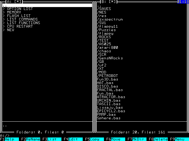

What would it mean, to get the Filemanager running on lcdpanels?
Is there an easy way to translate/get around these VGA specific tile commands?
Hello Dietmar
Unfortunately, this FileManager was not initially made flexible for different resolutions, but was adjusted to the MODE 1 resolution 640x480 and font 8x12.
I already see that it needs to be redesigned at least to work through the terminal.

  dddns said  ... What would it mean, to get the Filemanager running on lcdpanels?
Is there an easy way to translate/get around these VGA specific tile commands? ...
Hi Dietmar, first I would comment out the TILE command using an editor
(TILT -> 'TILE).
The FM will then at least be able to run. Then I would write a replacement function using graphic commands. The function should invert a selected line of text, i.e. black text on a white background instead of white text on a black background.
For example (from Javavis FM code):
Print " F3"; :Color 0,c(7):Print "List  ";:Color c(15),0
That should take you a step further.
Michael
That shouldn't do all the work. It's just a hint.

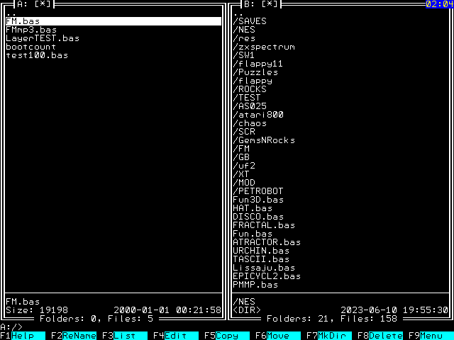

Update FM functionality v.1.6
jFM_v160.zip
Added a call to the Menu (F9) of executable commands.
You can add your frequently used commands to this list. I think you can also make a list of launched program plugins.
Added playback of .MP3 files through a separate player program called from the file manager. It will also be necessary to expand its functionality.
You also need to sort the file lists, I haven't figured out how yet, by button or by default.

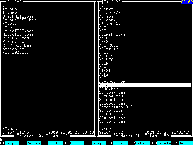

- plays mp3 files on Pico2
- displays information about the current file at the bottom of the panel (size&date)
- saves the Screenshot image by pressing the PrintScreen button
