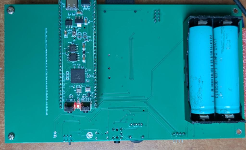

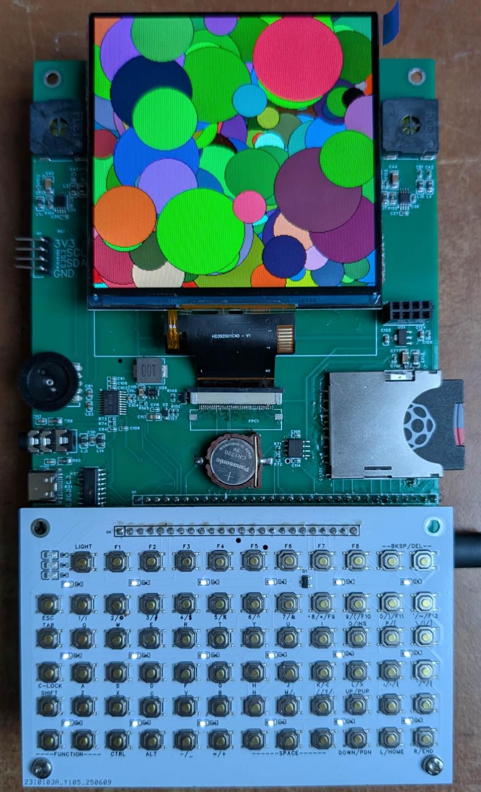

I'm enjoying playing with this and here is the first prototype. Everything works but a few changes needed.
I think I'll call it the Palm Pico.
I'm not happy with the battery charging circuit so am going to move to a design from Great Scott
The surface mount speakers I chose are complete c..p so I need to find something better.
The RTC battery will move to the bottom of the board which gives room for a CR2032.
The audio jack will be replaced with a switching one that cuts off the amp when external audio is plugged in.
Finally the board will be shortened so that the keyboard buts up to the screen giving a final size of 160x108mm
The software will be standard PICOUSB2350 which will allow the user to plug any external USB device (devices with a hub) into the 64-pin DIL board. I've partially written a new driver for the screen using the PSRAM as a full colour framebuffer and with the screen updated by the second processor. This gives a good performance improvement (GUI TEST LCDPANEL: 335 circles/second with the new driver vs 190 before).
I'm still to write the full keyboard driver but I have already modified the KEYPAD command to optionally allow any number of columns and rows AND give the user the ability to specify for each matrix position the code that is returned
KEYPAD codes%(cols, rows),vret%, interrupt, colstartpin, ncols, rowstartpin, nrows
This will be generally useful in MMBasic allowing much more flexibility in using simple keypads as input devices.
The layout of the keyboard allows a commercial overlay to be used - bit expensive but saves any custom work before everything is finished.
The screen is 320x320 and because the Pico has PSRAM any 320x240 code will work with no modification without hitting any memory limitations (PETSCII tested)
Overall spec:
RP2350B, 16MB flash, 8MB PSRAM, 320x320 4" IPS screen, SDcard, DS3231 RTC with CR2032 battery, I2S DAC based audio with line level output and volume controlled stereo amplifiers/speakers, USB host capable, serial console using CH340, External I2C port, powered by standard 18650 lipos using readily available battery holder. ESP8266 port connected to COM1 for WIFI connectivity.
AND, of course, completely open source and fully supported by stock MMBasic firmware.
Edited 2025-07-03 03:30 by matherp

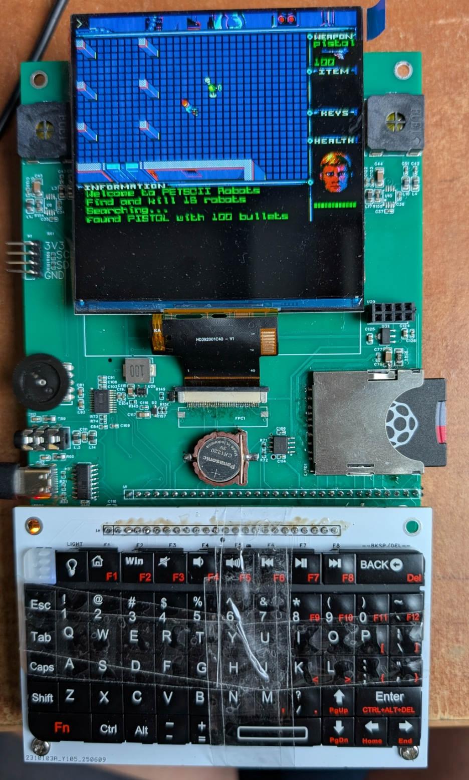

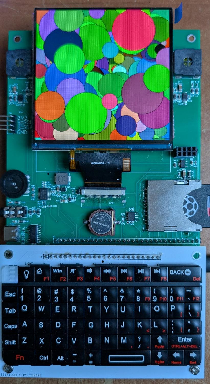

Software support is finished
The driver for the display is finished as is the driver for the keyboard. Full support for all the usual stuff, auto key repeat, caps lock etc.
The screen driver is new and uses the PSRAM as a full colour framebuffer with actual updates done on the second cpu. The interface between the two is a blocking FIFO so the physical screen can never get too far behind but the main CPU is free to pre-calculate changes without having to wait for the slow SPI channel (although I am running the SPI at 90MHZ!).
Everything is standard MMBasic with the device configured simply using
OPTION RESET PALM PICO
Note the sophisticated way the keyboard overlay is attached.
Now I need to concentrate on getting the motherboard design right (shrunk) and then I can start designing a box.
