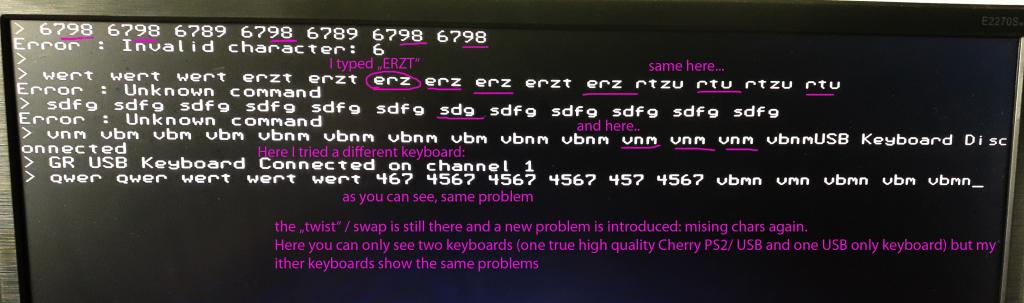

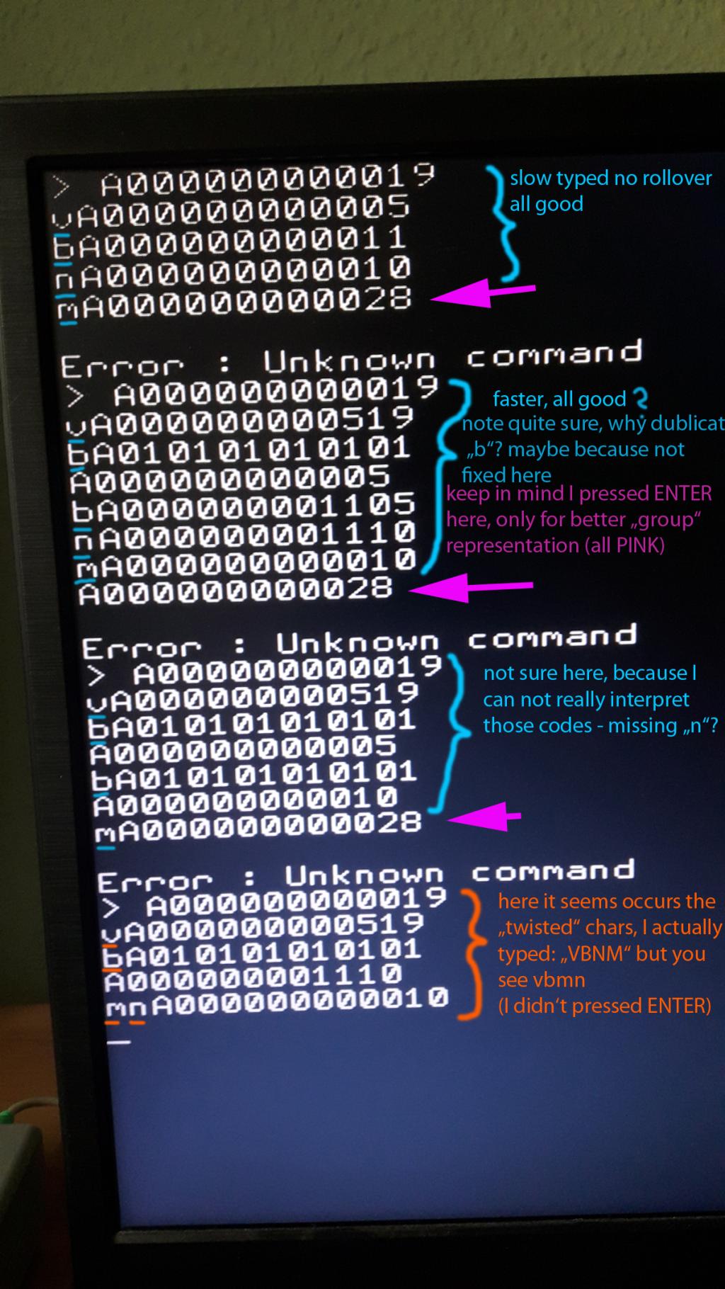

I'm determined to get to the bottom of this. Please could you run the attached version which has some diagnostic code in it.
Please load the software and then using a computer console type
OPTION CONSOLE SERIAL
This disables the screen as a console device
Then using the USB keyboard type the sequence that gives the duplicated characters until you see a sequence which includes a duplicate
In the computer console you will see the characters you typed. On the VGA screen you will see some hex codes which are the report sent by the keyboard.
On my USB keyboard, I only ever see duplication of the "H" character and when it is duplicated I get the nonsense code A010101010101 on the screen and it is this which causes the duplication.
Google does not suggest this is a generic error code but it is definitely the keyboard that is generating it.
If your keyboards are doing the same or something similar I can then finally fix the problem. I've disabled the duplicated key timer as this is just masking the problem rather than fixing it.
Thanks for your help
Peter
For reference these are the codes that the keys on a German keyboard should produce.
When typing slowly you will see the code as the right most pair of hex digits. If you press two keys simultaneously you will see both codes in the 4 right digits.

  matherp said  Amnesie
(...) Please could you run the attached version which has some diagnostic code in it.
Hi Peter, of course I'll do my best to help!
But there is no attached file. Do you forgot to attach it?

Amnesie
Hi Peter,
I am not sure how helpful this is, since my FTDA converter doesn't work with this diagnostic firmware (or I am just too stupid - also possible    )
But here are two things to keep in mind:
1. this firmware is before the dublicate fix
2. I am not quite sure how to interpret the codes.. some have the real typed letter, some not, but I think I found one sequence which have the twisted chars:
EDIT:
maybe it is important: the "mn" (as in orange in the picture) is always in one line like this, so this is reproducible. Also worth to mention: only one keyboard has this spot, other keyboards have others.
-Daniel
Edited 2025-07-07 03:31 by Amnesie
Posted: 05:32pm
06 Jul 2025
Thanks - looks like the swap occurs when the report after the error contains two new characters - that gives me something to look at. It will be tomorrow before I post more.
Edited 2025-07-07 03:32 by matherp

  matherp said  Here is a new update - tests OK for me but....
Hi Peter,
I tested all my keyboards and now there is a new problem, see please the image (I changed the keyboard one time, to see if it is still there in the photo, after that I tested all other keyboards)
Greetings
Daniel
