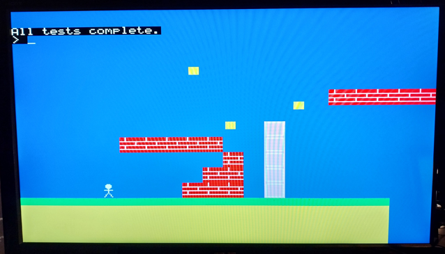

V6.02.01RC3
PicoMiteV6.02.01RC3.zip
All versions: Major rework of PLAY TONE and PLAY SOUND to reduce the overhead in the interrupt routine. Shouldn't make any difference to the user but.....
RP2350 only:
mm.info(psram size) - returns the amount of PSRAM in the system - static value
TILEMAP command and function implemented
TILEMAP_User_Manual.pdf
Test program - press any key between tests. In tests 17 and 18 move the man with the arrow keys. Should work on HDMI and VGA versions. Will need a framebuffer setting up and framebuffer copy to work on PicoMite (untested)
NB: the design test/goal for this code was "you could write a complete implementation of PacMan using this", not that I have done it though

' TEST 1: Generate tileset BMP
PRINT "Test 1: Generating tileset BMP..."
GenerateTileset
PRINT "  PASS: tileset.bmp created"
' TEST 2: Load tileset into flash
PRINT "Test 2: Loading tileset into flash..."
FLASH LOAD IMAGE 1, "tileset.bmp",O
PRINT "  PASS: Flash slot 1 loaded"

' TEST 11: TILEMAP DRAW (visual)
PRINT "Test 11: Drawing tilemap at origin..."
FRAMEBUFFER CREATE
FRAMEBUFFER WRITE F
CLS C_COBALT
TILEMAP DRAW 1, F, 0, 0, 0, 0, SCREEN_W, SCREEN_H
FRAMEBUFFER COPY F, N
DO: LOOP UNTIL INKEY$<>""
PRINT "  PASS: Tilemap rendered (check display)"

TILEMAP SPRITE CREATE 2, 1, T_ENEMY, 40, 40
TILEMAP SPRITE CREATE 3, 1, T_ENEMY, 200, 60
TILEMAP SPRITE CREATE 4, 1, T_ENEMY, 120, 100
' Query functions
PRINT "  Sprite 1 X="; TILEMAP(SPRITE X 1); " Y="; TILEMAP(SPRITE Y 1)
PRINT "  Sprite 1 tile="; TILEMAP(SPRITE TILE 1)
PRINT "  Sprite 1 W="; TILEMAP(SPRITE W 1); " H="; TILEMAP(SPRITE H 1)
' Enemy movement directions
DIM dx(4), dy(4), anim_frame
dx(2) = 1 : dy(2) = 1
dx(3) = -1 : dy(3) = 1
dx(4) = 1 : dy(4) = -1
anim_frame = 0
TILEMAP VIEW 1, 0, 0
DIM hx, hy, ex, ey
hx = TILEMAP(SPRITE X 1)
hy = TILEMAP(SPRITE Y 1)
DO
 FRAMEBUFFER WRITE F
 CLS C_COBALT
 ' Draw the base tilemap
 ' Draw all sprites on top with transparency (colour 0 = black)
 TILEMAP SPRITE DRAW F, 0
 k$ = INKEY$
 IF k$ = CHR$(128) AND hy > 0 THEN
   IF TILEMAP(COLLISION 1, hx, hy - 2, TILE_W, TILE_H, A_SOLID) = 0 THEN hy = hy - 2
 END IF
 IF k$ = CHR$(129) AND hy < SCREEN_H - TILE_H THEN
   IF TILEMAP(COLLISION 1, hx, hy + 2, TILE_W, TILE_H, A_SOLID) = 0 THEN hy = hy + 2
 END IF
 IF k$ = CHR$(130) AND hx > 0 THEN
   IF TILEMAP(COLLISION 1, hx - 2, hy, TILE_W, TILE_H, A_SOLID) = 0 THEN hx = hx - 2
 END IF
 IF k$ = CHR$(131) AND hx < SCREEN_W - TILE_W THEN
   IF TILEMAP(COLLISION 1, hx + 2, hy, TILE_W, TILE_H, A_SOLID) = 0 THEN hx = hx + 2
 END IF
 TILEMAP SPRITE MOVE 1, hx, hy
 ' Bounce enemies off screen edges
 FOR i = 2 TO 4
   ex = TILEMAP(SPRITE X i) + dx(i)
   ey = TILEMAP(SPRITE Y i) + dy(i)
   IF ex <= 0 OR ex >= SCREEN_W - TILE_W THEN dx(i) = -dx(i) : ex = ex + dx(i) * 2
   IF ey <= 0 OR ey >= SCREEN_H - TILE_H THEN dy(i) = -dy(i) : ey = ey + dy(i) * 2
   TILEMAP SPRITE MOVE i, ex, ey
   ' Check collision with hero
   IF TILEMAP(SPRITE HIT 1, i) THEN
     PRINT "  HIT: Sprite 1 collided with sprite "; i
   END IF
 NEXT i
 ' Animate enemies: toggle tile between coin(4) and brick(2) every 30 frames
 anim_frame = anim_frame + 1
 IF anim_frame MOD 30 = 0 THEN
   FOR i = 2 TO 4
     IF TILEMAP(SPRITE TILE i) = T_ENEMY THEN
       TILEMAP SPRITE SET i, T_COIN
     ELSE
       TILEMAP SPRITE SET i, T_ENEMY
     END IF
   NEXT i
 END IF
LOOP UNTIL UCASE$(k$) = "Q"
TILEMAP SPRITE DESTROY 1
TILEMAP SPRITE DESTROY 2
TILEMAP SPRITE DESTROY 3
TILEMAP SPRITE DESTROY 4
PRINT "  PASS: Sprite demo complete"
' Cleanup
TILEMAP CLOSE
FRAMEBUFFER CLOSE
PRINT
PRINT "All tests complete."
END
' SUBROUTINES

Posted: 03:12am
10 Mar 2026
Peter63
Tested the TILEMAP Test Program:
> option list
PicoMiteHDMI MMBasic USB RP2350A Edition V6.02.01RC3
OPTION SYSTEM I2C GP10,GP11
OPTION FLASH SIZE 4194304
OPTION COLOURCODE ON
OPTION MOUSE SENSITIVITY     1.0000
OPTION KEYBOARD US
OPTION RESOLUTION 640x480 @ 252000KHz
OPTION SDCARD GP5, GP6, GP4, GP3
OPTION RTC AUTO ENABLE
/Peter63
