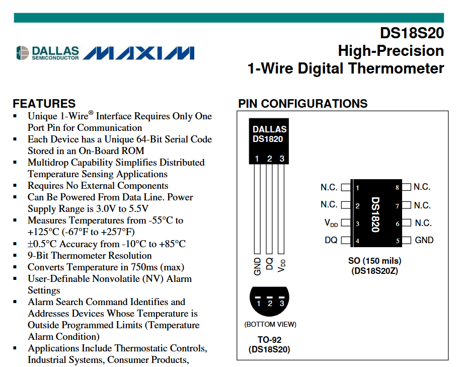

Posted: 10:55pm
29 May 2026
Thanks for the extra testing. It filled all the gaps in the T3 data which I now see goes from 16 to 1 with increasing temperature.
And that makes quite a difference. The equation in the datasheet does not appear to be correct.
The data you have given me should be enough to simulate a DS18S20 properly and find the correct equation. More to follow.
Edit.
This gives the most sensible results:-
DS18S20t = Str2bin(int16,Chr$(T1)+Chr$(T2))\2 + (16 - T3)/16 -0.9375
'or
Value = Str2bin(int16,Chr$(T1)+Chr$(T2))\2 + (16-T3)/16 -0.9375
And also appears to work below zero.

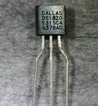

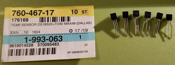

Posted: 01:44am
30 May 2026
Peter63
photo of the DS18S20 marking used during test

The COUNT PER °C scratchpad is supposed be always 16 with the DS18S20 but Peter has a DS1820 according to the photo.
Are you sure that COUNT PER °C is always 16 with the DS1820?
I don't have either chip to test with.
Posted: 03:34am
30 May 2026
Peter63
A little test again then with cooling spray, seems to be working fine now.

Jim, you are right, as you were writing that I was reading the Dallas DS1820 datasheet and COUNT PER °C varies according to an internal calibration table.
I will incorporate that and ask Peter63 to test again.
The saga continues...
Peter, those results do look more promising.
Edited 2026-05-30 13:40 by phil99
Posted: 03:38am
30 May 2026
Peter63
I thought I had a DS18S20, according to my saved label, but now it doesn't seem to be so.
Happy to test further...
Edited 2026-05-30 14:01 by Peter63

Could it be DS18S20 that I have, but maybe they are mislabeled?

Thanks to Googles AI,I found another datasheet that suggests that the DS18S20 uses the same die as the DS1820 so has the same markings "DS1820"
That's bloody helpful!
I never trust the BS that Googles AI spits out but it might be right this time.

Feels like it would be so Dallas Maxim, the variant is also TO-92 which I have.
/Peter63
