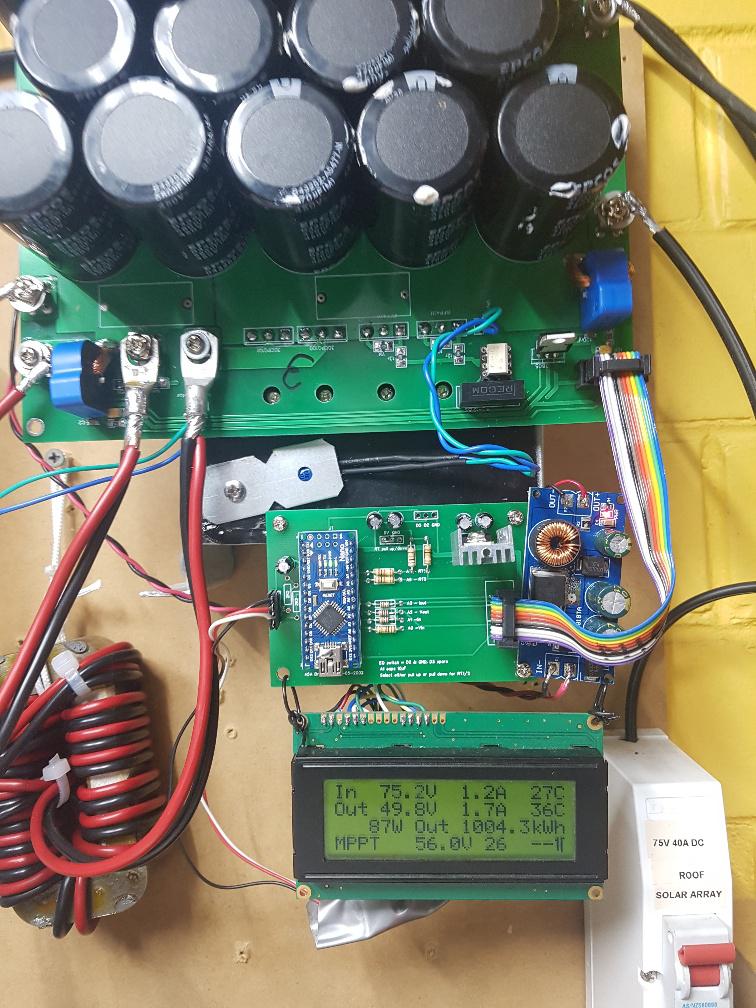

poida
1 MW.hr
It just keeps on keeping on.
Posted: 06:54am
11 Mar 2021

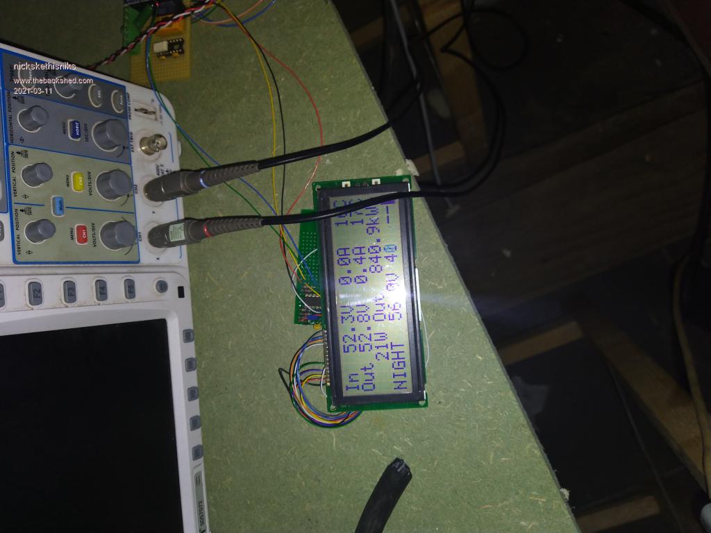

nickskethisniks
Getting close to you Poida.
A bit cheating with 26 panels connected to this unit.
Posted: 08:02am
11 Mar 2021
poida
Nicks:
no problem with the so called cheating. None at all.
I have 2 separate 3kW panel arrays. One is connected to the mppt.
The other is connected to a commercial controller.
I have the commercial controller handle the accurate constant voltage
charge, with it's temperature sensor that can modify battery charge voltage limits
that change due to temperature.
The mppt (shown above) is set to do all it can up to about 1 Volt less than
the commercial unit.
This means the mppt does a fraction of the day's total charge, the commercial
unit doing the bulk of it once the battery gets up to >55V.
When I get around to it (like, what is a "roundtoit" anyway. Can I buy one?)
I will retire the commercial controller, sell it for what I can get
and then run two self built mppt controllers.
Then I will get some good sized solar energy totals.
I hope to see your system go far past mine in the next months when your Summer
brings the light and for good long periods each day.

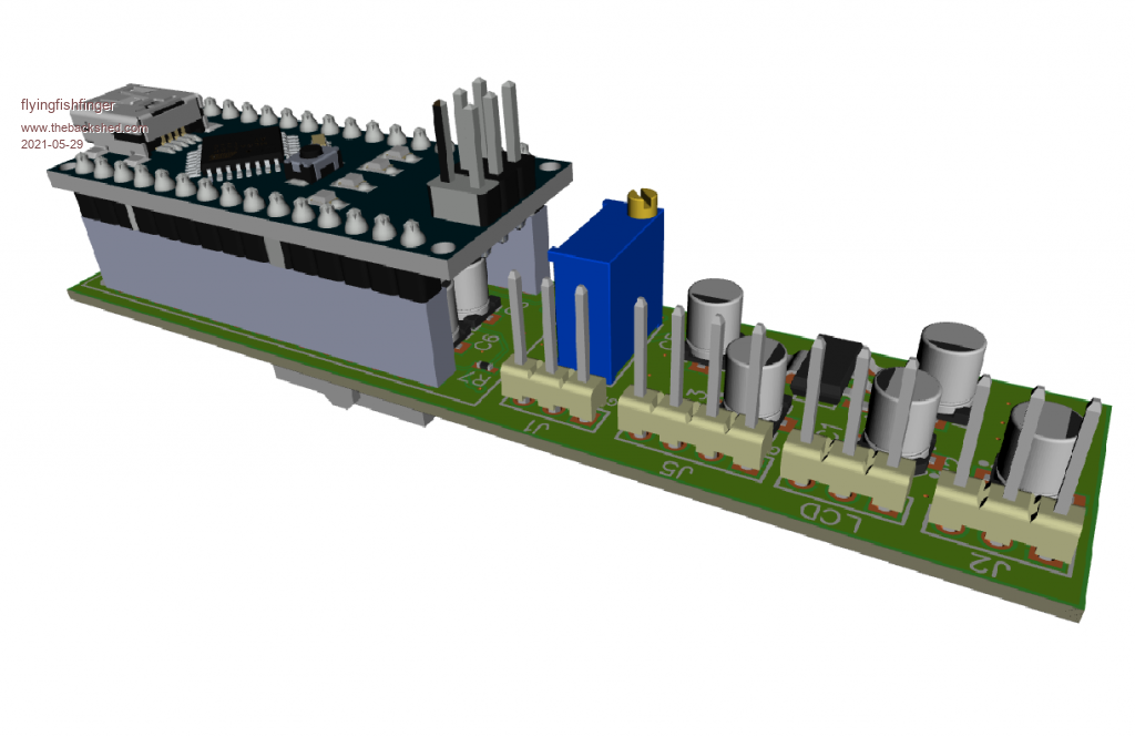

flyingfishfinger
I'm making my own version of the Brainboard based on yours, Peter.
I want to eliminate as many wires & pieces as possible, so I'm designing it as a "module" that mounts directly onto the Powerboard's 10-pin header. Something like this:
Couple questions though:
- The trimpot seems to connect to D7, but as far as I can tell this is NOT an analog input. What's the logic?
- The header that says "5V / out / GND" on D6 is for the LCD, right?
- What are the A5/A4 pins for?
R
Edited 2021-05-29 07:29 by flyingfishfinger
Posted: 10:34pm
28 May 2021
poida
Rafael, the trimpot gives a voltage for the nano's comparator.
It was thought important to have some "hardware" over current protection.
It worked sometimes when I tested it on the bench. Because it did not work
sometimes also, I thought "right you dummy, don't short the output and it will all be OK" and not use this.
The comparator uses D7 and D6 and when one exceeds the other, a status bit is set.
I check this during the start of each PWM interrupt, which runs at 20kHz,
and disable the PWM if set.
The header provides a 0 - 5V signal from a current sensor placed in series with the inductor. I use closed loop hall effect type sensors like the LEM types and these have 3 or 4 pins, 5v, ground, signal, and sometimes a reference.
If I was building a mppt now, I would dispense with these two and accept if I
short the output when it's running, I will need to replace the two FETs.
I like very much what you have done with this. You can now make it even smaller.
Keep in mind the 12V supply, taken from the battery. For my builds I need
a 60V to 12V converter.
I wonder if you might want to include provision for a bit of support
on the far end, to stop the board tilting in the IDC socket?
D3 is used to trigger an equalisation charge program.
D2 is used when you want to control the mppt output via an external
controller. RenewableMark has a large solar array and wants to limit charge current
from the 2 arrays and 2 charge controllers. If they are both running independently
then they both could make 45A, total of 90A. But if he has a controller that can pull down D2 on both mppt when current exceeds 70A then he has the protection needed.
mppt and inverters are exceedingly EMI noisy. I find the I2C system on the nano is
susceptible to this and the nano can lock up - it stops running the code.
If you want to use I2C for the LCD I would look at what can be done to shield
the A4 and A5 pins from EMI.
I instead connect the brainboard to a LCD with yet another nano that reads serial data via a digital pin. I think this is far more robust with the EMI.

This is very much a work in progress, just an idea. It wedges right between the choke return point and the 12V-12V block. I was thinking of running the choke return UNDER this board since it's tall enough.
There will definitely be a support / standoff on the far end, and I'm still thinking about how to solve the 12V sourcing problem.
It should be simple to implement the hardware overcurrent with an actual comparator chip separately from the Nano (which just cuts off the PWM), this is a good idea and I might add it.
So you're saying the A4 & A5 pins are the I2C output that turned out to be too noisy, or did you use one of them to generate the serial signal without any library in the end? I haven't looked at the latest code yet.
Totally separate question - does the MPPT finding algorithm start from a short once a minute, or the last known PPT? If I'm going to use this for a hydro generator, I can't short the wheel once a minute...
Cheers,
R

flyingfishfinger
  tinyt said
  nickskethisniks said  ......
@flyingfishfinger
You might consider to use an atmega328 chip directly soldered on your PCB, ditching the nano completely for the smallest footprint. Just bringing out an ISP connection for programming, we don't need al the nano pins. Just using a nano to program it.
I think the nano program has to have a system clock of 16 MHz, so a 16MHz crystal/caps or oscillator chip has to be added.
Yes, you're both right. I did this long while back for other projects (actually, designed my own "knockoff" Arduino with some extra features), but it's kind of overkill here. ISP programming is a bit annoying even if using another Nano, plus it's just easier to plug in via USB and socket the entire Nano.
Also, I designed this with SMT parts that JLCPCB specifically has available, I intend to get them to assemble a few directly.
  poida said
But when configured for I2C EMI can upset the device.
This looks relatively easy to solve. I suspect it's because there aren't any 0.1uF decoupling capacitors on this board, they're good for filtering higher frequencies on power lines. The big 10uF's currently present on the analog I/O are good for smoothing  but not so much for high frequency noise. I will add some in my board  and hope I can get I2C working.
For the overcurrent feature - you used a 3rd current sensor on the inductor leads for a "hardware" kill switch? Why couldn't the output current one be shared? How is "overcurrent" determined for the MPPT (cross-post above notwithstanding)?
Regarding the 12V supply, after some thought I feel like it's best to keep the VBat->12V conversion offboard with the aforementioned modules, unless the Powerboard gets redesigned to accommodate it. It's not very practical to put it on the Brainboard.
This way we can also size it as needed; in my case I'll also want 12V to drive various other things that aren't on these boards.
Cheers,
R
