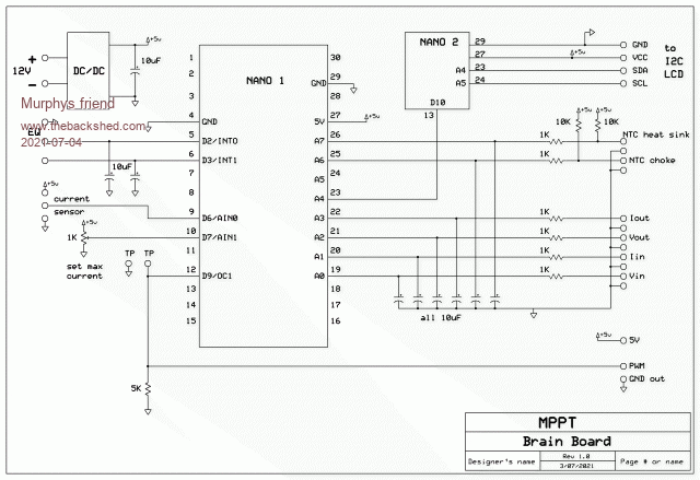

I'm looking for another project and this one looks a good candidate. Doing PCB artwork is something I actually enjoy so the boards will be my own design.
No doubt there might be more questions as I proceed, especially when it gets to programming that Nano, but for now those schematics and the 36 pages of info in this thread should keep me occupied for a while.

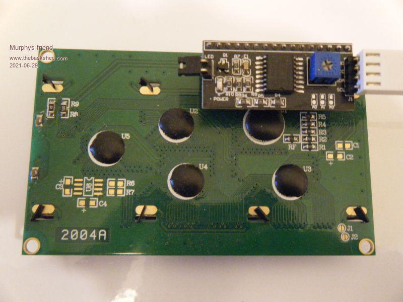

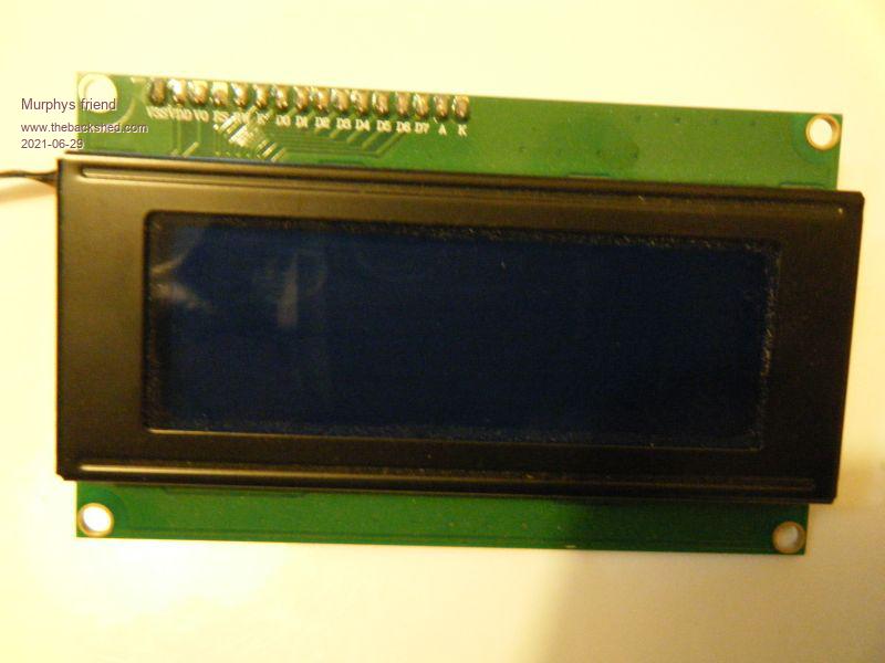

It looks as if I have a question already , I found this display panel;
It looks as if  it has that required serial port on the little piggy back PCB, would this be suitable for the home brew MPPT project?

It has the I2C port. 4 wires, 5V, GND, clock and data.
It is easy to connect this LCD to yet another nano, program it and then connect the nano to both the LCD and the mppt.
Why go this way with extra nano?
I find the I2C bus to be very sensitive to EMI and this can upset the
smooth running of the mppt firmware.
I have tried using I2C direct from LCD such as yours to the mppt.
The EMI from the choke is quite intense and it stuffs things up.
This was the case with the last mppt I built, with it all inside the
Festo jigsaw metal carry case. Your build might be OK with I2C. Who knows.
I sorted it out permanently with the nano/LCD communicating with the mppt
with the 3 wires going through a mains clip-on choke 2 turns.
The 3 wires are 5V, ground and data (for serial data, 9600 baud, 8 bits, 1 stop bit
no parity)
Earlier in this long thread I posted the LCD nano code.
There are two versions, depending on what LCD you have got.
Some people have LCDs without the little I2C board attached and
so we communicate directly with the LCD controller chip.
Others have the LCD as you have, with the I2C module.
So there are two different programs for the nano/LCD assembly.
I go to all this trouble to end up with 3 wires connecting the mppt and the LCD.
The wire lengths are quite long, maybe 8 inches or more.
I want to have the wire leading into the mppt nano going to a more
EMI resistant pin, to be setup as a digital output pin.
This means the EMI has to pass back through the pin's output stage and then into the
microcontroller chip's guts. And this is a lot harder for the weak current
of the EMI.

Thanks poida. I'm good at building things but when it comes to program a nano or LCD (didn't know they need to be programmed too ) I'm completely lost and seek your experience.
So, if I make a brainboard, fit it into a shielded case with the LCD board in a window. Include a 12V to 5V Dc/Dc supply, this case then needs 12V input terminals and shielded wires to sample Vin, Iin, Vout, Iout and NTC plus terminals for the PWM drive and it should work?
The power board will be separate close by and I have a choke (ex aero) with 23 turns of 15mmsq wire, 380uH and sat at 1500A/t.

I like building electronic things but when they require a nano to  program in order to work, that is a major hurdle for me.
What I would like to do is to lay out a MPPT brainboard PCB with the same footprint than my LC Display panel so they can be piggy backed on spacers.
I need to know if the extra nano poida mentioned to 'program' my above shown display panel is a permanent or temporary affair. So, one or two nano's for this project?
If I can get the PCB's and all required connections sorted out first I can find somebody to do the programming bit for me if this proves to be to big a challenge.
Oh I'm trying to fit this into a commercially available case, that's why I use my own PCB's.

Murph, it's a piece of piss.
get a nano, program it with this
nano_serial_to_i2c_LCD.ino.zip
connect it to the I2C LCD you have. 4 wires, 5V, GND, CLK and DATA
The Nano I2C clock is pin A5, data is pin A4.
after programming, when it reboots you get a message
"yada, yada, 9600 baud etc.."
good.
find 5V pin on that Nano, run a wire from it.
Find GND, run a wire from it
Find D10, run a wire from it, this is serial data IN for this Nano.
So there are 3 wires.
These 3 are hooked up to 3 of the pins of the 4 pin connector of the brainboard.
But you will make your own PCB. Great!
The mppt firmware outputs serial data via pin A4.
Only 3 wires. connect A4 of the brainboard equivalent (you will be designing)
to pin D10 on the Nano that is hooked up to the i2C LCD.
And 5V and GND.

Murphy's friend
Poida, I took the liberty to re draw your schematic to include what you wrote in the post above.
Can you please have a quick look to see if I got it right or missed something? Thanks.
Note, There is no 10 pin connector, I don't like the ribbon cable idea. I made provision for shielded cable for the V & I in/out signals. I'm also using a small (3W) isolated on board DC/DC to get the 5V from a battery voltage to 12V DC/DC elsewhere.
Posted: 08:13am
04 Jul 2021
poida
it looks about right.
I would drop the current sensor (pin D6, D7) since I have little faith
it will work.
I do like how you have made a clear separation of the I2C and the Nano1 that drives the PWM.
The existing latest code will work with this too.
Make sure the 5V supply can drive the LCD and Nano2.
I would allow 100mA for that.
Posted: 08:31am
04 Jul 2021
Murphy's friend
Thanks Poida, that was a quick reply .
I will drop D6 & D7, the less parts the more room for others on that PCB .
That 5v DC/DC can do 600mA, should be enough  for all the 5V requirement. Its a RECOM R13 Series isolated converter I get from RS components. Nice and small too.

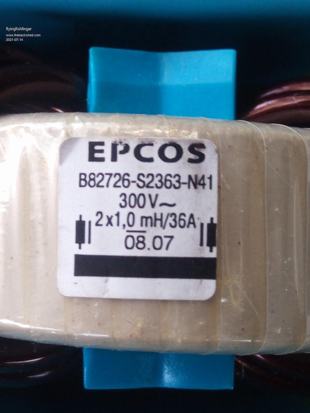

I got a busted Sunnyboy! It has 3 of these chokes in it, along with all the caps I'll need:
If I put all three (so 6x coils) in parallel, I get 166uH.
I'm not sure if the current rating applies to each coil or the whole part but either way that would make 108A or 324A current capability.
Sounds to me like this would work as a choke, right? I'll build it up later and try as well.
R
Posted: 04:43am
14 Jul 2021
nickskethisniks
I don't think it would work,, those chokes you have are common mode chokes.
They are used to filter high frequency noise. Not suitable for energy storage.
Posted: 06:02am
14 Jul 2021
poida
I think one or more of those chokes will be useful.
Maybe do some saturation tests?
The choke's requirements:
my design running conditions are
100V in
50V out
20kHz PWM
45 Amp max output current.
100V down to 50V conversion means a 50% PWM width.
At 20kHz, this means the pulse width is 50% of 50uS
or 25uS
Delta V is 100 - 50 Volts and that is what the inductor is exposed to
for that 25uS.
inductor equation
V = L x dI/dT
re-arranging for L we get
L = V x dT / dI
dI = 15 Amps ripple, say
V = 50V
dT = 25uS
L = 50 x 25E-6 / 15 = 83 uH
In practice, I found something like
100uH to be good, which means about 15Amp ripple going into the output
capacitors.
More Henries means less ripple. It's a linear relationship.
Ensure the choke does not saturate too much at your required output
current. Some saturation, e.g. a 1/2 of inductance during the last 20%
of the pulse width is minor.
(that is, you will see the current increase 2x faster when measured and shown
on the DSO at the end of the pulse)
The effective inductance is the straight line of the current
through the inductor for the whole width of the pulse,
going from zero current to the end of pulse current.
A time averaged measure of the inductance over 50uS, for the 20kHz pulse
I found it very instructive to test the inductor in circuit, observing
the current through the inductor alongside the voltage at the switch node.
You will see the DC current and on top of that, the ripple current
at various operating conditions.
