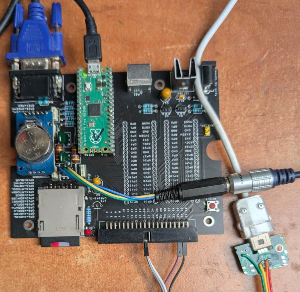

@Peter,
I can also duplicate it on the VGA design 2. Connecting the WII classic to GP14/GP15, with the RTC placed and using V6.00.02RC21.
It only takes more time. In all cases, the screen is filled with dots (the code prints these), and the final character before the crash is always en "E", not a dot.
Please let the code run for 20 minutes, and check for silence (sound stopped) and an "E" on screen.

I've been testing this to destruction and I'm beginning to believe it is a bug in the Pico SDK I2C routines.
When you finally get a readable error message it says that a function isn't found which is clearly part of the source.
Neither the system stack not the user heap are showing any issues.
The next step is to try recoding the I2C routines using the bitbang versions and see what happens.......

I've tried with different mod files and also replicated on RP2350 VGA AND RP2350 HDMI
That eliminates USB and VGA interrupts. I've also replicated with I2S audio. I've also removed the modsample. I haven't yet tried with playing WAV, FLAC or MP3.

Posted: 05:10pm
05 May 2025
DEVICE(WII B) does nothing other than read a preset memory area - the interrogation of the Wii takes place in the background every 20mSec. In which case it should crash without that as well - please try.
This is why I'm suspecting the underlying I2C sdk code.

V6.00.02RC22 is available on
Fixes a bug in scrolling in the editor when loading a file which creates continuation lines.
Adds a check in the editor which won't let you save and exit if continuation characters create a line longer than 255 characters.
Makes changes to handling Wii Classic and Wii Nunchuck to try and circumvent what appears to be an sdk issue where I2C commands return before completing.
Github updated
