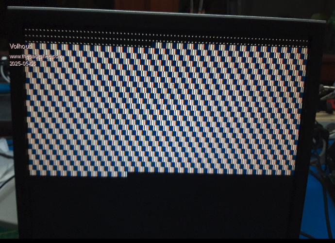

@Peter,
RC22 on genuine RP2040 VGA design 2 with WII Classic connected to GP14/GP15.
Just opening the WII classic, and then printing 1 dot on the screen every 100ms.
In this picture the pico is dead and needs power cycling to revive.
It is not fixed. Sorry.

  Quote  It is not fixed. Sorry.
I've just run for 3 hours without issue so I'm happy it is now OK and then anything else is probably electrical. I don't intend to look at if further.
Edited 2025-05-06 07:31 by matherp
