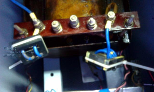

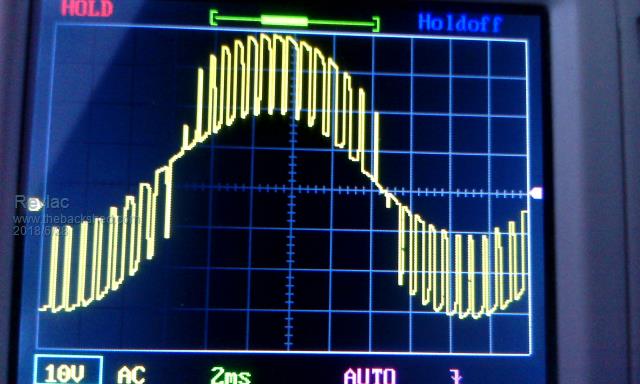

Just thought I would try a small choke (2 turns)on the L primary (VS1) and see what happens, I think it come from an old computer PSU.
Just seems to make the other choke on VS2 a little more quiet and the idle current is a little better, power consumption is also a bit better on small loads.

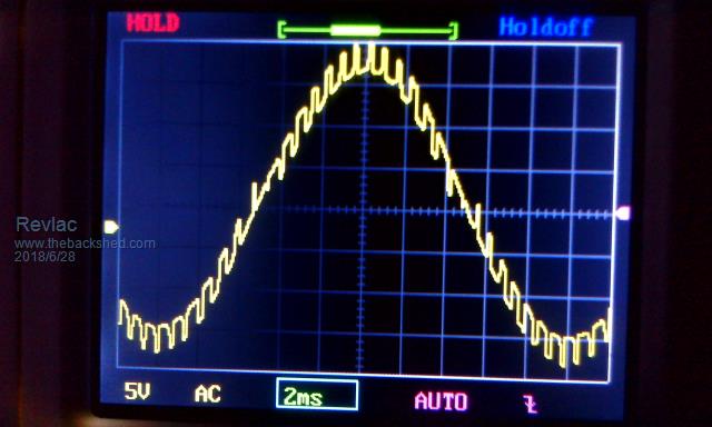

Now I have never put the LCD scope on the primary before, and I see this.
Then tried the secondary output on the transformer and its better but still Rough.
I expect that this is the result of the High Frequency that is not filtered enough by the choke on the primary?? not sure... Perhaps this is the way the LCD oscilloscope reads it?

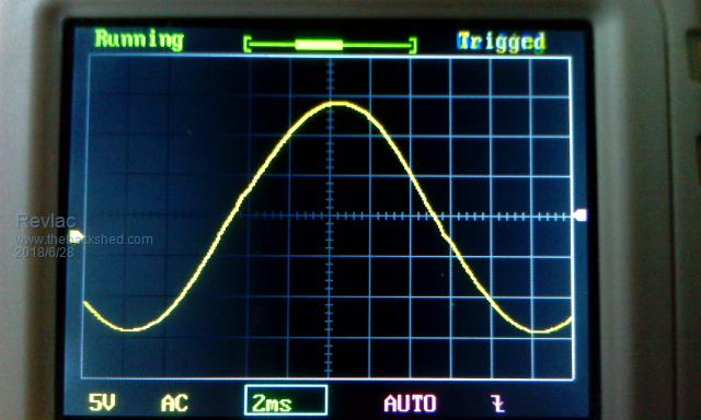

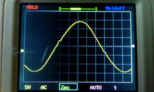

The 230VAC sine wave after the filter and 4UF filter Cap is looking good no blip.
I notice a bit of a blip start to form when a load of about 80w is applied.

Have been reading about these chokes for a bit, I'm still running with a 4uf cap ATM, So I had an idea to try and see what is going on at the choke.
I put 1 turn of small wire around the core of the EE choke on the primary and took a voltage reading of .28v fine, then give the inverter a 70w load, the voltage on the wire wound around the choke increased to .38v Not really a surprise.
I then tried the same thing with the small choke on the other primary leg, it started at .39v then with the same load applied the the voltage then dropped to .27v per turn????
I thought that was interesting as I didn't expect the voltage to drop on that one.

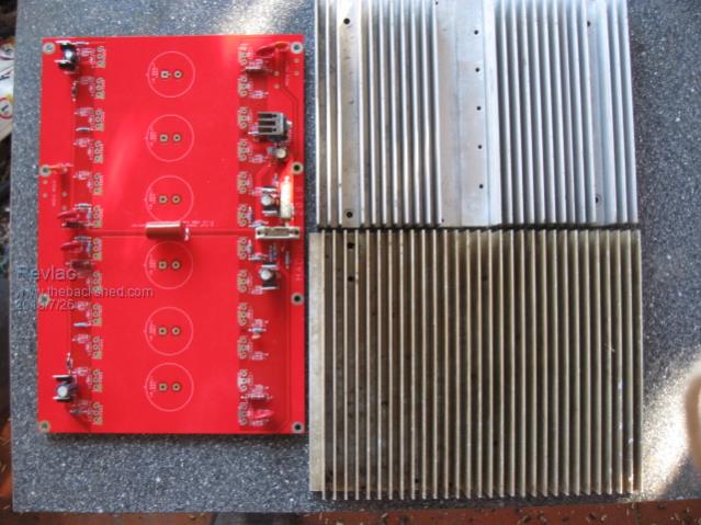

After much searching around my junk I managed to find some heat sinks that are of descent size.
They were hiding at the bottom of the aluminum scrap bin, Why they were there?????
They are a little longer than the board but not an issue I see in other builds, Will cut them in half soon and drill/tap for the screws.
Just wondering about the depth through the PCB that the fets should sit.
Leave the legs long or push them down deep into the PCB?
Preference would be about half way.
Cheers Aaron

Push the FETs all the way home but don't solder them until you have them screwed to the heatsink. If not they won't sit perfectly flat and make good contact with the heatsink. You need to make sure the high side heatsink does not make electrical contact with the top of the PCB. It may even pay to grind a chamfer on the bottom corner near the MOSFET solder joints to prevent shorts there also.
You can over hang the heatsinks but I have found keeping the heatsinks cool is not a problem. Cooling the Toroid needs the fans a lot more.

I could put a spacer between the base of the heat sink and the PCB when I start the assembly, that should lift it a little.
Also it looks like I will have to join the 2 positive heat sinks together, perhaps with a copper busbar or just run 2 positive leads, see how it goes anyway.

You could use a piece of say 3MM Aluminium plate 50mm or so wide to join the 2 halves by screws tapped into the heatsink. I run 2 cables to the positive heat sink, one to the middle of each half even though it is a single piece heatsink.
