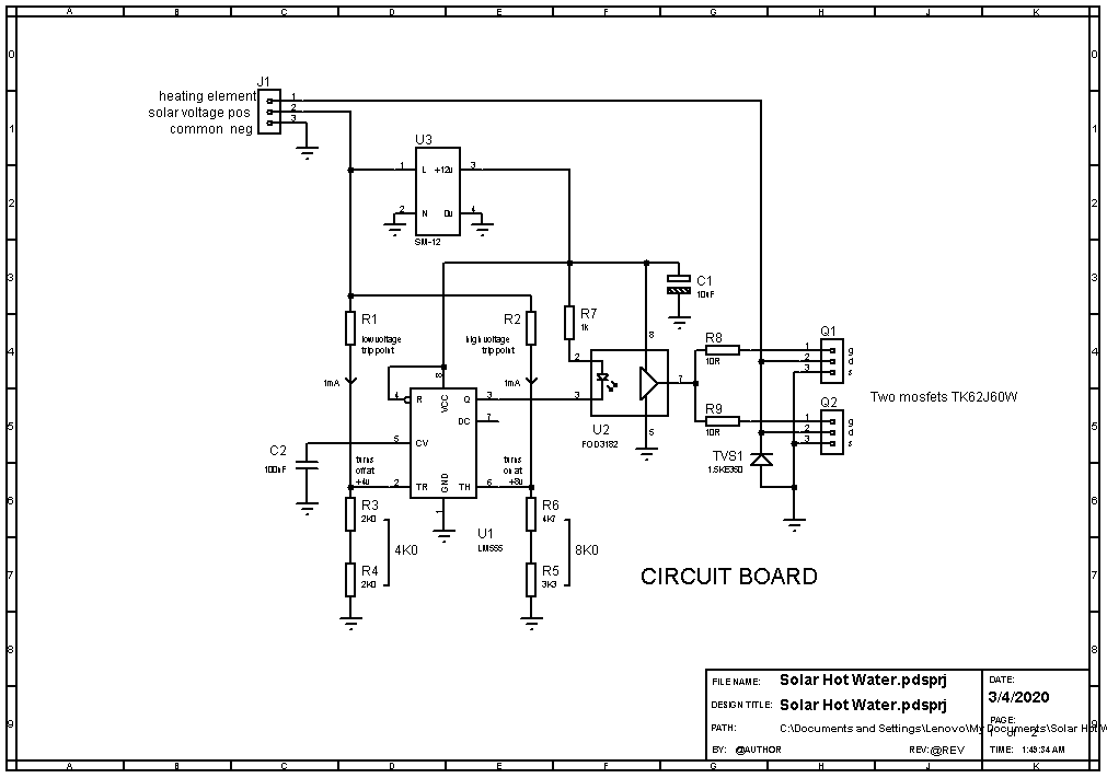

Dave,
I plan to order a big bunch of boards (for five different projects) from China in about a weeks time, it appears most of the Chinese are now back at work.
I will include a minimum order of five "Solar Hot Water" boards with that. With combined postage, the extra cost will be minimal.
It will be the exact same circuit as shown at the beginning of this thread, and it will drive two parallel mosfets at any speed.

Dave,
That generic mosfet circuit was to provide a higher current than the PCB relay could provide, but if you are switching 10-100 HZ or higher rate then the relay has to go, it wont last long.
I would take up Warp's offer, it will be a better engineered solution than messing around attempting to Hodge bodge (is that the term) off the shelf modules.

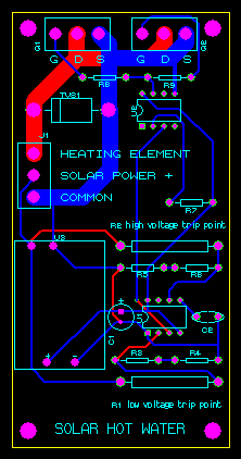

I only completed the circuit board layout for this yesterday.
But now have Gerbers that I can send out for free if anyone wishes to e-mail me.
Has to be e-mail, I cannot attach anything to a PM.

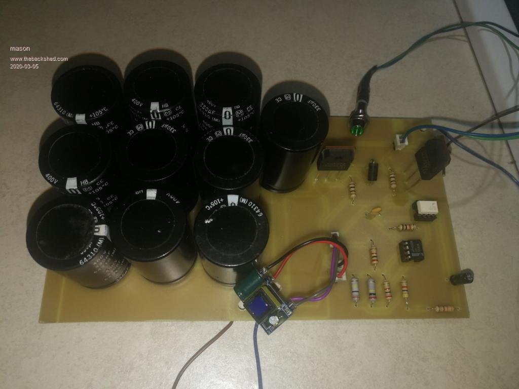

Something I was thinking of with this setup of switching the caps in and out with the thermostat on the water heater....
Given that it will be a charge/ Discharge cycle and in effect have a zero point when the caps have dropped their power into the element, will it be possible to use the standard  Thermostat  or will there still be too much potential arcing and the thermostat would need to drive an SSR to cut the input power to the circuit?
I'm thinking that at full speed, the pulses should be at or greater than mains frequency and even in lower light levels, the charge time on the caps will be slower but the discharge time should not be any different and quite rapid rather than a prolonged event that causes the damage to contacts. It's only the power levels that will take longer to come up, nothing changes on the load side so the discharge should be far faster than 1/50th of a second same as mains zero point would be.... If I am saying that right.
I played around with switching DC before with DPDT relays. I found that the DC power had something akin to Momentum. Once going it didn't want to stop which is what causes the arcing.  I found that by using a DPDT relay with 50% or better ( Can do less but 50% seemed reliable) alternative load to divert the power to, the relay switched with no more arcing than one would expect carrying an AC load.
I also found with the power I was using which off the top of my head was about 1.5 KW, That dead shorting the second set of contacts quenched the arc as well.
With shorting the panels, as this whole exercise is about, the power levels from the panels drop dramatically so the load on the relay is reduced anyway.
Everything in the system being the cable and relays was rated at 20A or better and the panels were around 5 or 8A from Memory so the components were well able to handle the current.
When I mentioned this else where, I was told I was wrong and that shorting things like this could still cause overheating and a fire and the panels were still producing their full load... which is within the capacity of the setup anyway.
I don't see how it  is possible for this to cause a problem as the power levels are the same shorted or carrying the current to a load ( I think it's less when shorted)  but I am certainly open to having my ignorance corrected by the knowledgeable here I trust.

I have thought about this "dc burning the thermostat" issue.
The problem in interrupting high voltage dc, is that it can start up a continuous plasma arc which just keeps going, which can melt down just about anything in seconds.
But this system works on PULSING dc, which only lasts a very short time during each discharge part of the cycle. The heating element gets disconnected by the mosfet so the big capacitor can recharge. If it cycles reasonably quickly, I just cannot see arcing being a problem.
While the thing is cycling, I very much doubt that an arc can last long enough to do any damage, and when the mosfet turns back on the thermostat contacts will be open.
None of this has been tested or tried.  Its all just a hypothesis at this stage.
I can see a problem though, if the system is overpowered with too many extra panels in mid summer. The system may stop cycling and turn on continuously because the voltage never falls to the low voltage switching off set point.
If the thermostat then opens, it could go Supernova
I suppose it would be possible to disconnect any extra panels through mid summer, as they will not be required anyway. Then connect them back up when the system starts to struggle a bit.
Dave,
What I planned to do was order five boards and fit all the parts for testing to just one board, then send you that with a couple of extra empty boards.
You can be "Forum Guinea pig" to prove that it actually works and give others here some confidence in what is still something that has not been fully tested on a real system.
Its easy for me to do because I designed the thing around parts I already have here and am very familiar with.  Anyone else would have to scrounge all the various bits and pieces which can be a bit frustrating and take time.

If its cycling at a few hundred, or a few thousand Hz, Arcing is not going to be any worse than if powered from the 230v grid.
Its only if the system ever stops cycling due to there being a lot more solar than there is load. I think it should be pretty safe to power the system right up to the full heater element rating and possibly a bit more.
Someone, I think it might have been Mike, suggested using the original thermostat only as a backup, and using a commercial temperature controller to drive a solid state relay to switch bulk power on and off to the whole system for temperature control. That would also provide a nice digital display of tank temperature.
If that were set to a few degrees lower than the existing thermostat in the tank, it would take over all the switching and temperature control.
I think I would rather just supply Gerbers to people rather than mess with money and postage myself. That way the Gerbers can be copied, shared, and distributed to a wider range of people and the whole thing is then right out of my hands.
The two inch by four inch boards are not expensive, and the cost of the actual boards (from JCL) is $3.03 for five boards!  Postage is the killer though, about $10 to $30 depending how you go about it, and how urgently you want them.

Posted: 09:23am
05 Mar 2020
Probably eight series connected panels of whatever size might be a reasonable starting point.
Max power voltage might be around roughly 30 to 32 volts per panel as a guess.
An upper trip voltage of 35v  and a lower trip voltage of 25v would be my best guess as to roughly the 10% power drop off points. Power falls of much more steeply at the upper end, but we can stretch the low end out a bit.
So if we fit a 270K resistor to the upper voltage divider, it will turn off at 270v+8v = 278v or at 34.75v per panel with eight panels.
If we use common resistor values, a 200K resistor would turn back on at 200v+4v = 204v or 25.5v per panel.
That should provide an excellent match to a 220/240v heating element with reasonably low peak mosfet currents for the amount of power.
You could also try a few different resistor values like 220K and 300K with nine series panels for example.
There will no longer be any constraints on how fast or how slow it cycles, so the value of the electrolytic is not going to have any practical effect on power or efficiency.
Just run whatever you have.
Strictly speaking, we should be interested in the current rushing in and out of the electrolytic. They do have maximum ripple current ratings, but if its not running especially hot it will be fine.
Edited 2020-03-05 19:25 by Warpspeed
Posted: 01:18pm
05 Mar 2020
mason
Here is my WarpsHotWater circuit, have not tested it with solar panels, only with 120v power supply seems to work.
Posted: 09:14pm
05 Mar 2020
Great work there Mason
This is the artwork for my own two inch by four inch board:
Posted: 10:56pm
05 Mar 2020
Here is the parts list:
J1, Q1, Q2  Screw terminal blocks 0.2 inch pitch three way (5.08mm)
U3          12v postage stamp sized dc power supply (from e-bay or Ali)
U1          LM555 timer chip (machined contact socket recommended)
U2          FOD3182 opto isolated mosfet gate driver (socket recommended)
TVS1        1.5KE350 Transient voltage suppressor (350v)
C1          10uF electrolytic 25v
C2          100nF multilayer ceramic 50v
R1,  R2     One watt carbon resistors to suit system voltage as discussed in thread.
R3,  R4     2K0 metal film
R5          3K3 metal film
R6          4K7 metal film
R7          1K0 metal film
R8,  R9     10R metal film.
Mosfets Q1 and Q2 will require an "adequate" heatsink, which in turn depends on the mosfet type chosen, its rdson and the amount of current.
Edited 2020-03-06 09:05 by Warpspeed
