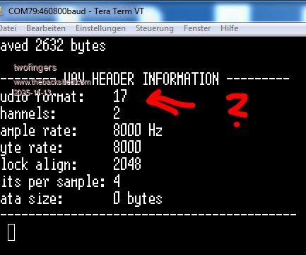

The WAV format is unusual (type 17) and the signal level is abysmal.

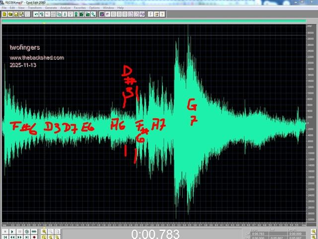

I made a first attempt with Cooledit, but only found 8 different tones:
D3, D#3, A6, E6, F#6, A7, D7, G7
That doesn't seem very plausible to me.
My suggestion: You could use a better microphone and ring the bells individually. Or check if they might even be stamped? ;-)
The storage format shouldn't be ADPCM, but PCM, mono, 16 bits/sample.

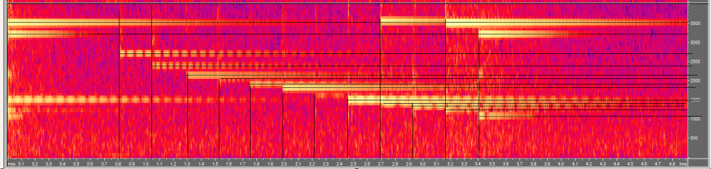

My version of CoolEdit using waterfall display
Frequencies detected (first number is time from start):
0 3500 3200 2130 1500 1210 1060
0.81 2750
1.04 2400
1.3 2130
1.53 2020
1.75 1900
1.99 1800
2.21 1600
2.46 1500
2.69 3500 1400
2.925 1350
3.165 3500 1210
3.41 3200 2130 1060

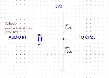

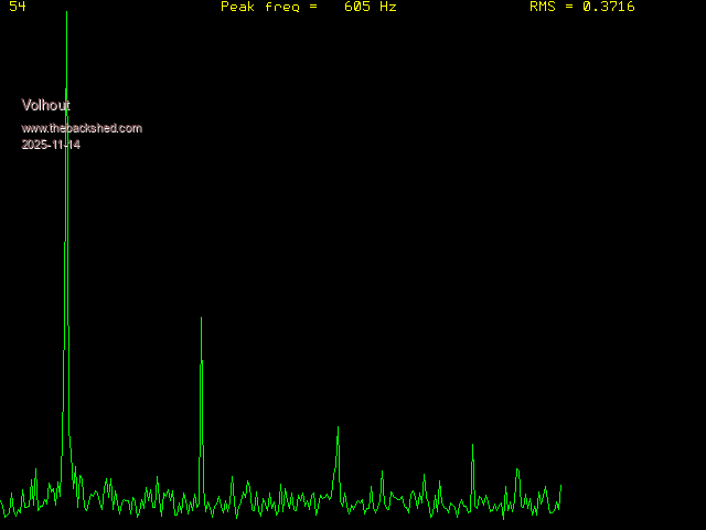

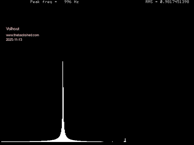

The screen will show the spectrum, the top right corner will show the level you input, try to increase the volume so get close to 1Vrms. Not higher, since you overdrive the input ADC. The sampler works at 10kHz, so you should be able to detect all frequencies up to 5kHz.
This is the input circuit I used.
P.S. the audio analyzer loop time is 70ms, so it most likely is fast enough to detect all notes (200ms between bells).
P.P.S. for the purists: the display routine and FFT are much slower than the ADC sample engine, so there is more data acquired than is shown (roughly 40% more).
