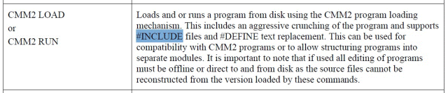

The PicoMite manual has a CMM2 LOAD command which mentions "#INCLUDE".
But "#INCLUDE" produces an error:
[11] #INCLUDE "jobrec.str"
Error : Invalid character: #
#INCLUDE would be useful for having a file which contains a structure for a file of structured data.
Edited 2026-01-08 02:22 by lizby

#include only works within a file being loaded by CMM2 LOAD or CMM2 RUN

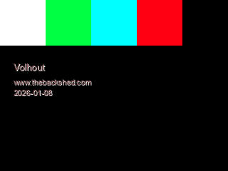

Posted: 09:00am
08 Jan 2026
  matherp said  It has never been available other than in VGA versions
Sorry to disagree. The Thermal Camera uses it, also for Game*Mite (there is no other code than that one), and I have seen the program work yesterday on an older release on a Game*Mite. My tea was 65 degrees C.
It would be fine to have it back, unless there is another way to achieve the same using a MATH function (now I have separated VGA and LCD, it is easy to use different commands for LCD).
Test code for colour map on LCD (tested on ILI9341, running 5.09.00rc5 that supports colour map on lcd).
framebuffer create
framebuffer write F
dim col%(15)=(0,0,0,0,0,0,0,0,0,0,0,0,rgb(white),rgb(green),rgb(cyan),rgb(red))
dim indx(3)=(12,13,14,15)
dim paint(3)
colour map indx(),paint(),col%()
for i=0 to 3
 box i*64,0,64,64,1,paint(i),paint(i)
next
framebuffer copy F,N
Edited 2026-01-08 19:16 by Volhout
Posted: 09:40am
08 Jan 2026
What should I see?
Posted: 10:00am
08 Jan 2026
