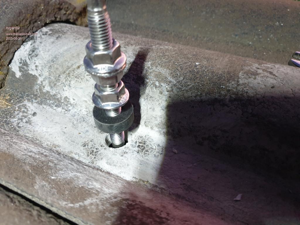

I've got a few projects on the go at the moment  ...  and waiting for a young fella who has been promising for weeks to finish bending up the cowls to go over my inlet and outlet ducts  ...  plus I've been dragging my feet on tackling the mounting system for the roof  ...  but finally today I actually made some progress.
The whole assembly is 4 mtr x 2.4 mtr  ...  and so it will straddle 8 rafters.
I bought some 200mm x 10mm stainless steel anchor bolts which have a coach screw thread at one end and metal thread at the other  ...  with a rubber grommet in the middle to seal where they come through the tiles.
I bought a batch of 5 diamond encrusted 16mm bits to drill through the tiles  ...  ~$20 from aliexpress  ...  as against ~$60 for one from Bunnings. I practised on a spare tile and was amazed at how efficient it all was. Certainly worked better by consistently spraying with water to lube and cool.
I was on my third bit by the time I finished the 16 holes, so very relieved I bought the five.
The corner bolts are not meant to be aligned with the side ones.
The next items on my shopping list are a couple of 250mm Dektites for where the inlet and outlet ducts go through the tiles. Special order from Bunno's.
And I also plan on adding some extra support struts below the mounting points to help with the load. The bottom row is just above a wall, so will only need a couple feet of timber for each of those. The higher end will need some triangulation, but shouldn't be too difficult.
All up will be around 300kg  ...  so approx 20kg per mounting point.
Winter will probably be over by the time it gets on the roof  ...  but hopefully will get years of use from it once it's up there.
At least I know the concept works as our original one is still going strong  ...  and just recently I came across a video of a Chinese firm that is selling the exact same thing. I'm not sure what it was heating  ...  but one shot showed about 20 of their units, each with 50 tubes, all on the roof of some building. 20x50 tubes = 1000 tubes!!!
And there were several other shots with multiples of the units all together  ...  so they are clearly building and selling them. Wonder if they've been visiting the back shed?

Hi Roger you probably already know this but with SS threaded parts they are prone to galling so make sure you put some lube on the threads    The last you need is a stuck nut on the installation.

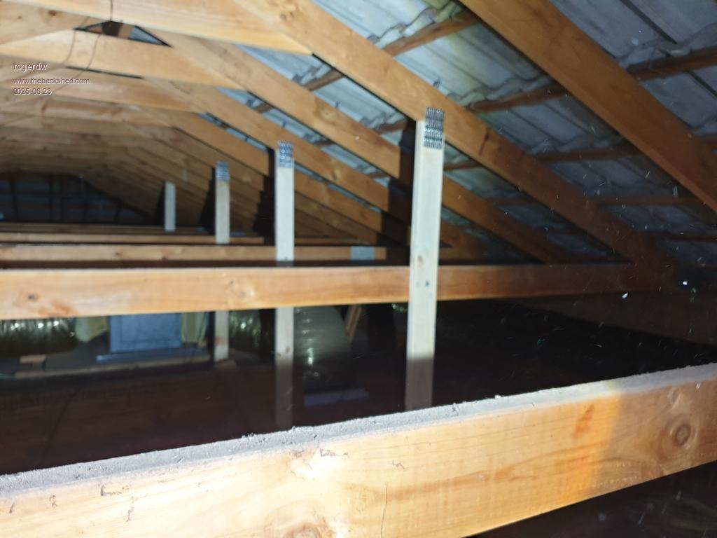

Hi Bryan, and no I had never even heard of galling with SS threaded parts. I've probably experienced it at some stage but never knew it was a thing  ...  thanks for the heads up. What lube would you recommend using or isn't it really important what type as long as there's something.
And thanks for the offer of help with installation. I do plan on hiring a crane for the lifting  ...  but could certainly do with an extra man on the roof making sure it locates properly as it's lowered. I'll let you know as it gets closer and see if we can make a time that suits. Thanks again.
I am feeling a lot more confident now I have all the anchor bolts in place and just need to cut up and weld together the angle brackets that will sit on the bolts, so the frame can be lowered onto them. Then I can drill through the sides of the frame and stick some bolts through.
I managed to get four support timbers in for the higher side  ...  and was surprised and really pleased that there is a wall directly below, that the struts rest on. I'm hoping I actually planned that but can't really remember, it was so long ago when I was crawling around in the ceiling trying to work out just where to locate everything.
I haven't tackled the lower end yet but they need timber about 900mm long on a bit of an angle to another wall frame. Should be easy enough to do that next weekend.
It's not a good photo, but the anchor bolts are located directly above the studs  ...  and the bottom ends are resting on the wall frame. The closest one looks like it's on a bit of a lean  ...  but they were all dead vertical according to the spirit level. Must be the optics.

Roger what I use on solar rack bolts and fittings it called Nickle Seize.
Stainless steel as Bryan said does gall. Old solar rack bolts are almost impossible to remove after a few years.
So I put nickle seize on the threads and have found it works well.
I use it on any stainless steel bolts especially on motorcycle engine bolts.

Thanks Pete. I guess that's what was wrong with a heap of solar fittings I couldn't dismantle when I wanted to reuse it. I just assumed there was a mismatch of materials  ...  but was probably this galling you're talking about.
And thanks Bryan, that would be very useful. Hopefully once it's up there it won't need to be altered in my lifetime, but you never know.
I do wonder now about all the railing and fittings I used when I put up all my panels  ...  I just put them all together dry. Hopefully I won't need to make any changes there.

I would recomend LanoCote available from Bunnings for use on all solar fittings, stainless bolts etc, just spray it on; years later you wil be able to pull things apart again. LanoCote

Roger looking at that Lanocote Mike mentioned sounds like the best solution and I'm even going to get a can for myself.
The beauty about lanolin spray it does get in and stays there and being a spray can with a fine nozzle will make it a breeze, even with your existing solar array a quick spray where the bolt goes into the base block will do wonders for undoing it down the track.
The main problem with old style never seize it does get everywhere and makes a mess so a spray can does look the best solution.

Well I spent some time in the ceiling again today and added 5 supports under the lower side of the mountings  ...  so it looks well and truly overengineered to me.
I harrassed the young fellow yesterday who's supposed to fold up the SS shrouds  ...  and he promised he will do them on Monday. We will see.
Now that the anchor bolts are sticking out through the tiles, I have to drill the heater frame in the correct positions for each corner. The remaining mounts on the sides will have seperate clamps which can be adjusted up on the roof  ...  but these corner ones need to be accurate. I don't fancy having the thing suspended under the crane and having to drill or file out the holes to make it fit over them all.
In hindsight I should have made the corner mounts the same as the rest  ...  would have been so much easier. Either way it will still work.
