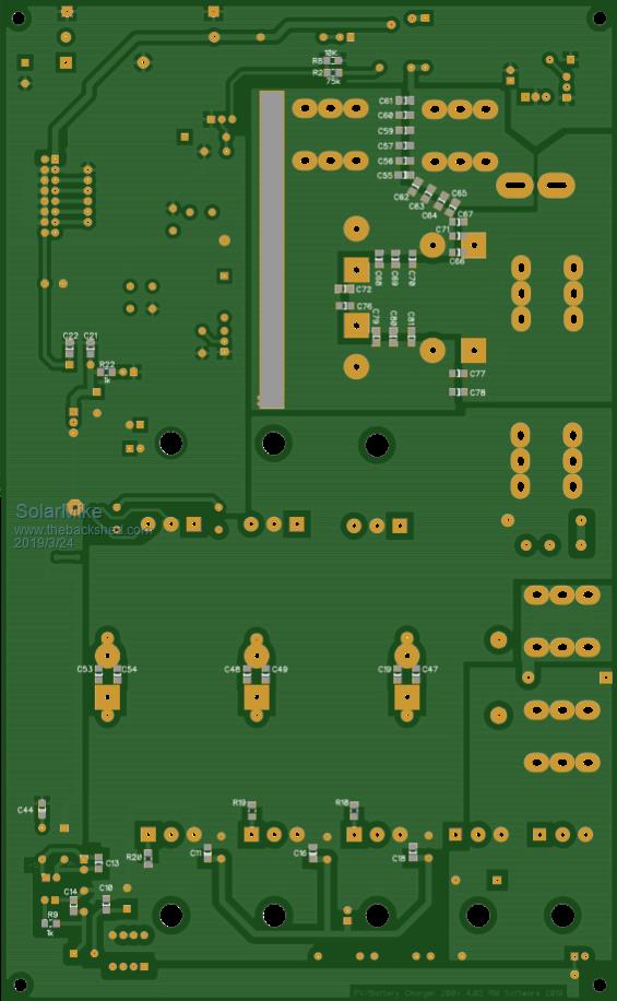

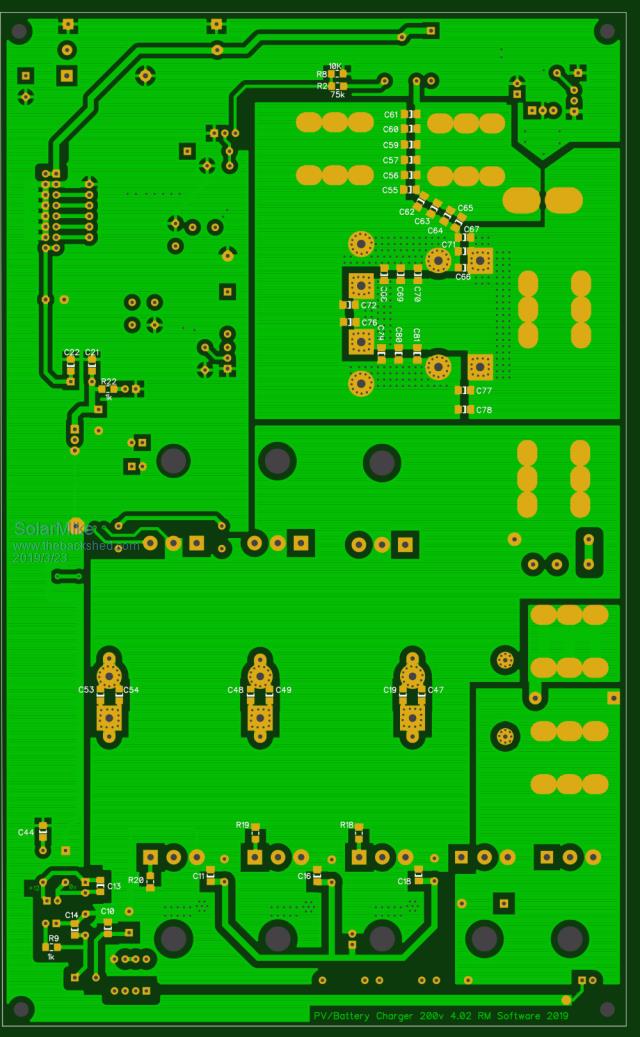

Solar Mike
It's been awhile getting this project off the ground, my initial intention was to build a controller that would handle 100 amps or more charge into a 50v bank, built using modular boards that plugged together. However other more pressing projects intervened and now the humongous mppt controller idea has been sidelined for awhile.
My more immediate requirement is something smaller that will accept up to 200v PV and output 60 or so amps into the bank. From a spin off from another project have designed new pcb's, using a single power mppt pcb and a controller cpu pcb linked by ribbon cable. I want the size to be smallish and not limited to any particular CPU. My idea is to bolt 4 of these units into a low profile metal box with large door, so 4 PV arrays can be connected.
The main power board is 2 layer 2oz copper, this sits atop a large finned heat sink, with the mosfets bolted to under the pcb using 3mm bolts and insulation washers. The large holes allow allen key access.
Synchronous rectification has been used in the buck stage using a dedicated control chip. The main switching mosfets each have high current buffer drivers and connect to the cpu board by a high speed opto-coupler.
Intended switch frequency is 100Khz, with the cpu having secondary control of the PWM to effect the MPPT and charge function.
PCB sizes 243 x 150mm, the EasyEDA gerber viewer I'm using doesn't show the top silk layer very well, resulting in some components with no outlines (Big Caps) they all show correctly on the JLCPB cart page ??
Top:
Bottom:
More to come...
Mike

Glad to know that you are back in action on this one.
Just a quick comment. Don't you think some kind of fan control circuitry is needed here. I haven't been able to locate any on the PCB image.
azhaque Edited by azhaque 2019-03-25

Solar Mike
  azhaque said   Just a quick comment. Don't you think some kind of fan control circuitry is needed here. I haven't been able to locate any on the PCB image.
Fan control and other intelligence is set on the CPU driver board that plugs in via the ribbon cable.
I have a PIC cpu board from another project that will be used to test it, it may be possible to cram a cpu controller on the main board as there is a lot of free space. Others may want to use an Arduino or similar, easier to do on a separate pcb.
However prob wont need a fan, heat calculations work out about 30-40 watts in the electronics + some heat in the inductor with 3KW output power.
Mike

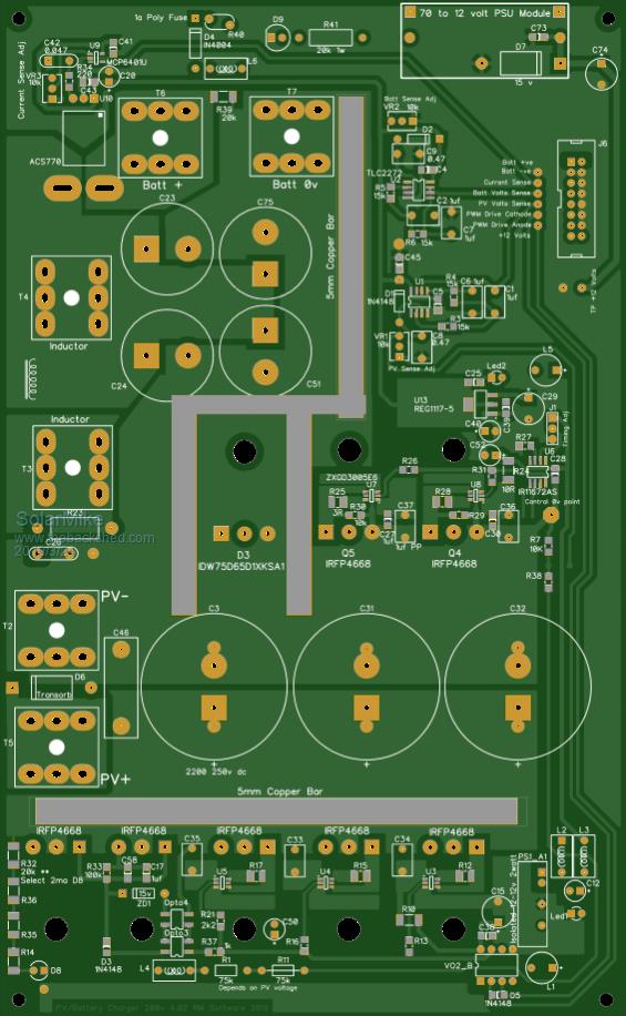

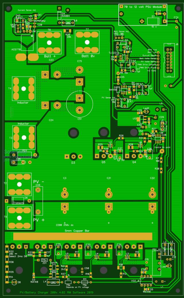

Made changes to pcb to allow soldering of additional 5mm sq copper rails to pcb in areas of high current, existing tracks should be good for 60 amps. but you know how we want to push things a bit. The mosfets are good for > 300 amps, so .....

Solar Mike
Hi Nick,
No, free space layouts with big wires etc do not provide repeatable results. A well designed pcb needs RF like design concepts with proper grounding and minimization of power earth loops. There is no reason why this board wont work up to 150Khz, which will keep the buck inductor size down to something that doesn't cost an arm and a leg.
The current controller pcb for this board has the CPU, driver and HF pwm generator, this makes it more difficult that necessary to use other CPU chips like Arduino, so I have decided to move some of the functionality from the driver to this main power board. This change means your CPU (Arduino etc) only has to output a low frequency 3Khz pwm with variable duty cycle between 0 and 100% with 1024 bit resolution to control the HF pwm on the power board.
Thus the driver board now requires a minimum of
1 output: LF 3 Khz PWM variable duty cycle
3 inputs: Battery Volts, PV Panel Volts (Normalized to 0-5v), Output charge Amps;
to run it.
There is room to do this without increasing the pcb size, so cost wont increase, last pricing I had back from JCLPCB was about $50 US for 5 boards, repeat batches are also less expensive as they already have the setup done.
Once I have it built and tested I will release the Gerber files and a new circuit diagram here, so anyone can get pcb's made.

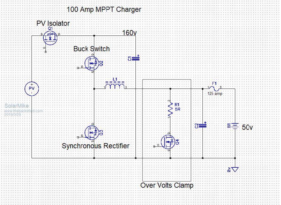

I have missed out something from this design and it is the answer to this question:
What happens to the circuit during full power operation and the battery is suddenly disconnected. ie the output fuse or circuit breaker may have opened or someone manually turned it off.
I know a number of expensive commercial MPPT chargers where this has occurred and they have been destroyed in the process, in fact the manual specifically say's don't remove the battery when in operation as it will get burned - their words not mine.
Here is a basic block view of the current charger design:
What will happen is the charged 160 vdc capacitor C1 discharging through the buck switch Q2 via L1, charging C2 and no longer supplying power to the load, will suddenly increase the voltage across C2 to 160v and blow it, along with the electronics up.
I believe a clamp must be very quickly applied across C2, tripped by a fast acting electronic circuit, completely independent of the CPU control system. CPU is too slow to react here; SCR's are quite often used as shutdown clamps, I prefer using a mosfet as its much quicker and easily triggered, (cheaper too).
My thoughts are to trigger a clamping cct that draws 10-20 amps to discharge C1/2, the trigger can also tell the CPU to shut everything down giving it the time to do so.
Any thoughts....
Mike
Posted: 02:29am
29 Mar 2019
Assuming that C2 is safe to at least 160v, all you need is a big slow diode back from C2 to C1.
That will soak up all the stored energy in L1.
Q4 could also be an SCR triggered by the over voltage event.
