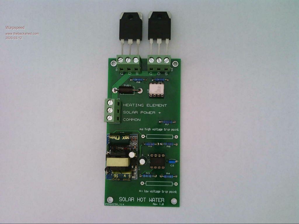

Dave, DHL delivered a nice little package for us about an hour ago.
If you can pm me with your address, it could be in the mail to you today along with the four extra blank boards.
Just bench tested it, no surprises, everything works exactly as anticipated.
Interestingly, the +12v supply is sightly low at only 11.74v which causes the switching points to coincide almost exactly with the resistor values fitted. 180K=180v 220K=220v 270K=270v  etc..
These little supplies always tend to be a bit short of voltage, typically 11.9v. I have never actually seen one at the full rated 12.0v.
Edited 2020-03-12 15:04 by Warpspeed

These boards look great! Very different to how I pictured them and a very neat layout! Seeing things laid out like this makes me confident even a Dilettante like me could put them together. Tis a thing of beauty!
My idea was to put the Mosfets on a CPU heat sink with a fan. I take it as long as I keep it under 100o ( Mosfet is Limited to 150 right?) that should be ok or do they have to be cooler as I would try for anyway?

The mosfet driver chip does three things.
It inverts the signal from the LM555, as the output of the LM555 is "upside down". Pin three is logic low when we want our mosfets to switch on, and goes logic high when we want the mosfets to switch off.
The gate drive chip also provides a nice clean very fast high power drive waveform to the mosfet gates, and can easily drive a couple of giant mosfets.
The gate driver chip also has an internal undervoltage shutdown.  At sunrise and sunset the small 12v dc supply really suffers and struggles, and the undervoltage shutdown ensures that the mosfets cannot "half" turn on and create even more problems. The mosfets will either be held off when the +12v supply is very low, or start working when the +12v is high enough for the system to function.
It will probably still have fits and starts when the sun is just below the horizon, but its not going to be destructive. Its an interesting thing to watch any solar control system struggle pitifully into life at first light, and usually die in convulsions at dusk.
Anyhow, I wished to keep the whole thing very simple, with the fewest possible parts, and an opto isolated gate driver has the exact three functions I wanted all in one chip, even though the opto isolation feature is not being used.  That part of the circuit is a little "odd" but its the simplest fewest parts solution I could come up with.
