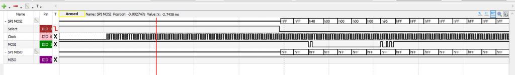

Something wrong happened with SDCARD on my Picomites with WaveShare 3.5 touch board.
As could be seen from the logic capture, at least 2 strange things observed:
1. Clock begins far before CS
2. Clock frequency is 25 kHz
3. No MOSI activity
All works fine before. Now the same problem on two Picomites,
regardless FW version.
LCD and TOUCH works fine.
Edited 2022-01-01 00:24 by Kabron

Posted: 06:39pm
31 Dec 2021
  Quote  1. Clock begins far before CS
3. No MOSI activity
This is completely correct

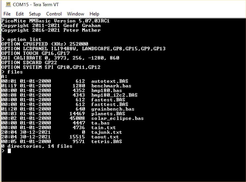

Is this a problem with all SD cards or just one? One of mine responds with "SD card not found" the first time you type FILES but works perfectly thereafter.
Is an iffy plug/solder connection a possibility?
Too complicate for my simple mind.
You mean that is the goal reached?

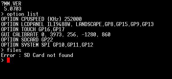

Same issue here.
Everything works but the SDCARD on the PICO-RESTOUCH-LCD 3.5
SD Card not found
I thought I read the options right...
OPTION SYSTEM I2C GP6,GP7
OPTION LCDPANEL ILI9488W, LANDSCAPE,GP8,GP15,GP9,GP13
OPTION TOUCH GP16,GP17
GUI CALIBRATE 0, 3985, 275, -1278, 881
OPTION SDCARD GP22, GP5, GP18, GP19

Tried a new SD card?
(Don't be tempted to use a high capacity one - MMBasic has sensible limits! And be wary of very cheap cards on ebay as you might end up with 256k having paid for 16GB)
Handy note - but max size for MMBasic is 32GB
When you format a card be careful. Windows 10 will, by default, format cards bigger than 32GB as exFAT, which is a Microsoft special and is no good for some things. You have to either format from command line or use an external program to force a format to extended FAT32. I usually use rufus, but there are others.
Posted: 08:16am
23 Jun 2022
AFAIK extended FAT32 works by increasing the block size from 512bytes. This is not supported by the PicoMite firmware/FatFS so the maximum card size supported by the PicoMite is 32GB in standard FAT32

Will try a smaller card.  Was using 16GB though.  and... 4GB Fat32... "Error: SD Card not found"  :(
FYI: I use a PUTTY terminal variant called PUTTY-ND that understands that USB COM PORTS can go away and come back.  It says "fatal error" when the pico resets... then says "trying to restart session" and then... without you doing anything else... you hit the ENTER key and you are back on the PICO command prompt.  It can save some steps... when using PUTTY.  The new TERATERM version 5 alpha handles this ok as well.  So, Update your terminal software... :)
And then... for reasons unknown... it just started working. I can see files.
