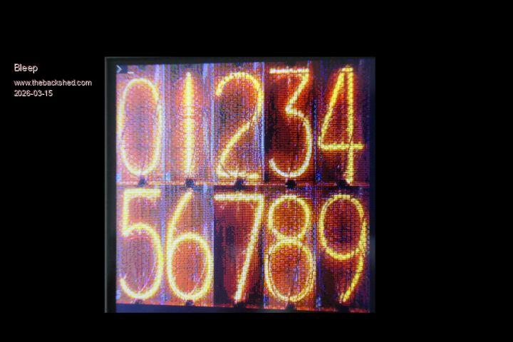

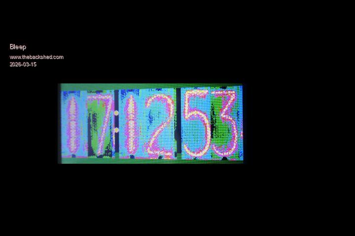

Posted: 05:48pm
14 Mar 2026
Bleep
Hi Peter,
I am using a ST7796S on a USB RP2350A Edition V6.02.01RC6.
I am loading a jpg to the screen.
I then Blit Read each digit, I then Blit Write the digits to create a nixie display, but what I get back is
I was told, maybe wrongly, that Blit Read preserves the colur depth? the manual says RGB888.
I have also tried the dithered load, for 255 colours, I get different, but similar results.
I think I have bridged D1 and J1, it's now difficult to check :-( would I get colour distortion like this if I hadn't?
Or is this something that should work?
Regards Kevin.

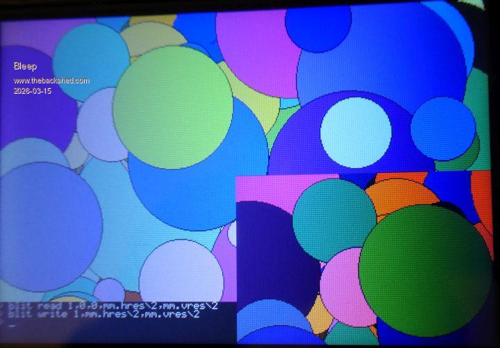

Posted: 08:31pm
14 Mar 2026
Bleep
Hi Peter,
doing the test you suggest I get the following, so the colours have changed.
One subtilty with my set up, is I am using the LCD on it's own SPI, I did this to get the maximum speed out of the disply.
OPTION LCD SPI GP26,GP27,GP28
OPTION SYSTEM I2C GP20,GP21

Posted: 10:23pm
14 Mar 2026
Blit appears to get the colours right with ST7796S on SYSTEM SPI.

Posted: 10:47pm
14 Mar 2026
  Quote  One subtilty with my set up, is I am using the LCD on it's own SPI, Could this be causing a problem?
Yes: if the display has a touch controller because its CS isn't being held high
Posted: 01:04am
15 Mar 2026
  Bleep said  OPTION TOUCH GP17,GP7
GUI CALIBRATE 0, 3944, 3891, -1289, -857
Perhaps try a pullup on LCD_DO - MISO - GP28 (3k3 to 10k) and perhaps on T_CS - GP17, though I expected Option Touch to have done the trick there.
A command line colour counter without BLIT to determine if the issue is related to LCD_DO - MISO - GP28.

Posted: 12:00pm
15 Mar 2026
Bleep
Hi Peter,
Thanks for your help, putting the LCD on the System SPI now works correctly, unnoticable speed diffence, but maybe that would change if I was streaming music or similar from a SD?
Might be worth mentioning in the manual, that using the dedicated LCD SPI, with touch,  might cause subtle problems with reading this display? While doing the hardware change, I was able to check that I have bridged D1 and J1.
Thanks again.
Regards Kevin.
Edited 2026-03-15 22:03 by Bleep
Posted: 12:10pm
15 Mar 2026
There is no speed advantage to using LCD SPI. It is specifically needed for the buffered drivers which update the display using the second processor and therefore need a dedicated SPI channel. This is where you would see a speed difference when also using SD. But, without a buffered driver, you are single threaded on core 1 so you would be waiting for SPI whichever channel.
