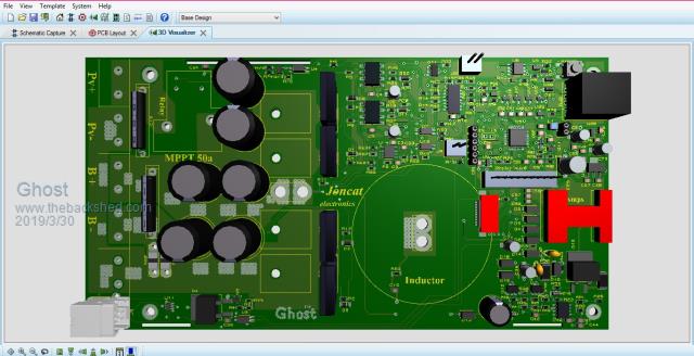

Hi all , I appreciate the good works you guys are doing, this is my own designed mppt 50a , max input 150v , currently sourcing the materials to build it ..
Posted: 08:09am
30 Mar 2019
Ghost
Based on arm processor . Auto battery 12v to 48v

40a relay, but in this design, processor gnd is isolated from buck gnd, I suffered system freezing when I was using pic microchip, so I decided to isolate this present design, but do you have any idea why chargers freezes up in high current (42a) precisely.

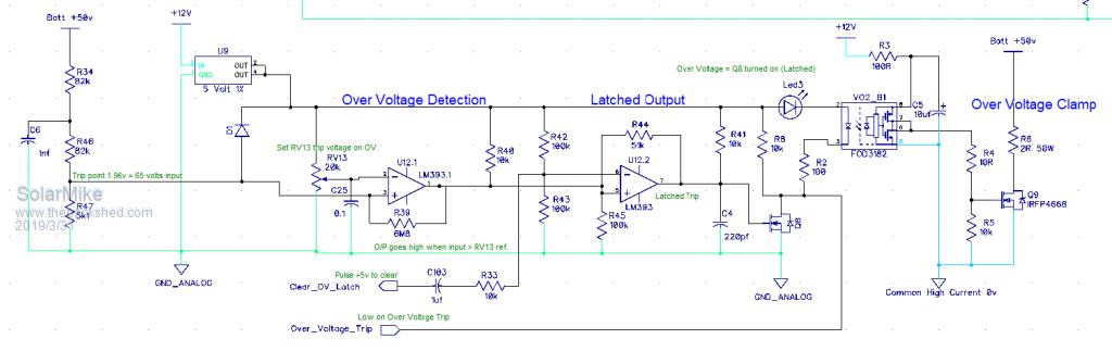

  Solar Mike said   I have missed out something from this design and it is the answer to this question:
What happens to the circuit during full power operation and the battery is suddenly disconnected. ie the output fuse or circuit breaker may have opened or someone manually turned it off.
I know a number of expensive commercial MPPT chargers where this has occurred and they have been destroyed in the process, in fact the manual specifically say's don't remove the battery when in operation as it will get burned - their words not mine.
Here is a basic block view of the current charger design:
What will happen is the charged 160 vdc capacitor C1 discharging through the buck switch Q2 via L1, charging C2 and no longer supplying power to the load, will suddenly increase the voltage across C2 to 160v and blow it, along with the electronics up.
I believe a clamp must be very quickly applied across C2, tripped by a fast acting electronic circuit, completely independent of the CPU control system. CPU is too slow to react here; SCR's are quite often used as shutdown clamps, I prefer using a mosfet as its much quicker and easily triggered, (cheaper too).
My thoughts are to trigger a clamping cct that draws 10-20 amps to discharge C1/2, the trigger can also tell the CPU to shut everything down giving it the time to do so.
Any thoughts....
Mike

Have modified the charger circuit to use a fast comparator (dual LM393) to detect an over voltage event and simultaneously lock out the pwm drive along with setting a CPU interrupt to shut down the charger. Optionally a mosfet can be shunted across the supply to stop voltage rising further; the opto-coupler driver allows the high current 0v be separate from the analog ground.

Can I see the PV isolation circuit you are using, am using relay, but most times on high solar volt relay creates noise to the gnd. which is bad for most chips, so I limited to 150v input, but 120v practical.Edited by Ghost 2019-04-02

Having blown up quite a few things myself over the years, the most common mode of failure for a buck regulator is the series switching mosfet failing shorted.
That could be rather unfortunate for the battery.
The way I do it now, is the battery management system controls the PWM to the buck regulator, but if the output charging current has ramped down to zero, or the regulator needs to be turned off completely, there is also a series relay in the solar supply.
Normally the buck controller does all the turning on and turning off, so the relay never normally has to switch under load. But if something fails, its a last resort safety feature, and the first line of defense against battery over voltage.
Whatever controls the relay must be quite independent of the normal PWM control system, so that no single fault can disable both systems.

  Solar Mike said   Have modified the charger circuit to use a fast comparator (dual LM393) to detect an over voltage event and simultaneously lock out the pwm drive along with setting a CPU interrupt to shut down the charger.
Mike
Mike,
Greetings.
Having two op-amps/fast comparators between the +50 bus and the clamping mosfet, may have associated delays to put to naught the safety mechanism you want to put in place.
A couple of turns on the toroid with a zener to the MOSFET gate seems to be the solution, to avoid the delay issue. Although it will be a little tricky to set the turns and the zener voltage to avoid false triggering.
Thanks for the input, yes there are two delays introduced at C4 (2.2us) and C6 (40us), I put these in to prevent noise glitches causing false triggering, will determined final values after in-situ testing; am not worried about a small delay as the rate of change in current buildup (thus voltage) in the buck circuit is set by the inductor and output capacitor. The trip point (65 volts) gives plenty of time for the circuit to react.
Placing a voltage coupling circuit to the buck inductor seems very haphazard as to expected repeatable results...

  Ghost said   I will update upload a circuit that will work better , but the pwm input have to go through the circuit, the circuit will look limit the pulse going to the fets when the volt is going out of range . Relatively a bit complex circuit.
Currently I have a 3 input AND logic gate that is used to lock out the PWM, 1 input has the PWM signal, 2nd has the Over_Voltage_Trip from the latched output, 3rd has a shutdown output from the cpu..
If anyone can think of a better detector \latch let me know, this one here is pretty simple using a dual comparator and a few components.

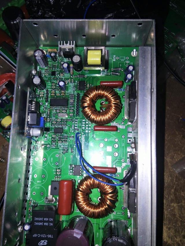

My mppt , based on pic, 40a recorded so far, very stable.. I handle over volt issue in this by switching off the pwm pins immediately output reaches 59v ..

Well done that looks excellent, are you using two buck inverters there combined to single output. The coils look quite small.
I haven't decided on a final buck inductor, will pick the best on test, but at 100 amps it will be quite large, thus the reason for not mounting on pcb.

Ghost
That's 33mm inductor, interleave 180 degree phase, combined to single output . though it's fan cooled at current above 20a ..
