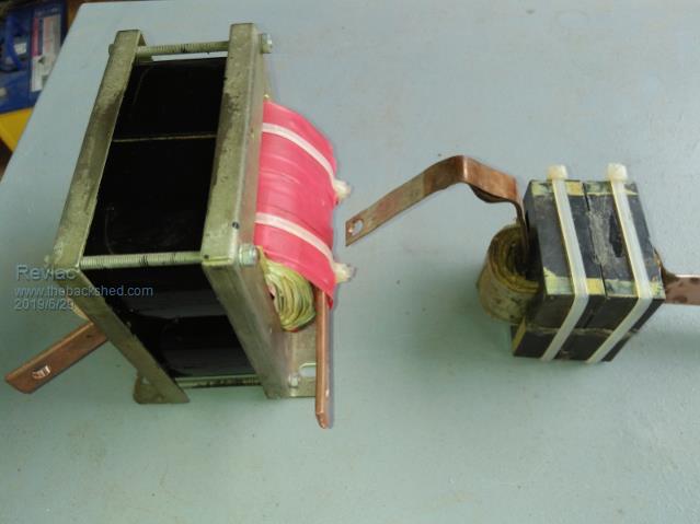

Had a little spare time the other day, decided it was time to try winding the large choke, using just the material on hand.
Started by using the 2 pair of laminated steel U Cores arranged as a double E, (similar dimensions to the large Aerosharps) only had some aluminum strap and some copper bar.
The aluminum strap was 1mm thick and about 35mm wide, so 2 strips of this would fill the space nicely.
The aluminium strap was only 3.1 meters long each, after it is (cleaned) folded around the copper bar and riveted nicely, it made up 13 turns for that size choke core, there is transformer paper between layers.
Very important to make the former bigger.
It Was a good learning process and will see if it works ok...or not.
The little choke (on the right) is 2 pair of ferrite EE cores with 4 turns 2mm X 25mm copper strap, takes some effort to bend it.
I used some hot glue to stick the cores together (not ideal) I can take it apart if its no good, Best thing is that it run's silent when I tested it last.

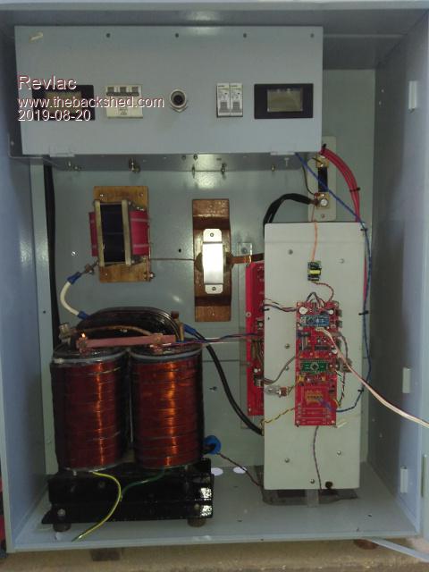

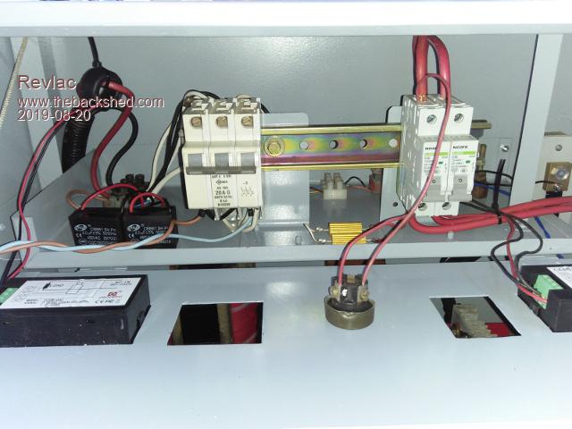

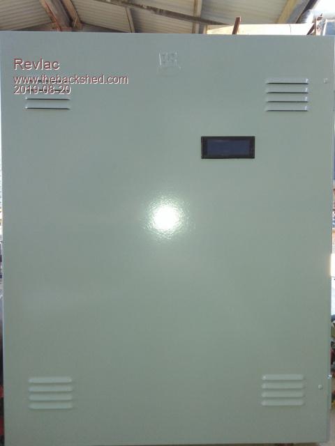

Getting closer to firing this one up.
After placing and mounting most of the components, to see if it all fits nicely, it was time to tear it all down for a paint job, (some of that silver paint that is actually grey).
I have managed to fit most of the ugly wiring up the top, it is out of site and should not need any alteration once everything is working properly...hopefully.
Also fitted up a push button to charge the caps through the pair of resistors, the voltage will be displayed on the volt meter and then switch the main breaker on when it looks good.
The rest of it is nice and opened and should provide good airflow around all the components, also I find it fairly easy get at any part if necessary.
I am still learning about wire routing, trying to keep it neat but at the same time keeping signal wires apart avoiding potential noise issues that might (could, wood, will) cause problems.
Still have to find some thermal grease for the temp sensors, and find the most appropriate spot on the transformer for the temp probe, I think placing it on the steal core just above winding's should be ok.
The front door will be fairly plain looking, only have one display with the info from the Arduino, it should be all I need most of the time.
Hopefully get some time on the weekend to fire it up and see what happens, Will be running one fet per leg and no caps, to start off, if all is good I will put in the rest of the fets and try again.
Will have to test another batch of fets, did this already some time back, but they have since been mixed up again.
Also need to run an earth wire from the transformer, case etc.
Slow progress.

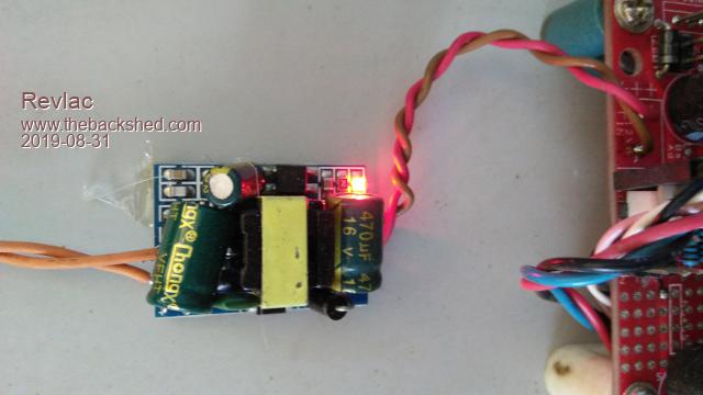

Ok fired it up and its runs, Have done some basic testing and found a few bugs.
Firstly the idle current of 34w was a bit higher than it should be, given the results of my earlier testing of the transformer when I was testing the turn's vs Idle current.
Checking my notes: Originally the 240v winding on this transformer was 246 turns I think? and the Idle current when tested (with 240v supply) was around 17w that would have been over 50w when run as an inverter.
After rewinding to 380 turns for this 3120mm2 core the Idle current was about 7w, thats much  better and run as an inverter that should work out just over 20w idel power.
So 34w was wasted somewhere, going through the process of elimination I found that 8uf of filter caps was to munch, changed it to 4uf and tested again.
Now running at 24w, much better, this includes all meters/electronics, could probably tune it a little more.
Next issue was the temp sensor errors and the voltage readout was allover the place on the I2c display, will try some of those ferrite ring's and see if that settles it down a bit.
The next issue is somewhat self inflicted.
I connected the copper Earth shielding from the transformer to earth on the case, The inverter still runs ok but the nano and I2c module corrupted to buggery, a little red led on the nano started flashing rapidly.
Removed the earth wire from the case and it run ok again, so I suspect the metal case on the I2c display is touching the metal door were it was sitting in the cutout causing interference, even though the negative does not connect to the metal case on the I2c display.
Will have to figure out this grounding issue.
So far nothing blown up YET...
This little 5W AC-DC 12v Module has a bright red led on it, anyone else have this?
A bunch of these would make it look like a Christmas tree.

  Quote  This little 5W AC-DC 12v Module has a bright red led on it, anyone else have this?
Those little supplies all have that.

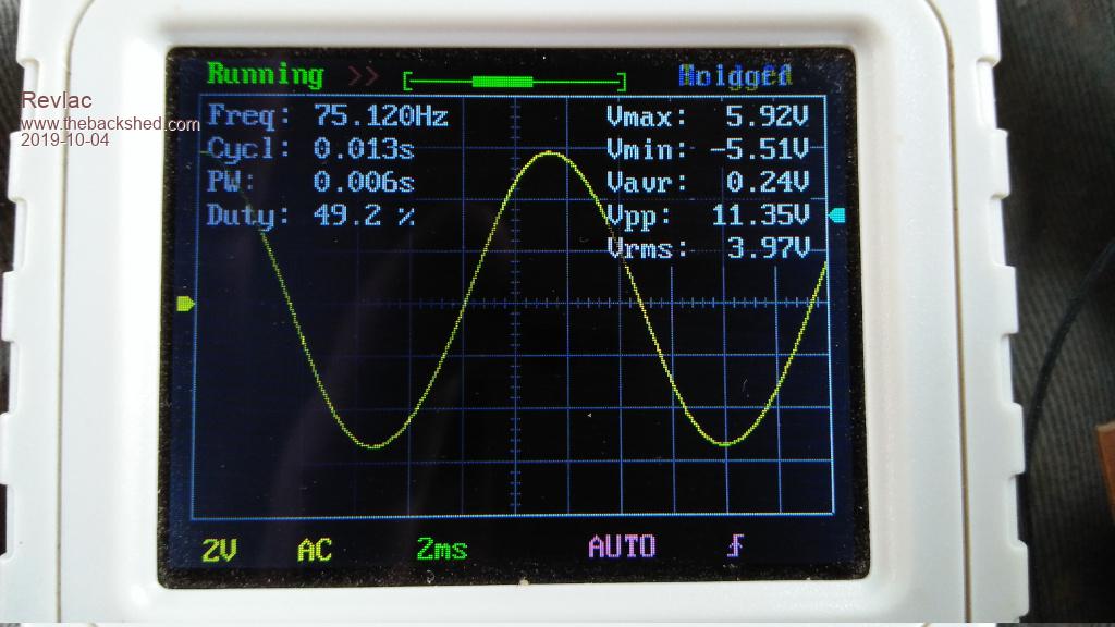

Revlac

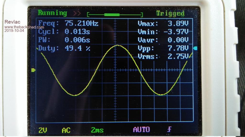

Did a little bit of testing today, trying to find the transformers resonant frequency.
I setup the little frequency generator at 75Hz and connected it to the transformer secondary (with series resistor) then checked the voltage as is, 5.19v is the benchmark with no cap connected.
Connected the 4uf cap and the voltage drops to 3.89v
After several different cap values were tested, the highest peak I could achieve is 5.92v and that was using about 1.5uf capacitance, bit lower than I was expecting.
Just to get a better picture of what was happening I tried to find what the frequency was when running the 4uf cap, turns out to be 33hz, the 8uf I had. must have been something horrible.
Not sure if I have done this correctly or not, but that's the result from using the gear that I cobbled together, using the LM324N and a few parts, its not ideal as the voltage changes with the frequency, easy just to set the frequency and then go through a selection of capacitors.
Also checked the frequency with a meter so it is correct on the little DSO...Corrected using the vertical slider on the right.
Hopefully this makes some sense.
I will try this again on the other inverter just to see how far out it might be.
Cheers Aaron

renewableMark
Good work Rev.
The way I remember Warp doing it, he set up a certain test cap on the secondary, then fed that secondary with the signal generator.
The DSO was used to observe the wave and a rotary dial on the sig generator was turned to the left and right adjusting the hz output, to find a peak in the wave.
As the hz output from the sig/gen is adjusted the wave changes shape to flatten out or get taller.
At it's tallest point that is considered the tune for that cap.
At that peak/tallest in the wave the hz was noted, if it wasn't 75, then more or less capacitance was adjusted.
Test repeated till that peak in the wave was achieved at 75hz.
I hope that was explained ok, Warp may need to clarify something.

Revlac
Thanks Mark.
Yeah. the explanation is plenty good enough.

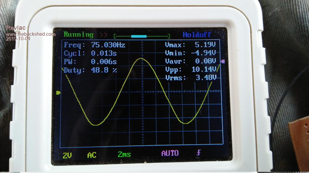

I just did it the other way round, set the signal gen to 75hz and went through a bunch of different caps until the I see the maximum peak in the wave.
Anyway, either method works ok.
Ok. tried this on the other inverter transformer (old EI type) and it was running with 5uf, turns out 6uf would be about right for it.
I noticed when testing this one, first without any tuning cap connected, the signal from the transformer was triangle shape, just add any small cap and it changed to a proper wave shape.
After getting the correct results with a 6uf cap, I tried to add a .22uf cap and the peak wave dropped noticeably, so it is really a very definitive peak.
Its great when you can see what is going on instead of being in the dark taking a guess.

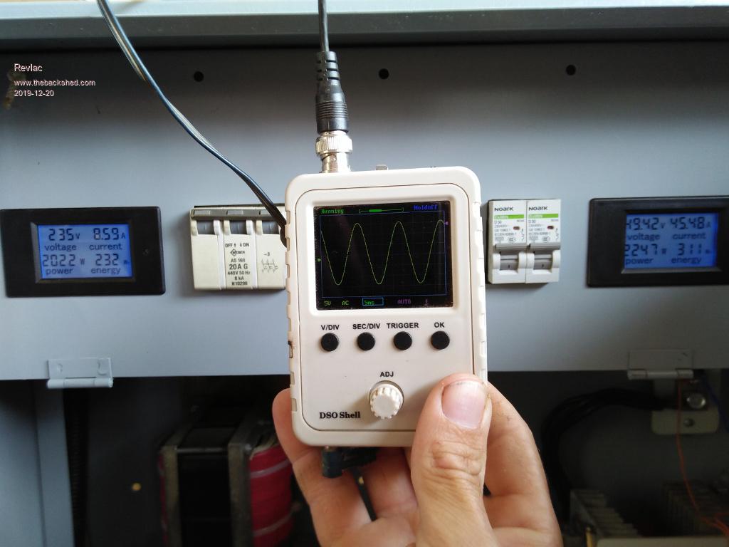

Revlac
Definitely a good idea to do a tune up.
During testing, with 20fets in place, it will use a few more watts idle power than the previous one fet per leg, I was expecting a little.... However I noticed a lot of heat generated on the control board at the 120r 5W resistor and the TIP35c transistor, after some checking, found I had a 13v volt zenor at the TIP35c on the power board. don't know how I missed it but anyway after fixing that the control board regulator etc. ran cool...now the heat has moved to the power board regulator but not so hot.
I have tried a few different loads on the inverter and so far it is running quite well.
Induction motors are good and the heater is no problem, large power tools with the soft start tend to give some minor little spikes on the waveform, but really nothing compared to what the little generator puts out.
It has the best looking sine wave out of just about everything I have, just a little better than the HF inverter, Much better than my Friends inverter, a thing in a blue box.
Dose not matter how good it is looking, everything still runs well, I was just wanted to get it without any wobble or blip at zero crossing.
It is running a kettle here, this one was built for the shed powertools, starting things not so much long running loads.
Still a few things I want to fix up a little, but its been a fun build....No fets were popped in this build yet.
