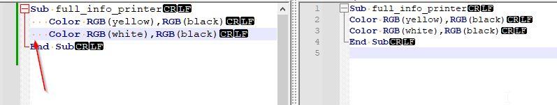

Posted: 08:39pm
18 Mar 2025
electricat
At left - will crash LIBRARY SAVE becouse of spaces in before Color RGB(yellow),RGB(black)
Sub full_info_printer
  Color RGB(white),RGB(black)
End Sub
This LIBRARY SAVE and also properly LIBRARY LIST
Sub full_info_printer2
End Sub
This will LIBRARY SAVE but...
Sub full_info_printer3
End Sub
... LIBRARY LIST will show
>library list
 Color
>_
P.S. One space is enough to call crash
Edited 2025-03-19 06:44 by electricat
Posted: 04:40am
19 Mar 2025
disco4now
Peter,
The token allocated to COLOR appears to be FF80.
I think the FF byte might stop Library SAVE when its found.
We might need a extend the condition to ensure the higher tokens don't stop the save.
I have not got an environment to compile so can't test.
COLOUR is OK because the token is AB81
  cmd_library
    // then copy the current contents of the program memory to RAM
      //MMPrintString("\r\n Size=1 ");PInt(m - MemBuff);
       p = ProgMemory;
       while(*p != 0xff) {
           if(p[0] == 0 && p[1] == 0) break;  // end of the program
Gerry
Footnote added 2025-03-19 16:28 by disco4now
Maybe this.
       p = ProgMemory;
      // while(*p != 0xff) {
      while(!(p[0] == 0xff && p[1] == 0xff)){
Posted: 05:58am
19 Mar 2025
electricat
If that would help somehow.
I removed in my eralier 'library file' spaces in front of command COLOR and LIBRARY SAVE works ok.
I replaced COLOR with COLOUR just to see how it will behave, and LIBRARY SAVE works ok too.
Any space left and it fails.

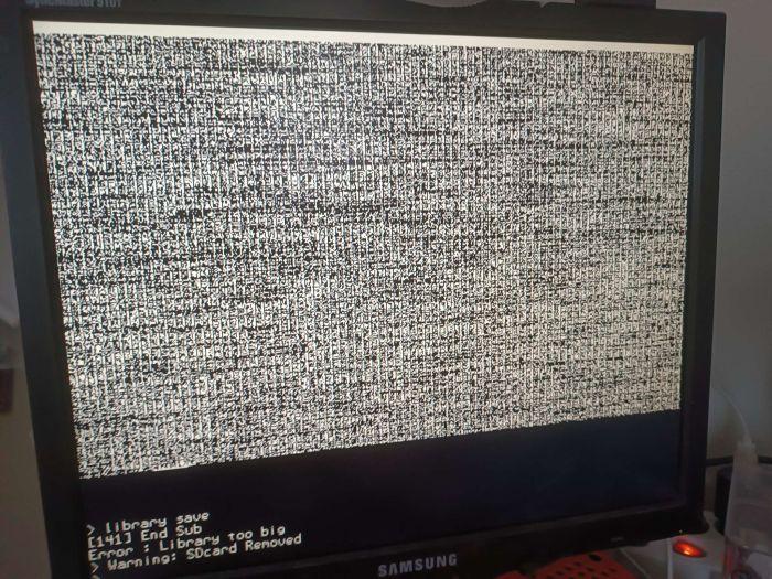

electricat
I`m afraid to be so boring, but... another sad observation.
Freshly cleared/flashed latest RC5
LOADed help.bas .. success
LIBRARY SAVEd .. success
OPTION RESET ...success. (Library deleted according to manual.)
OPTION DISK LOAD .. success(wanted to check if OPTION Fn saves/loads chr$(13) )
LIBRARY SAVEd ... FAIL!!! .
Video screen partially overwrited with data and errmsg
>library save
[141] end sub
Error : Library too big
I`m attaching file used:
help.zip
Edited 2025-03-19 17:59 by electricat
Posted: 08:09am
19 Mar 2025
  Quote  With connected PS/2 Mouse on GP27,GP28 it is impossible to use GP26, since it ALWAYS shows 3,3V (in reality the pin is @ 3,7V measured with multimeter).
Sounds like a H/W fault at your end. Definitely not the case with a bare Pico2 running PicoMiteVGA V6.00.02RC5
  Quote  The token allocated to COLOR appears to be FF80.
Gerry: Thanks - just tested you fix and it seems to do the business
  Quote  I`m afraid to be so boring, but... another sad observation.
The manual needs correctly - changing options does not clear the library so you need to use LIBRARY DELETE
Edited 2025-03-19 18:22 by matherp

Posted: 09:24am
19 Mar 2025
  Quote  LOADed help.bas .. success
Sorry but you are pushing the limits of what the system can protect against. I've no idea what is in your OPTION DISK LOAD file which includes information about the library.
I don't intend to look at this further other than to implement Gerry's fix for the COLOR issue.
Delete the library before resetting options and make sure you only disk save the options when the library has been deleted
