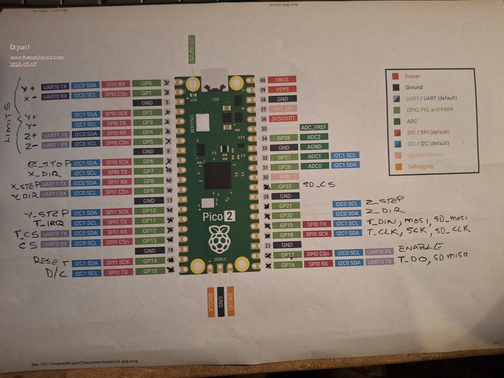

I do think it is time we cameup with a pin assignment so the stepper code can be inserted and Lyle hopefully you can have a play tonight with it.
Regards Bryan
Posted: 08:08am
06 May 2026
Bryan1
Well just had a look on my house computer for Sprint Layout only to find it kept hanging and couldn't find the download file.
So back onto Abacom via email and hopefully a new download file can be given so I can get on and design a PCB for this project which can be a universal PCB for the MMBasic Stepper Project.
Now thinking aloud about the pin assignments
As we are now upto 4 axis with 3 pins being enable, step and direction, 12 pin's.
6 pin's for the limit switch's, one for the E-Stop and one for the motor via a relay board.
Now for the E_Stop if it is Active Low a N/O external switch could be used so an external switch can be used for the E_Stop.
14 pin's if we use a SSD1934 LCD so we are now upto 34 pin's as I do think the ILI9488 3.5" LCD is too small to use as the interface so YES Peter's big 2350B board will be the best one to use.
To use the Brain Trust on this forum whats the biggest LCD screen we can use on SPI so the pin count can be reduced so a 2350A pico could be used.
Also I am thinking as a number box is on each axis the toggle component can be a multi component of that value.
Like with the Z axis where we have a grinding wheel doing 3500RPM each step is cut on the grinding wheel but the resolution still needs to be tested so now the code is ready to be advanced that will be my next task to get the Z axis going.
For the X axis I do have some 1/4" Chain sprockets, one is 56 teeth and the pinion is 15 teeth which is a 3.73:1 reduction so hopefully that will give enough torque for the rack and pinion X axis drive.
So tomorrow back on the tools and get all 3 axis hooked up so we can move forward.
Regards Bryan

Ok with Peter's big 2350B board what is the side width of the pins on the board so I can make a start on the PCB as I am keen to get onto designing up this circuit board in Sprint Layout as I do feel that is the next thing to do as it will take time for JLCPCB to make and if they do parts on the board most parts can be SMD
I do feel a bit of Phenix is needed here so we take this PCB to another level

I measured the RP2350B board as 3.2" long x 1.1" wide.
Pins are 3.1" long (32 pins @ 0.1") and 1" pitch wide.

Just a thought, looking at display options would a 4" SPI LCD be a good compromise?
https://www.elecrow.com/4-inch-480-320-spi-tft-lcd-module-with-st7796-driver.html
This would allow us to use a standard Pico2 module and have enough I/O for the stepper system as well. 4" seems to be the biggest display that is SPI interface off the shelf.
My eyes are slowly going as well but I tend to wear glasses while operating the machines anyway.

  Quote  As we are now upto 4 axis with 3 pins being enable, step and direction, 12 pin's.
Would connecting all Enable inputs to 1 Pico pin help?

Morning Guy's well just ordered that 4" LCD   and just got a message those pico 2 chips are ready to be picked up so let the fun begin.

Good thinking Phil, looking at Stepper.c it would appear the stepper enable pins are always activated / deactivated together so we simply enable one axis only:
if (stepper_drivers_enabled)
 if (stepper_system.x.enable_pin != 0xFF)
   gpio_put(stepper_system.x.enable_pin, 1);
 if (stepper_system.y.enable_pin != 0xFF)
   gpio_put(stepper_system.y.enable_pin, 1);
 if (stepper_system.z.enable_pin != 0xFF)
   gpio_put(stepper_system.z.enable_pin, 1);
 stepper_drivers_enabled = false;
That does assume I've read this correctly....
Bryan, I am thinking for testing purposes to use a PicoMite LCD Backpack PCB (from Silicon Chip) as I have a few spare, this gives us LCD connections / Touch and an SD card interface if needed. This has GP0-GP11,GP22,GP26-GP28 to use. If we go this way I can engrave the stepper system interface PCB's here and you can have one as well.
Also thinking of  using a ULN2003 / ULN2803 for the interface to the stepper drivers but this is optional.

Bryan1
Hi Lyle I found a good picture of the pico 2 so just mapped out some pin assignments
This leaves GP26, GP27 and GP28 free so what do you think mate.
Now I am using my big breadboard for testing where I have 7 off push buttons to mimic the limits which did work a treat when I was using your sample code when I was testing the Y axis.
Got a big job to redo the breadboard and solder in the pins on the pico2 so that will take some time.
For the SPI LCD pinouts I got them straight from the pico manual
Regards Bryan
