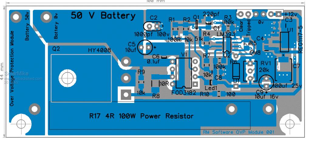

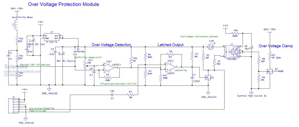

OK, have completed the layout for the Over voltage protection part, made as a plugin board 100mm x 44mm that sits atop the main power board above the mosfets and pickups the main power tracks etc from the mother board.
Have fitted a 100w 4 ohm resistor and a mosfet to sink any current from the capacitors. Obviously we don't want this thing to activate during normal operation as something will melt, can test fully it by not plugging in the opto-coupler.
One issue I have is its manually setup (RV1), so the charger cannot automatically set it for different voltage battery banks, can live with this, never use less than 48v anyway.
Due to the generic nature of the board, will use it in other projects, can get on with the changes to the main power board now... many alterations.

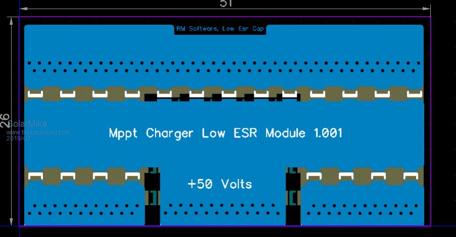

Decided to add a small pcb containing 30 or so 1uf 250v ceramic caps parallel with the main output electro's. Originally they were to be mounted under the main pcb in a line across the power rails. This pcb sits between the main caps and soldered to the top tracks.
Reason for doing this is its not unknown for these types of cap to go short circuit, even if correctly rated, being effectively across the battery, will draw lots of current carbonizing the pcb and effectively destroying the board in the process. Placing them on a separate pcb makes repair easier.

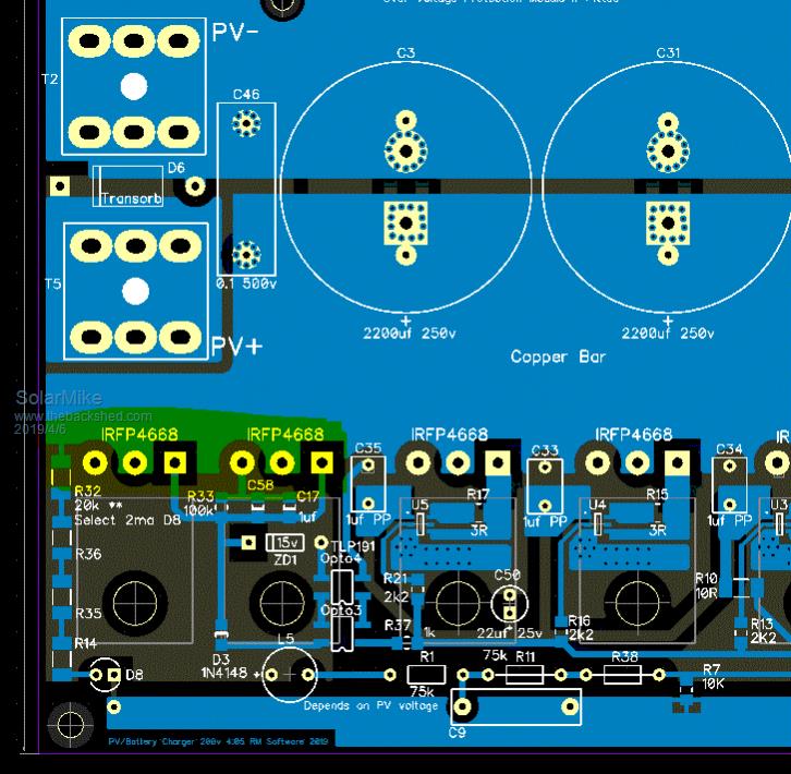

On the PCB I can't locate the MOSFET that will play the role of the PV isolator.
Have you abandoned having an isolator MOSFET after adding in the ACS770? Would the ACS detect reverse current and shut down the system after sunset, thus making the isolator redundant?

No this part of the circuit hasn't changed, the 2 parallel IRFP4668 mosfets are switched by opto-couplers that output a DC voltage, see the highlighted (yellow).
The whole pcb is being re-designed; the PWM driver and associated components have been moved from the CPU board to the power unit, to better allow easier connection for other CPU types. see part pcb below.
The ACS770 output is passed to the CPU board where any decisions are made to shut down or isolate the PV array from battery.

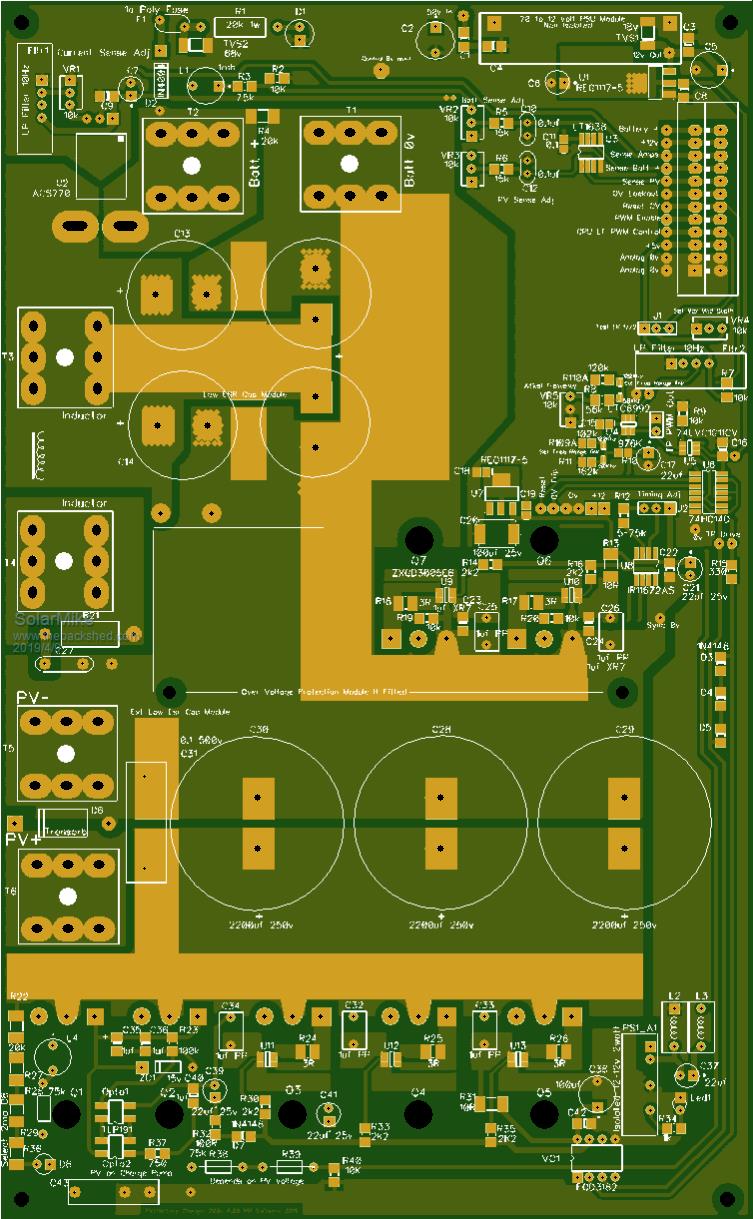

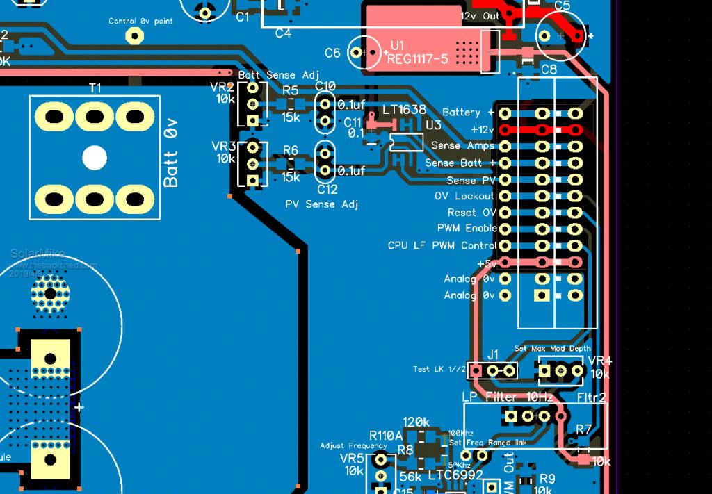

Onward, its been a bit of work to modify the main power board, have added a HF modulator and associated components to easily allow full mppt control by an add on CPU board.
Ready to send off to get test boards. Final size is 243 x 150mm, have widened some of the main current tracks to allow use of 1oz copper.
CPU Control Required via spring terminal header:
Top:
Bottom:
