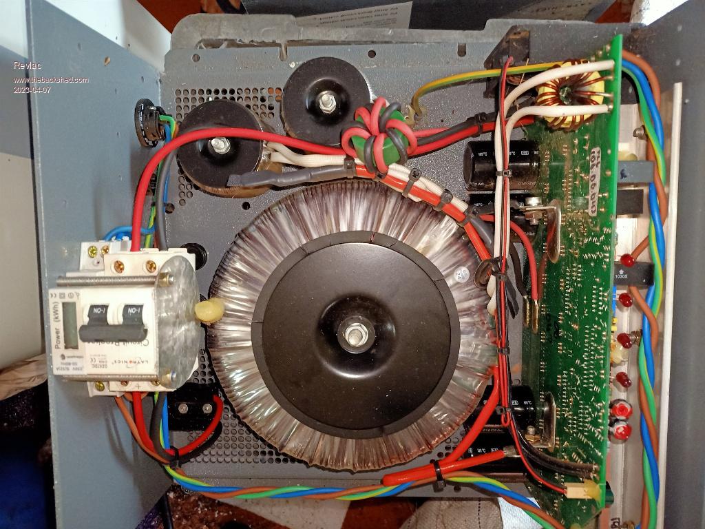

A friend dropped in this morning and left this Latronics 2.5Kw Grid Inverter, Not sure what he wants to do with it yet.
Had to have a look inside, looks like a good quality unit, It looks like the primary and secondary are wound together (not sure) anyone used these?

I have a 2.3 kilowatt 24 volt Latronics inverter that runs our house. It has been very reliable and it runs very quiet. So pretty happy with it.
My shed runs on an 8010 based inverter with a rewound powerjack (8kw) transformer, if powerjack say 8kw I take that to be the maximum it can run at for a very short time, so mine is thought of as a 2.5 kw max inverter.

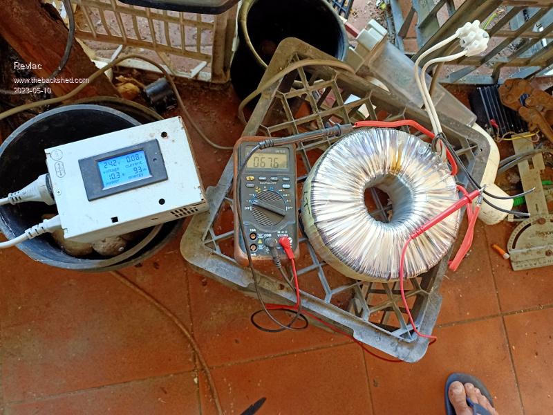

Taken this latronics apart (as its no longer going to be used for its intended purpose) and the 2 chokes a connected in series, didn't see it properly when it was all zip tied together.
Tested,
2 together was 1.689mH
Taken apart they are 950uH and 1031uH
I tested them several times with the elcheapo meter, numbers come fairly close each time, seen as these chokes where on a 60volt winding and unknown running frequency, they will be stripped apart and rewound as they are not even close to what we need for these inverter builds.
On to something a little more interesting....or not....The auxiliary winding is about 20Vac and the Primary winding was 65Vac, (will need rewinding anyway).
Did the usual 240v power test and The idel consumption is 10w, I was expecting about half that for a transformer of this size and quality, will need a few more turns wound on.
Toroid measures 190mm wide.

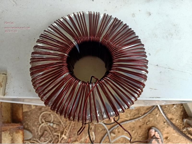

Haven't had much time to work on this, but made a start the other day unwrapping the plastic exposing the 65v primary winding, now the primary winding (RED covered wires) looked like 2 in hand and I thought, great this should take less time to to unwind.......well I was wrong,  it was 2 layers for each winding at 90 turns each wire.
Just thought I would document this in case someone else tries, its good clean wire.
1 winding removed already, Once the other one comes off I will wind a few more turns onto the secondary 230v winding to lower the idle current a little more, depending on what sort of wire I find.
Ha, been there, done that . A tip: The two in hand machine wound windings had overlapped turns at the Latronics transformer I unwound.
Problem with that is if the wrong 'hand' is being unwound first, one gets caught by the trapped wire and has to start unwinding the other 'hand'.
Things can quickly get messy then  but it was good, re useable wire I got in the end.

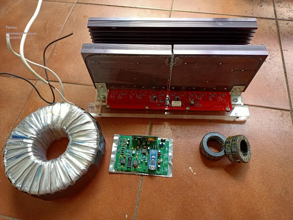

Made some progress, heatsinks made and drilled, still need to tap the threads but 4 are done already, all the board and heatsinks are mounted solid so nothing will get out shape.
The toroid has a few more turns added and the Mylar tape wound back on, I saved all the tape and found it a bit crappy to use so I tried to straighten it out with the heatgun and it worked a treat, most of the crinkle come out, surprising how much heat it can take, it was nice and easy to handle after that treatment.
Wound the Mylar tape back over the winding then went over all of it with the heatgun again and the Mylar tape settled in firm around the copper wire, works very well.
Still need to wind the primary (have to find some first) on the Toroidal and dig up a few more choke cores, will be using the picoverter control board on this build, need to test this and another one to make sure everything is working.

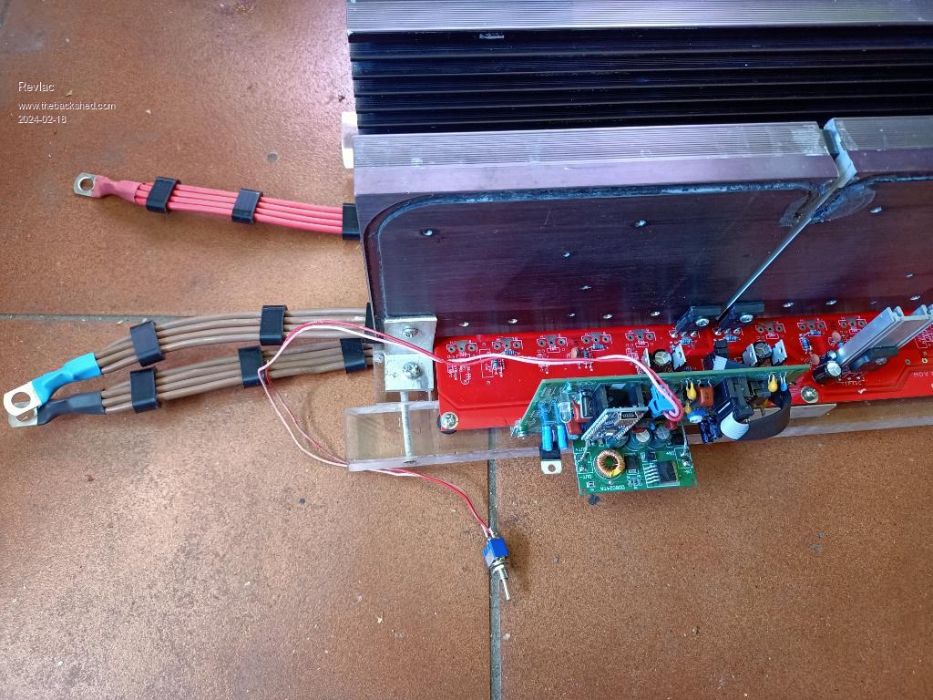

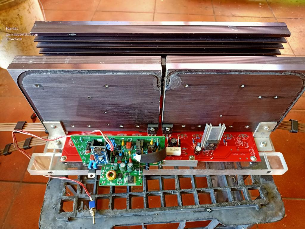

Getting closer to testing this one, mounted the control board, should be ok there, the wires are attached to the power board and not the heat sink this time.
Using 4 wires could get a bit messy so thought I would try to tidy them up a bit and make them look flat using some 3D printed cable management, because I can.

that's looking good.
Posted: 04:05am
19 Feb 2024
Murphy's friend
Hopefully you remember to sand off that black anodising where the mosfets mount. If I remember correctly that 3 heatsink design has the drain connection via the heatsink?
Posted: 10:32am
19 Feb 2024
Revlac
Thanks.
The wires are connected to the power board so the heatsink doesn't have to be live or wired, But Yes its definitely worth pointing that out so others can get it right.
In my case I have drilled our the holes in the fets to 4mm and taped the heatsink accordingly, after attaching the fets I Checked the positive heatsink and centre leg of the fets with a meter and found there was no contact, because of a bur left from tapping the thread, after knocking it down with a countersink its all good.
I might even put some sill pads or thermal paste behind the fets on this one as I don't need live heatsink's this time.
