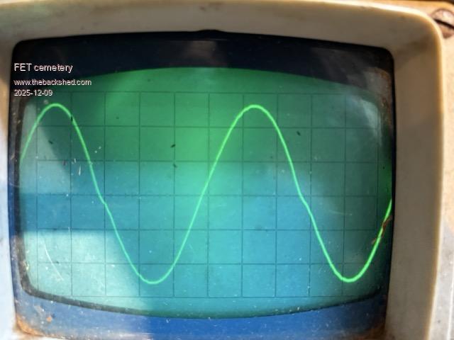

Well it's taken ages, other stuff gets in the way, but the inverter is finally up and running. Not complete mind you, there's some tidying up to do, ok there's a lot of tidying up to do (the toroid is still not in the case, fans are switched manually) but it's running.
I am seriously impressed, this is a properly powerful machine. At 3.6kW it barely gets warm with no fans. Charging the car at 5.7kW, again with no fans, the heatsink gets warm and the pcb slightly warmer, not more than about 20C above ambient.
Turning the fans on, the heatsink runs cold with minimal airflow and the pcb is a bit warm.
The toroid seems to run cooler than with the egs002/powerjack board at the same output, 3.6kW doesn't need a fan and anything more needs minimal airflow to keep things cool.
A couple of questions-

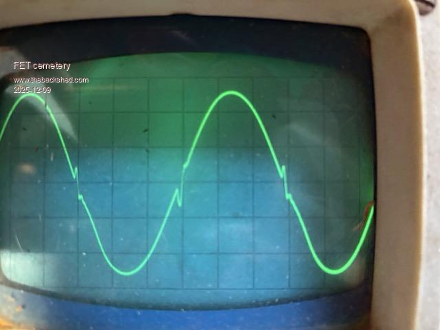

At idle, pwm is 68% (54V in). I have to run at 5.7kW and let the battery drop to 47V (something that would never happen normally) to get pwm up to 85 or 86%. Would losing a turn off the 12 turn primary be a good idea?
There's quite a buzz/hum from the transformer when charging the car, regardless of the charge current. This was the case with the powerjack board as well. On the scope the output looks interesting:
This was at 5.7kW, it doesn't look much different at 1.5kW.
For comparison, this is the inverter running 1.5kW into a old box-in-the-wall induction motor aircon:
I don't think there's anything wrong with the inverter, I suspect it's an interaction between the car's internal charger and the big toroid.
I'm picturing some sort of big switchmode supply that abruptly stops drawing current just before the zero crossing, with the spike in the waveform being the toroid reacting to that. Could be completely wrong, interested in what others think.
Does this matter, and can anything be done about it?

That distortion is likely the Car charger, the only thing it causes is a buzz in the Toroid.
I monitor some horrible loads via the two Peak DC input current meters and the DSO, there has been no increases in input current with loads far worse.
IMHO 68% is on the low side, checking with an input turn removed might be a good idea, as the FETS work harder with a low duty cycle and high power, mine is around 73% at idle, and I think I should remove a turn as well, but it's working perfectly so maybe in the future.
I've often running at over 14kW and the SPWM is around 88% from memory.
