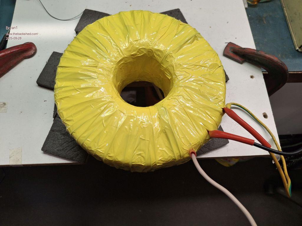

           This morning we reversed the connection on the 16 turn winding and ran the same tests. Roger had setup a power meter so we could get the true idle watts and man were we surprised on average 10 watts idle power
We did some tests with more turns for very little gain so stayed with the 16 turns and Roger said he will post the test figures later today which will show that little gain.
I used that Dow Corning yellow tape to isolate the winding and Roger did a search for this tape where the price was over $50 a roll   So I am glad I did save that box of the tape.

  wiseguy said  Roger, from (fading?) memory I reckon the idling power was between 10 & 13 watts of true power on the 250V windings (with 240V applied). That should give you a ball park figure to work towards.
Thanks Mike, I wasn't sure what was the most important aspect to focus on, other than getting the winding direction correct.
I know it's not the same as the power meter you suggested but it reminded me I have a digital wattmeter, so I figured I'd try that to see how much difference between turns. It actually showed 10.9 watts at 240V with the extra 16 turns, so your memory is still pretty good. Must be that Jacob’s Creek double barrel Shiraz.
I have enough trouble remembering details about the Warpverter toroids and cores, so these Ozinverter formulae leave me floundering even more. I need hours of reading and refreshing my memory to get anywhere. Should have read this whole thread again first.
It all came together well in the end. We just used the other end of the windings, which had gone most of the way around anyway and were quite close to the originals.
So thanks again Mike, Phil and disco4now.

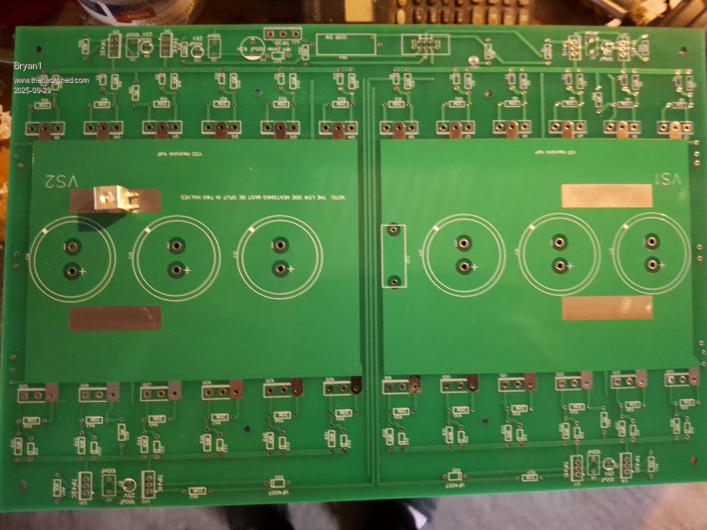

            Well I'm now onto the next stage and after spending hours searching this forum I wasn't able to find any pictures of this board at all
Here is a pic of a blank board with one of my 4mm connectors where I bent the legs 90 degrees so they sit on the pads nicely. Now once I do get the cable tightened on the post I reckon soldering it will ensure a solid connection.
Now we have 2 pads on VS1 and VS2 so is only one pad on each needed or both ?

Toroid looks good Bryan,
If you were going to use a lot of power, probably use both pads, Think one pad will handle a fair bit anyway, be good to check if you have enough Clarence between that 4mm standoff connector and the heat sink, I have a narrow heatsink, just checked, I could almost get access to that terminal screw  after the heatsink is on, with a thicker heatsink there will be no access to the terminal to attach a cable.
There is a few other ideas to approach this, I will see if anyone has some more input later.

Thanks for that input Aaron now I do have a heap of 16sqmm cable here so yea using both pads and 2 16sqmm cables going into one connector to the dual choke like I did with that first inverter.
I do have to get a roll of heatsink to fit that thick copper I pulled off that huge transformer from that battery charger as I annealed it on my crab burner.
Out of the 2 aerosharps I only got one big choke so atleast got one to use and this time I will go with 8 turns each side so the inductance is a tad lower.

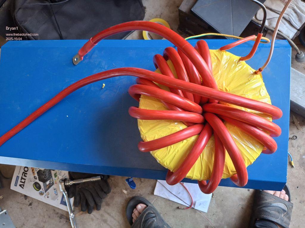

G'Day Guy's, well went to the 12 volt shop this morning and got 6 metres of 65sqmm red cable and just managed to get 15 turns thru which should be enough and I was told the 65sqmm wire was good for just under 300 amps
Next week I will get a roll of heatshrink so I can insulated that 6.2x4 copper wire so I can make the choke.

Looks like it is coming along fine. That is a squeeze fitting in the low voltage winding but it is there, so that is all that counts.

Yes Pete is was fun getting that last turn through and I didn't have enough for another turn either as that 6 metre figure I quoted was just right for 15 turns but at $25 a metre no wastage so I'm pretty happy. got them to put one terminal on the cable and after the trial fit I may go back with the toroid to get the other end crimped as they do a nice job.

Hi Bryan the exorbitant cost of big battery cable is probably why manufacturers just use multiple strands of magnet wire for the low voltage windings.
Also without the thick pvc insulation the magnet wire dumps heat better.
$25 a metre is a lot, lucky you didn't need much.
good luck with the rest of the build.
if you lived close i could crimp the lugs for you, I have a 16 tonne crimper that can crimp up to 350 mm squared cable.

Just thinking that 14 turns might be closer to what's needed for 24v?
But at least you know 14T will fit: a lot easier than trying to get an extra turn in
Glad to see it coming along ( I must get back to my transformer wind sometime...)

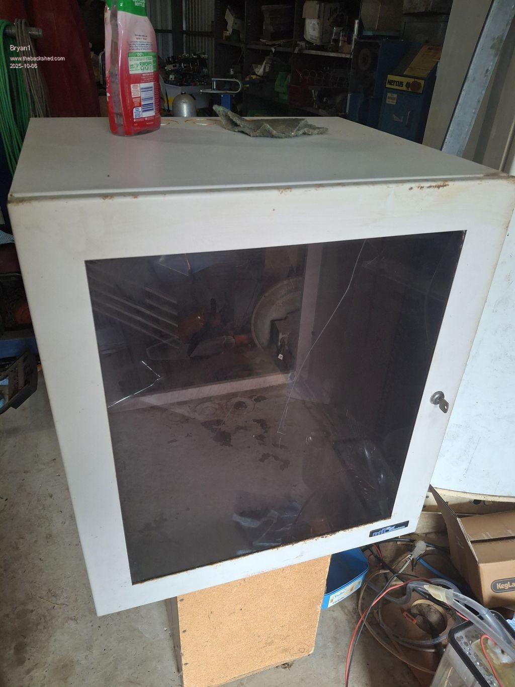

Morning Guy's well had a bit of cleanup and got that rack case out   it measures 535x600x450mm so plenty of room to fit everything. This case has sat in the corner for over 20 years and has finally found a use.
Still need to close in the back of the case and make some shelves and it does have vents top and bottom on both sides which will allow for efficient cooling.
I do need to move my Kipoint inverter to the lower shelf so the rack case can sit ontop
So still plenty of work to do to get this all done and the plan is get it done so when those blue toroids for the chokes turn up it's all ready to assemble.
