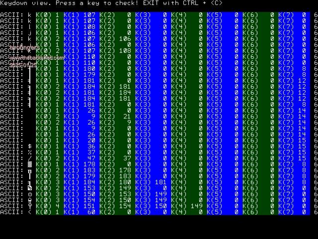

Posted: 04:01pm
24 Jan 2025
twofingers
@John
I think this is a better attempt to show the different return values ​​for different keyboards.
'* Keydown-view to show all keydown codes
'* From manual:
'* KEYDOWN(0)    = number of keys being pressed
'* KEYDOWN(1)-(6)= decimal ASCII value of the USB keyboard key
'* KEYDOWN(7)    = will give any modifier keys that are pressed
'* lalt = 1, lctrl = 2, lgui = 4, lshift = 8,
'* ralt = 16,rctrl = 32, rgui = 64, rshift = 128,
'* Last column: KEYDOWN(8)=status of the lock keys
'* caps_lock = 1, num_lock = 2, scroll_lock = 4
MODE 1
CLS
Dim key$
Dim integer i,pp,FW=MM.Info(fontwidth)
CLS
Print "Keydown view. Press a key to check! EXIT with CTRL + <C>"
Print
Do :Key$=Inkey$:Loop While Key$=""
If key$<" " Then key$=""
pp=9
Print "ASCII: ";key$;@(pp*FW);
For i= 0 To 7
  Inc pp,9-(i<1)*2
  Color RGB(white),255<<7 Or 255 * Not(i Mod 2)
  Print "K(";Str$(i,1);")";
  Select Case i
    Case 0
      Print KeyDown(i);" ";
    Case <7
      Print Str$(KeyDown(i),4);" ";
    Case 7
      Color RGB(white),0
      Print KeyDown(8);
  End Select
  Print @(pp*fw);
Next
Print
End
Kind regards
Michael
