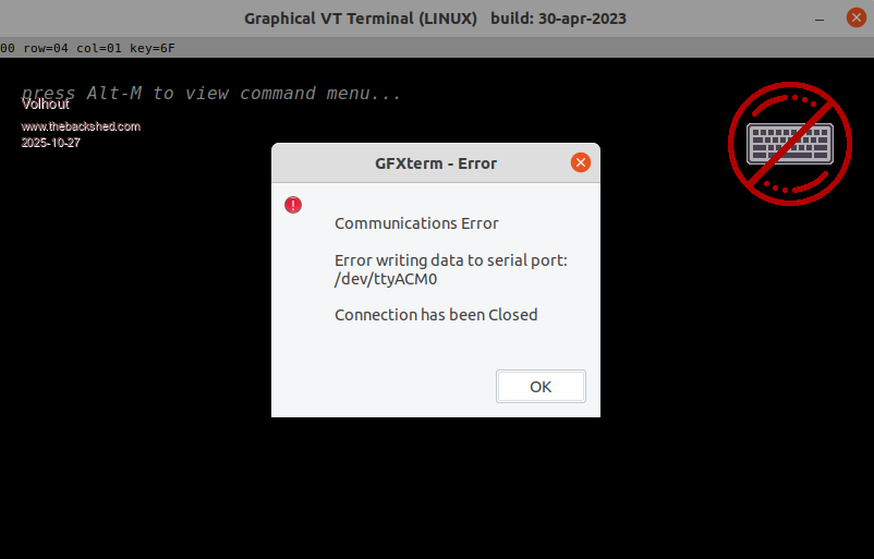

Posted: 03:52pm
26 Oct 2025
GFXterm64 (2023 build) gives some feedback when trying to use the console.

Posted: 03:57pm
26 Oct 2025
No change on both Putty and GFXterm64.
P.S. Don't put the blame on Linux, up to RC7 worked fine. You changed something that broke compatibility I guess. I checked RTS/CTS handshake is off, XON/XOFF handshake is off.
Edited 2025-10-27 02:02 by Volhout

Peter,
FWIW: Also tried MMCC, same behaviour. Noticed something that may be related. When trying to close the application (Putty/MMCC/GFXterm) linux refuses to close the application immediately (maybe because there is something in the USB TX buffer still) regardless if you typed a character or not.
When you don't type, the TX buffer should be empty right ? So maybe some character is send in Linux opening the serial connection, that is not sent in Win. And that character upsets the pico.

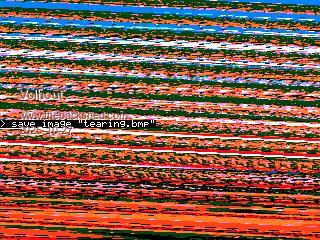

@Peter,
About JPG dithering. Something has changed when JPG size is larger than screen.
With RC7 you would just show top left part of the JPG that fit's the screen resolution.
With the change for dithering, when the JPG dimension is larger that screen (regardless the dither setting -1,0,1,2,3) you see a striped screen. As if the JPG decoding continues on the next pixel line after a screen wrap.
If you need a picture, I can provide.
When  the JPG is exactly 320x240 the dithering works fine.
