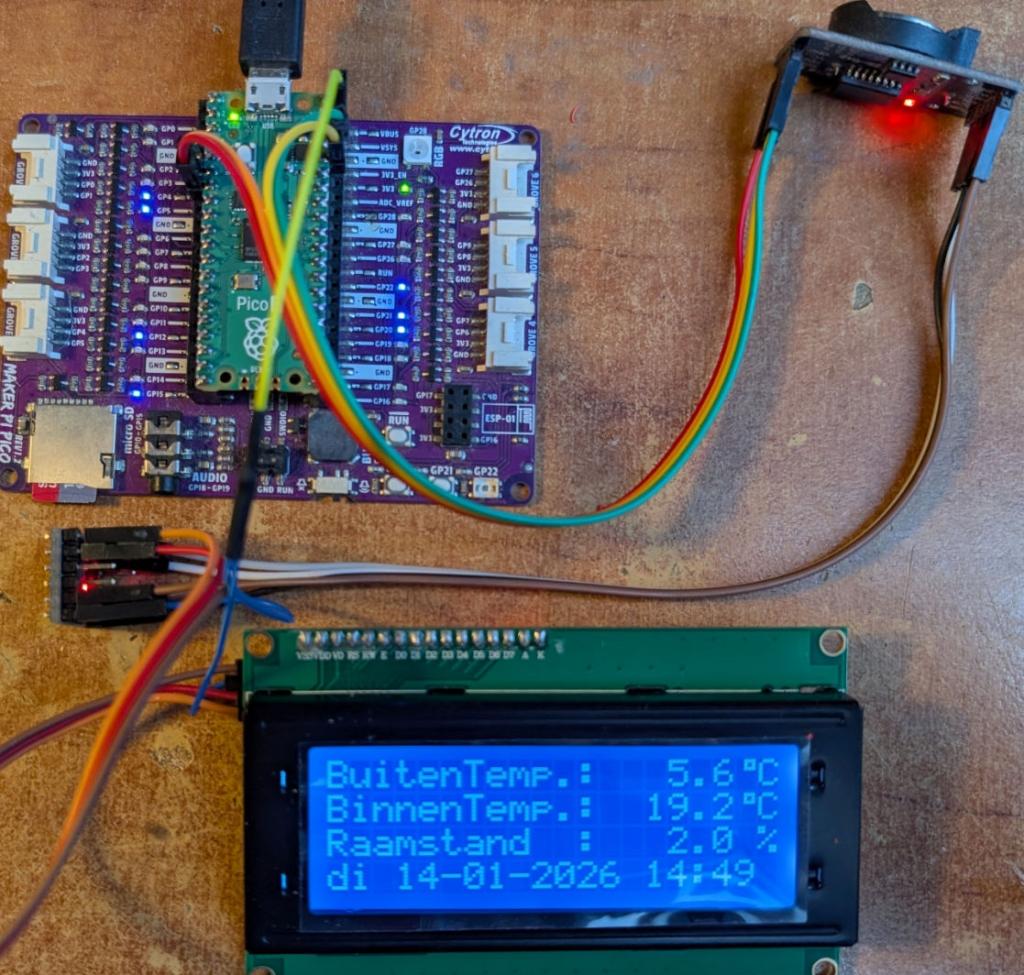

Peter and Harm,
I've done some more research since my last post.
The RP2350A is a model with 16MB flash. I did a fash_nuke yesterday, and the firmware ran for 1.5 hours without any problems.
This morning I set the autorun option to on, after which I had some startup problems, such as the backlight going off. Then I set the pause time from 500ms -> 5000ms, and it's been running for 1.5 hours without any problems so far.
I just downloaded the latest RP2350 update (picomite.zip) and it's now up and running. I do indeed see an "r" appear on my TeraTerm console screen every minute. It's also working fine on the LCD2004 screen.
I'm using a MAKER PI PICO with the RP2350A module. On the right side, I've mounted a 4x20 LCD2004 screen on nylon bushings, and on the bottom of the LCD, I've installed a standard I2C to parallel module for these screens.
I solved the 5V bus problem by using 2x4k7 pullups from 5V to 3V3.
Underneath the MAKER PI PICO is a DS3231 module with EEPROM, all on the same bus. Because the 4k7 resistors are in parallel, the resistance is already lower.
Ten years ago, I created a greenhouse controller for a hobby greenhouse with various sensors using an Arduino nano and BascomAVR, which has always worked without any problems.
Last year, I had some problems with the 24V power supply, and now I've made everything 5V, and the rain sensor is showing signs of wear on the sensor surface.
I'm trying to get this controller, using the same sensors, to work with the PicoMite as well. The controls are operated using three keys: UP, DOWN, and ENT, and sensors include two DS18b20 sensors, a 10K window potentiometer, and a rain sensor. All 22 settings were then written to the EEPROM in the nano.
Now that I'm typing this, I get a message on the terminal.
> run
rrrrrrrrrrrrrrrrrrrrrrrrError: Invalid address - resetting
> rrrr
The program is still running because the r's are being filled in, but the time on my LCD2004 has stopped. (18 r's already added)
So the problem is with the I2C connection/software?

Your code ran all night for me without a display connected (standard Pico2) which suggests to me something electrical may be at play. Are you running the I2C bus at 5V? Will the display run at 3.3V. If it will try everything at 3.3V. Have you disabled the LEDs on the Maker Pi (unsolder jp13)?
  Quote  I solved the 5V bus problem by using 2x4k7 pullups from 5V to 3V3.
This feels instinctively wrong but....
More thoughts. If the display will only run at 5V uses a level changer. You do know that the RP2350 is only 5V tolerant when powered? DO NOT power the display without the RP2350 also powered if using 5V

Peter,
The I2C runs on 3V3. The DS3231 already runs on 3V3 by default, and the display receives its 5V supply via a separate PCB.
The bus board on the back of the LCD normally operated at 5V with pull-ups SDA and SCL to 5V. I desoldered these two SMD resistors, connecting the SDA to 3V3 and the SCL to 3V3. (Could it be that the pull-up SMD resistors were removed because the RTC already has pull-up resistors?)
These resistors are also in parallel on the DS3231. I made a modification on the MAKER PI PICO.
I cut the path that powers the LEDs, and on the PCB, I repurposed six unused pins that I don't use.
I cut the SWCLK track, and connected the pin to one of the positive pins on the LEDs. Now I can use a jumper to connect the 3V3 pin to the free pin, or the jumper to a pin that's off.
This has been working without any problems for years. However, I'm using the LCD screen for the first time with an RP2350, and previously with an RP2040.
Is it possible that the pulldown problem with an RP2350 is causing the problem here?
I can try making the pullup values ​​of the sda ​​and scl smaller, so smaller than 4k7 which are on the DS3231 because those of the lcd are no longer present?

@Jan,
PCF8574(A) is 5V I2C (Vh minimum is 3.5V)
PCA8574 can work with both 5V and 3.3V levels at I2C
DS3231 is 3.3V I2C
Pico 2 in essence is 3.3V I2C, but can survive 5V under certain conditions.
I hope you are driving the chips at correct levels. I see in Peter's photo he uses a level shifter between pico and PCF8574. That is correct.
Edited 2026-01-15 01:46 by Volhout

Thanks for all your attention. I first measured the pullup resistor of the SDA and SCL on the connection pins, and it's 4K7.
Then I added a 4K7 pullup to the free SDA and SCL pins of the DS3231. (The value is now 2K4.)
The program started and now works flawlessly on the terminal with rrrrrrrrrr and on the LCD2004.
I still have a few 2-channel I2C level shifters (they have 8 pins), so that's the next step if this test fails.
It's been working flawlessly for over 2.5 hours now.
What is noticeable during autorun is that the program doesn't start automatically the first time, the RTC auto-enable option has disappeared from the list, and the backlight turns off on startup.
Once it's started with the RTC auto-enable option, the backlight works correctly. And regarding the power supply on the PCA8574(A) type, it's 5V. The A type has an extra set of addresses, both of which I have. Only the SDA and SCL are connected externally to a 3V3 pullup.
I'll wait and see about this test.

I2CLCD INIT &H20
I2CLCD 1, C20, "Hello world!"
I2CLCD 4, C20, "Love"
> run
Kind regards,
Jan.

bfwolf
@Peter:
  JanVolk said  bfwolf,
It all works automatically.
Here I'm using a 4x20 screen.
Hi Jan,
The question is whether the (parallel) LCD driver or the I2CLCD driver can automatically know the number of characters per line?
Is it possible that the 16x2 LCDs use the same display RAM configuration as the 20x2 displays, but the last four cells are simply not used?
The HD44780 has display RAM for 80 characters.
This can be used for 80x1, 40x2, or 20x4, or indeed for 24x1, 16x1, or 16x2, etc. There are even 8x2 displays with this controller.
If the driver implicitly assumes that a maximum of 20 characters per line are used in the LCD, it would probably not accept characters 21-24 in the output of a 24x1 display?
Or does it automatically write them to the cells behind them, so that it would work on a 1x24 display and on a 20x2 display there would be a line break in line 2, but on a 16x2 display characters 17-20 might be lost because they are in RAM cells that are not connected to the LCD?
Of course, you can ultimately control everything with 'LCD CMD' and 'LCD DATA', but 'LCD line, pos, text$' might then work incorrectly.
Kind regards, bfwolf
Posted: 10:40am
15 Jan 2026
The HD44780 has effectively 2 * 40 character buffers. All two line displays use the first n characters of each buffer for the two lines.
As per my post, For 4 line displays each 40 character buffer is split
Line 1: Address 0 (0x00)
Line 2: Address 64 (0x40)
Line 3: Address 20 (0x14)
Line 4: Address 84 (0x54)
The only oddity is a display with more than 40 characters in a line in which case the output  is split across the two buffers which are non-contiguous and you would have to code round this.
For 80x2 displays they use two separate controllers.
