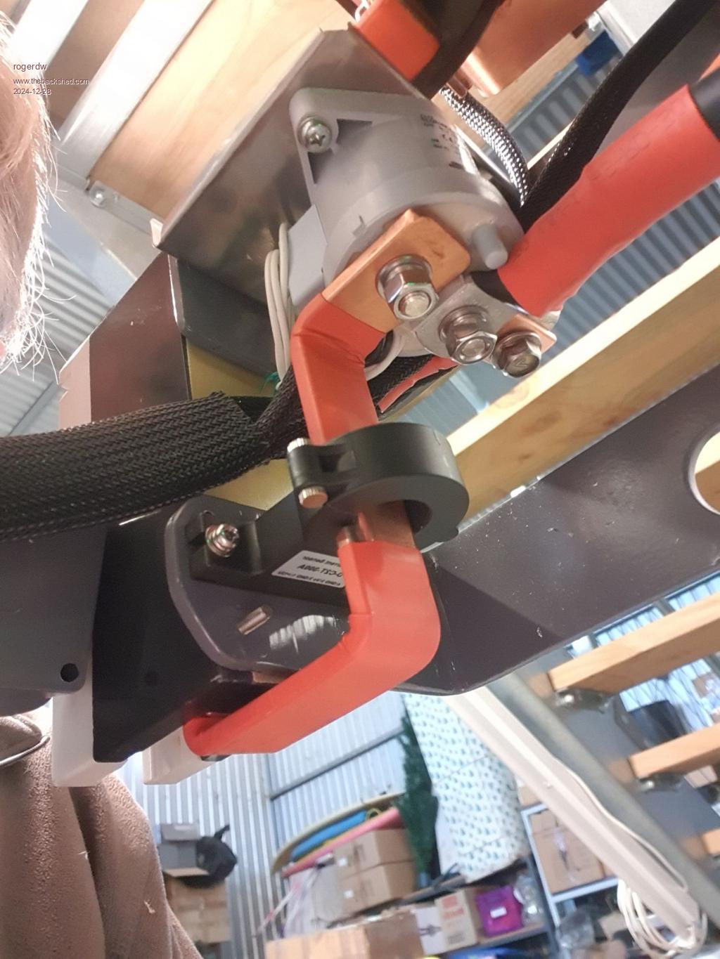

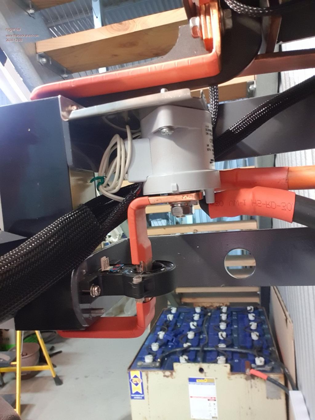

Good to see the progress Aaron.

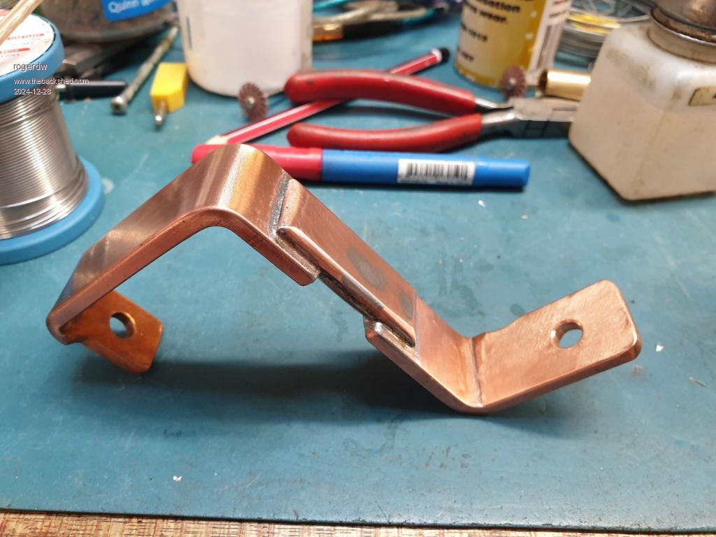

I used copper bar where I could  ...  especially for the short lengths where it would have been hard to get short cables to bend into place.
I do like Phil's idea of stacking strips together  ...  bit easier to handle and flexible.
The battery cable and Solar Charge controller leads come in via cable to the Kilovac  ...  then copper bar to the cct breaker  ...  and from the cct breaker to the main busbar
I got a bit carried away I think.  But it does tuck in nice and neat  ...  and it certainly doesn't get warm.

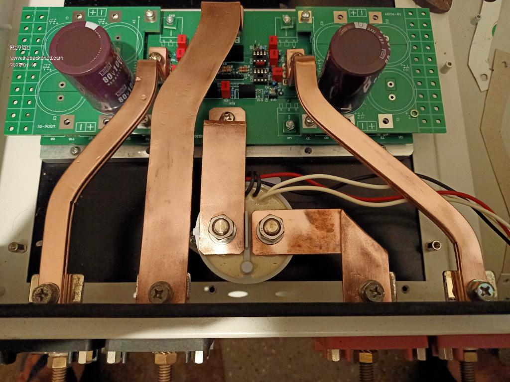

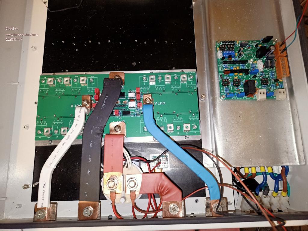

Yeah I would also have preferred multiple layers of copper strip as its flexible, unless someone has soldered the end solid with a hole drilled through (pined) makes it hard to bend and will kink, but looks really good with shrink wrap over it.
I may have some copper sheet in an old transformer but would have to cut into strips, will have a look later.
I will be using the large flexible cable and crimped terminals going out to the chokes and transformer, but inside its such a short distance the copper bar seems to be the easy goto.
That looks Excellent, very neat Rodger,  that's about what I was thinking of, mostly trying to re purpose what I have on hand there is a few different size's of copper bar salvaged from large transformers, there is also a way of getting a 90 degree bend the other way by putting a 45 degree crease and fold over itself, I had success with thin copper like that but have yet to try some of the thicker stuff, will see what happens.
Thanks guys for the encouragement and ideas.

The thick copper bar bends easily with a bench-vise and metal bending adapter, I bent the DC input copper bus bars in the Dual inverter and the main battery bank bus bars with one.

Bending thick copper bar is pretty easy   now using a oxy torch just heat say 10mm each side of the intended bend red hot then let it cool which will anneal the copper making the bend nice and easy. Do it in a vice then by tapping with hammer will work harden it and just rinse and repeat for the other bends.

I'm no metal worker I'm afraid  ...  I just stuck those bits in the vice and wacked them with a big hammer. Wasn't hard to bend either, I was surprised  ...  but I'll keep that suggestion in mind for next time thanks Bryan.

Well it was fun, I have done plenty of metal work, some shrinking and stretching on the 25mm copper bar and it can be bent, the other 2 (transformer bus bars) are 1/2 by 1/8 (really old) imperial copper bar doubled up so its quite thick, still needs a few miner adjustments but should be ok.
Now I have to find the heat shrink, its on a shelf last I saw it.

Great job Aaron, that's coming together nicely. There's something about nicely shaped raw copper that appeals to me.
It always seems such a pity we need to insulate it, and that it goes all tarnished after a while. I'm sure there's a few different clear coatings that would protect it but a thicker heatshrink is still probably more of a protection from accidental shorting.
You must be getting close to fire up time soon.
Posted: 11:24pm
16 Jan 2025
Revlac

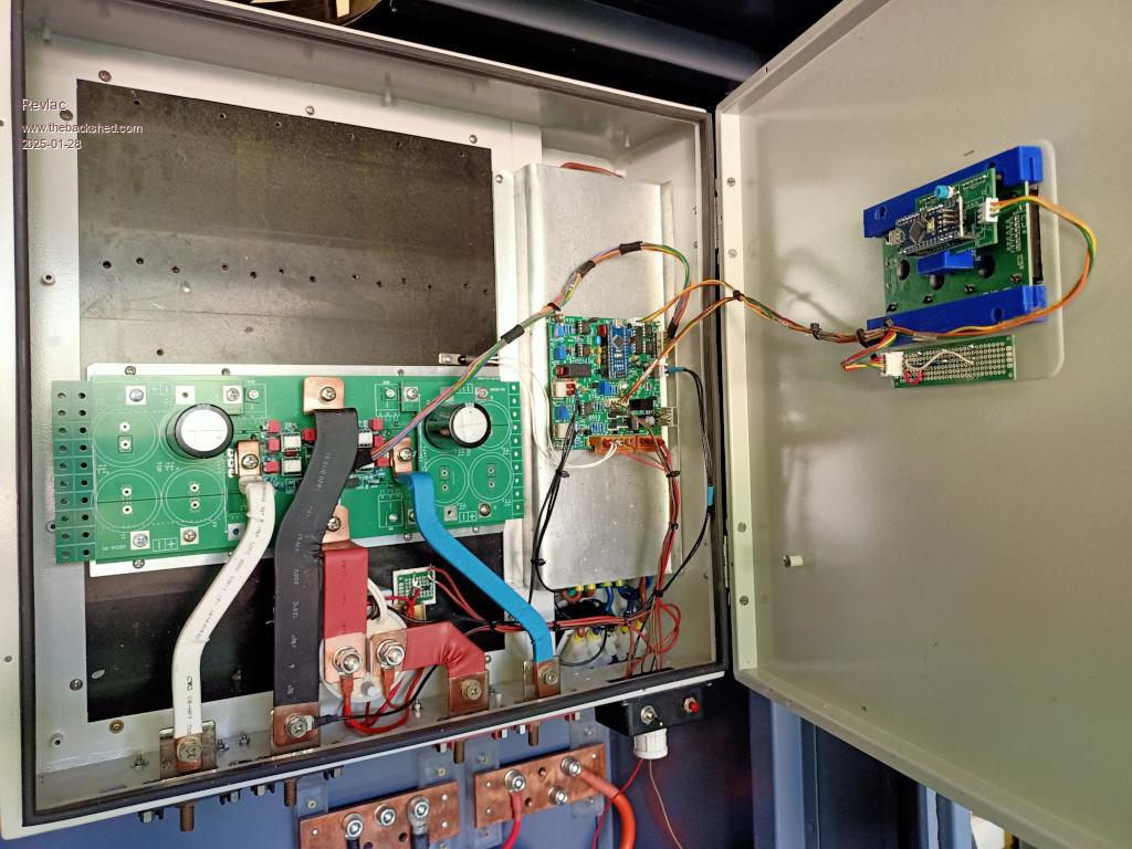

Yes its nice all polished up but doesn't stay that way,  (I have a few old engines that have brass and copper parts looks very nice) I was looking at your build photos last night (very nice) reminded me of the old 300A 3 Phase Breaker panel I have.

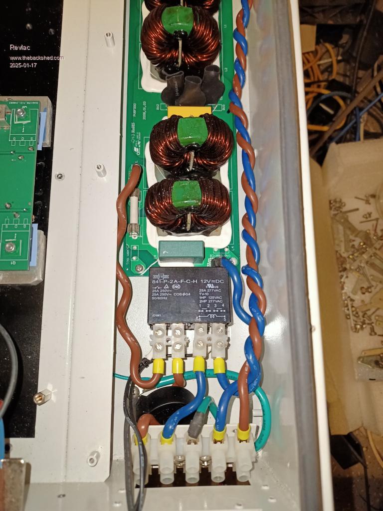

I have the bars covered in heat shrink now and build is progressing nicely when I get time, the filter board is the original GTI but it might be over kill, I could just bridge some of it under board if needed but would like to keep the MOV's in place, must remember to put a screw in there for earth.

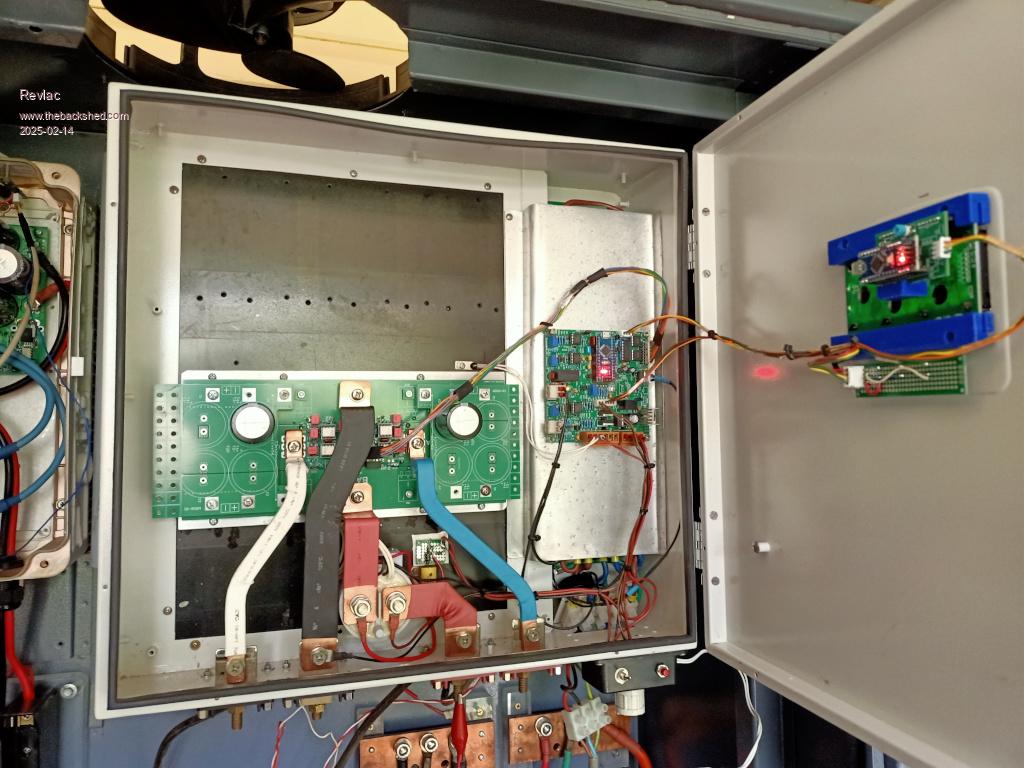

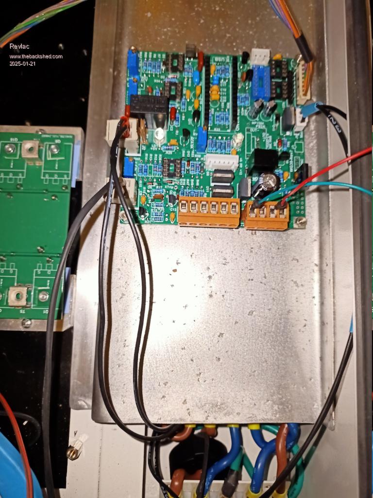

your copper connections look really solid. If I were a one of final MOSFET I would be afraid
If I can make a suggestion at this stage, it is where to place the driver board.
When you place this near cables with high impulse currents flowing, expect noise and interference around that may want to disrupt the operation of your controller - that was my experience.
In my build, noise was causing interference in the AC feedback voltage measurement, which resulted in poor performance of this circuit, AC voltage was dropping too much during when inverter was operating with loads.
Place it further away, or put it in a metal box, and I'm not sure if being close to an EMI filter would also interfere.
Posted: 02:16pm
20 Jan 2025
Revlac
Hi Dex, I remember reading about the noise and interference and thats why I shifted the control board to the side, The plate the control board sits on will be grounded in hope that it works, if not I can add another level of shielding there, Thats part of the fun building this stuff......
Thanks for the reminder.

Yes, I agree with Dex that the location of the driver board is important for good AC voltage regulation - as I found out the hard way .
Another suggestion, rotate the driver board so that the two Op Amps are furthest from the bus bars.
Also, I assume that your enclosure is grounded to the AC mains. I grounded the control board shielding to DC ground, which is *not* connected to AC ground in my inverters.
Posted: 11:08am
21 Jan 2025
Revlac
Yes, I intended to use AC ground, same as most other things are, I still have the option to ground either way or more shielding and rotate the PCB, the 8 pin cable is plenty log enough..... Clockwise 1/4 turn.
Ok, I Rotated the pcb, and I like it better.
Those little stand off bolts on the corners of the PCB are taken from the computer PC Cards, com ports they are a good size but didn't find many nuts to suit the threads on them.

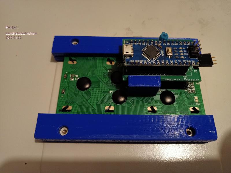

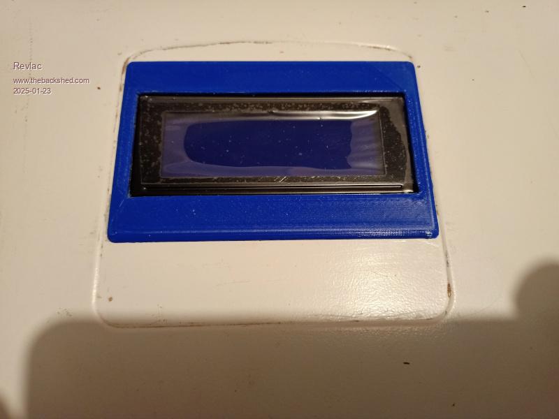

Had to have a little bit of 3D printing in this build......Because I Can........Made it easy to mount the LCD to the existing studs on the front panel, seems to be a firm fit without any screws so far.
Made a bezel around the front screen, it was just a quick rough print using a 0.8mm nozzle in draft mode, pretty rough print as it was good for a design test fit, still have to drill holes for the 3 LED's not sure weather to include them in the bezel under the screen.

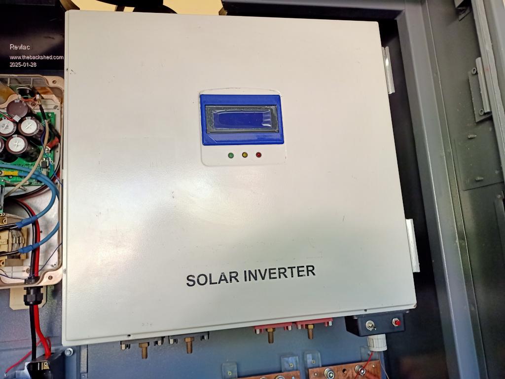

Bit more done, always find a few more things to do each time I check it over, its not far off powering it up on the bench for a check, already powered the board without the IC's in place and the voltage regulators are ok up to 48v (thats the power supply I had) and it needs a final wiring check.
Likely a few other things I haven't done yet, making a wiring harness (cable management) look neat has never been one of my strong points.

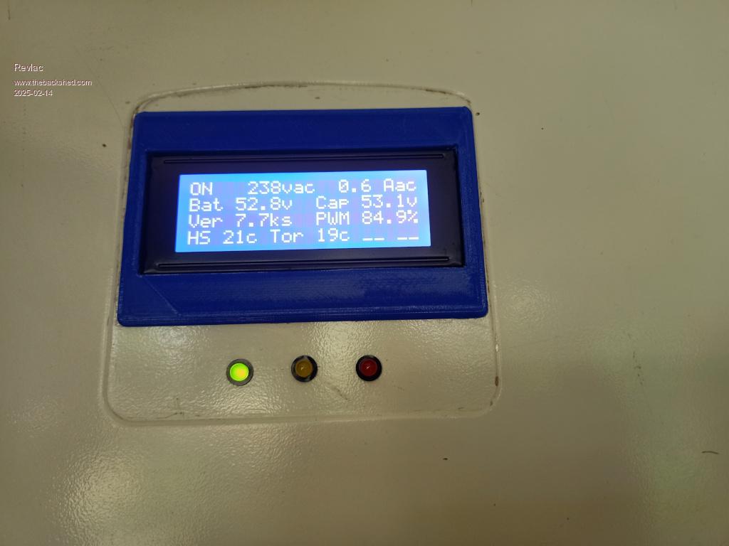

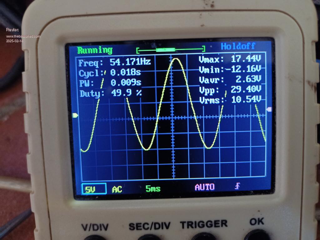

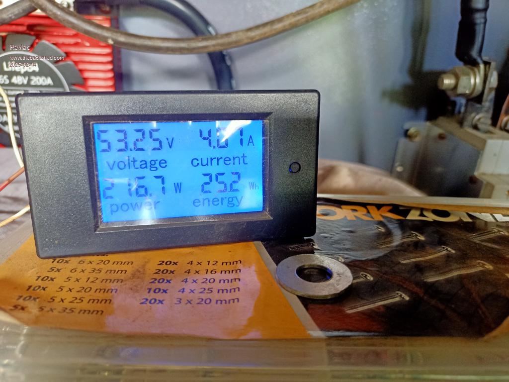

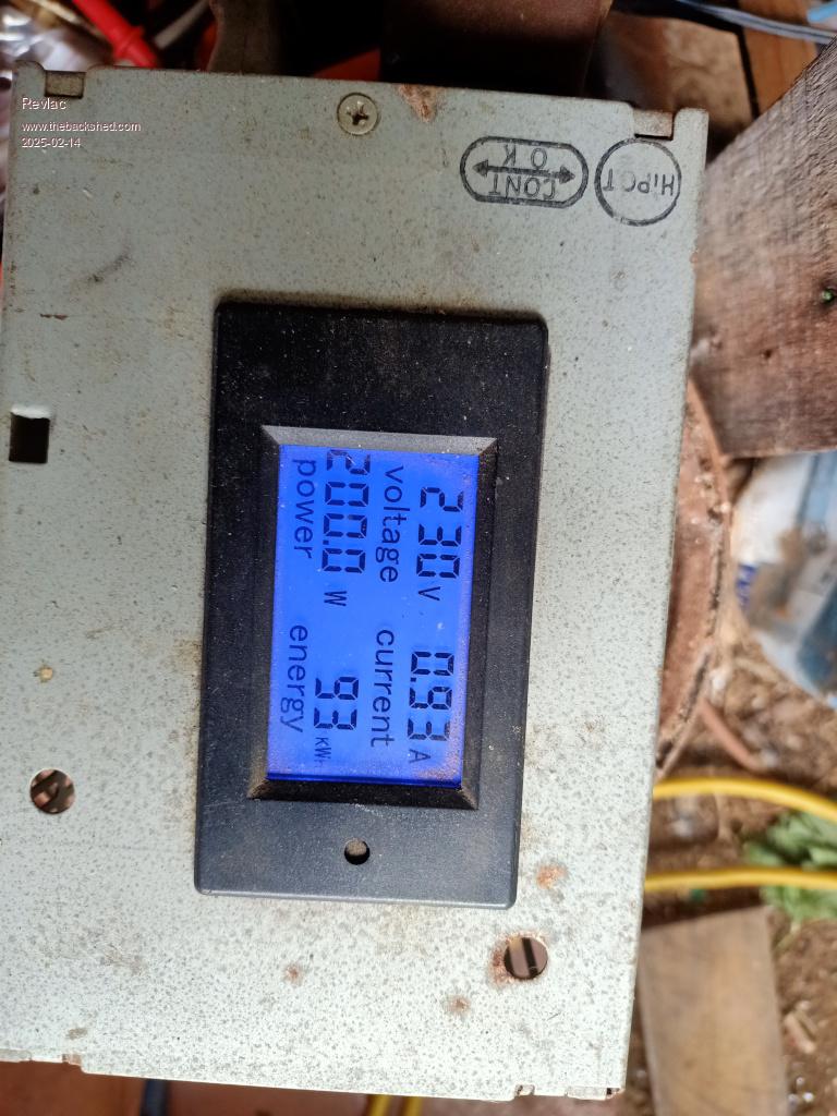

Ok, its fired up and running, I did have the 2 zener diodes (D5 and D6) in backwards......it don't work like that, nothing damaged though.
Only 1 toroid and its temporary wiring till I get the second one in and the some fans and a few other power meters etc, the sinewave is great with a light load 200w running all of today and still running the pair of test caps.
The inverter at idle is about 14w but that will increase when the other toroid is installed, still need to do some calibrations, did a little already but had a few issues with the laptop and the Arduino IDE  not getting along, will try a different terminal later.
There is still one issue to resolve, will figure that out shortly, apart from that, Very pleased with the way its designed and works.
Ignore the 54Hz frequency on the little scope, it often has its own opinion.
