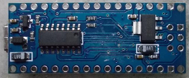

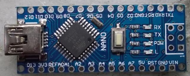

To follow on from the my previous posts for Nano modification to remove the onboard USB controllers ability to interfere with power and reset of the Nano micro, the USB is part of the Nano module, so here is another Nano module that I found in my parts bin.
This one is a 328PB and reports a different ID number even with the PB setting, so AVRdudess reports it as unidentified and won't burn it. You only need select the "Force(-F)" tick box to upload the Code, set fuses etc. This one came with no boot loader. So you would need the little programmer board anyway.
Posted: 09:20am
17 Jun 2024
KeepIS
To end my Nano board roundup, this Nano is well made and works, but has the older (slower) boot loader, it works fine but departs from the standard Nano with the addition of a device in the top LH corner, it may be a voltage reference for the Nano.
There appears to be no way to isolate USB +5V input from Nano +5V, if you wanted to isolate this along with the USB reset, this is not the board to use.
The link to the circuit does not show the extra components, and incorrectly shows a diode linking +5V USB to +5v Nano, this is not the case.
This is only my personal opinion and experience, but I would not put a Nano into an Inverter without USB +5v and Reset input disabled.
I can safely plug and unplug my Laptop into the USB socket with the Inverter running a load. I have a USB skt from the Nano on the side of my Inverter cabinet.
There is now no way a USB connection can interfere with the Nano +5v supply, or cause the Nano to Reset while the inverter is running. The ease of setting up and configuring the Inverter is worth it IMHO.
Without the removal of the Reset pathway, you will reset the Inverter when you use the USB port.
If you think that you can set the inverter up without the Inverter running, then that's fine, and resetting the Nano should not cause any issues with no or little load, I did that when testing the Inverter with over 40 resets, but that was with a small 200W fan as the load and with a current limited supply, which never tripped.
However, I found that in order to fully setup the inverter, and calibrate it accurately, the final adjustments needed to be made with the inverter running and fully warmed up.
Knowing that you can use the USB port and not interfere with the Inverter is reassuring. Without the reset mod, if you forget and plug a PC into the USB port while the Inverter is under a good load, and you are happy to have it reset, then you just might void your warranty
Perhaps I'm just being overly cautious

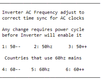

Posted: 06:19am
22 Jun 2024
KeepIS
I decided to add a 60Hz (60.08) option for obvious reasons. I've tested this in the Inverter and obviously all is good, however, if someone uses 60Hz in countries with 50hz equipment, what can I say Some equipment may not be happy.
I have included a new LCD Nano file in the upload, this auto detects the baud rate change when operating at at 60Hz.
These frequencies can vary slightly depending on the Nano xtal, if it's needed I can make just two settings of 50 and 60Hz, each could have a fine +- adjustment.
Any change made in the Menu will not be indicated, and the Controller will not change frequency, until the Inverter has been fully power cycled (no +5v), the LCD will only initiate a baud rate change detect at power-up or reset. Same download link as a few posts back for anyone interested in having a play.
Edited 2024-06-22 19:21 by KeepIS

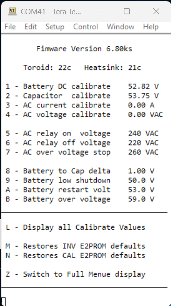

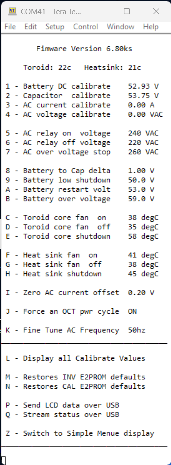

Posted: 05:47am
23 Jun 2024
KeepIS
Well that was easy, simple "very slight" trim of the AC frequency for some equipment that uses AC frequency to sync a timer or clock.
The first menu below is a poor, reduced in size view of the the Full menu, the setting for AC freq is item K
Below that is the menu entry screen when K is selected.
And finally the Compact Menu. Last item Z Switches between compact and Full each time it's selected.
Full:
K selection
Compact Menu:
ver 6.8
Edited 2024-06-24 07:48 by KeepIS

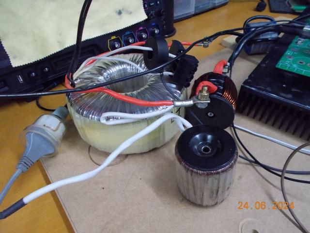

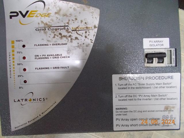

Found this old Latronics PV Inverter, Max PV rating of 100v, Rated at 1.25kW AC.
The toroid is a lot smaller than the Aerosharp, which will be used in a backup inverter.
The toroid connected up to my test bed, it has a separate 19VAC winding and produces 230vac, I just swapped it over with the Aerosharp in the test inverter setup and powered it up.
Idles at 22W and it will be ideal for a wiseguy electronic Variac build that I have planned, it's not that heavy and will make a nice compact Variac, AND cost nothing!
Posted: 06:10am
24 Jun 2024
KeepIS
The choke in the foreground in the previous post was from the PvEdge, it came attached to the toroid, it measured around 1.8 mH which is useless and was not used.
The choke behind it is 43uH, in one side of the spwm drive, this is also too big. I have a 19uh on the other side and complained here a few times about not having any small toriods to make the correct sized 21uH choke.
I stripped the PvEdge choke and it had what had I hoped for, 4 large hole toroid rings, a quick guess of 6 turns resulted in 22uH.
The Aerosharp toroid was not happy with a high 43uh combined with a 19uh for a total of 62uh. I have proven in every inverter I have built that a total of around 41uH preforms best with toroid chokes in these inverters.
The exception was standard inverter 8010 spwm drive boards, these only need one choke. The wiseguy symmetrical drive versions and the Nano need two, use a similar value as one choke but the inductance is divided across two chokes.
What a difference:
The idle current dropped from 22W to 14W, the little toroid is now completely silent instead of a slight buzz. So I also scored the choke toroids I needed for the backup inverter.
This is consistent with the inverters I've built, BTW testing an ferrite E-core wound to 22uH did not improve the inverter and created other issues under load.
Quick 6 turn lash up gave 22uH.
The 43uh choke it replaced (it was all I had at the time)
Edited 2024-06-25 08:05 by KeepIS
