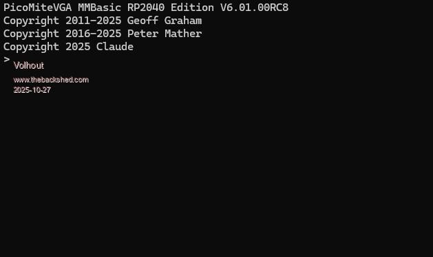

Posted: 10:07am
27 Oct 2025
Hi Peter,
Claude simply needs your supervision to get to great results....
JPG dithering works fine now.
The speed degradation also seems gone (to the same level as RC7).
P.S. the "LOAD DITHERED" is already compatible with "LOAD IMAGE", so it could be removed as a separate command. Just add the extra parameters to LOAD IMAGE.
Edited 2025-10-27 20:26 by Volhout
