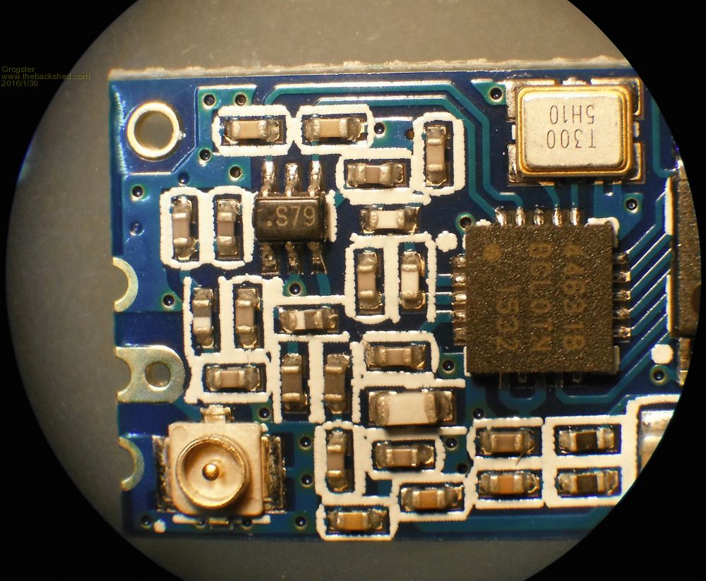

I have finally had a chance to play with these modules, and my initial thought is: "Impressive."
They are dead easy to get working, and the range with default settings and the little spring aerials is also quite good even through walls. Default output power is 100mW though, so I would expect it to have reasonable range with that power, and excellent range line-of-sight with that power. I much like the little micro antenna socket so that you could elect to use an external SMA antenna if you wanted, which should make the performance even better.
Tomorrow, I will do a proper range test walk-around outside, but I already have plans for these little modules, cos the price-vs-power is certainly a sweet-spot.
I will also hook one up to the spectrum analyser, and see what the harmonics are like. The output might be dirty, which would explain the price to some extent, but looking at the module's output stage on the microscope, it would appear they are using some sort of basic RF filtering there. At first glance, and without a schematic to go on...

  Grogster said   I much like the little micro antenna socket so that you could elect to use an external SMA antenna if you wanted, which should make the performance even better.
What kind of socket is that tiny thing? I think it's the same as on my HC-11.

Its a UFL.
You can get UFL to SMA socket leads for around £1 delivered on eBay.

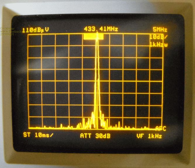

RF output @ 100mW directly into analyser via UFL socket on default frequency:

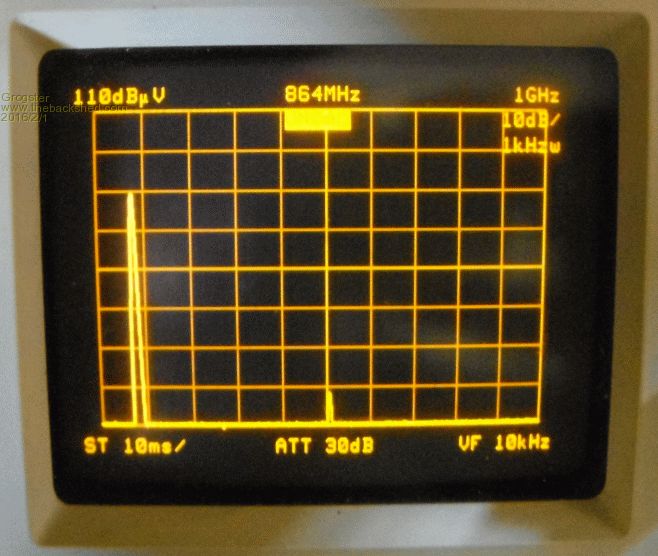

Spectral purity, showing 2nd harmonic - 3rd harmonic is immeasurable:
Considering the price of these units vs the output power, I am actually very surprised at how clean they appear to be in some basic analyser tests.
I am indeed impressed.
2nd harmonic @ 866.8MHz was better then 70dB down on the carrier, and the 3rd harmonic was totally invisible, as you are into floor noise by then - this is very good performance in my humble opinion, and I would happily recommend these modules to a friend.
(EDIT: That should be 1st Harmonic was 70dB down on the carrier, and 2nd and 3rd immeasurable. Excellent, IMHO.)
As mentioned before, this is not exactly a lab-level test, but it does result in some useful information as to what they actually emit onto the spectrum.
...hard to get over the price of the things for the output power - I was SURE they would have a dirty output at that price(cos something has to give, and it's usually the output filtering), but...

G,
You had it right the first time: the second harmonic is 868.8 MHz. The first harmonic is rarely used in conversation, but it refers to the fundamental.

Thanks for that info and thanks for uploading the pics of the module and the spec analyzer screen. I'm going to ask you a question by PM about that measurement.
After seeing it was a U.FL and googling that, I found that it's also known as an IPEX and about 4 other names. The Silicon Labs tech. literature calls it an IPEX. It's actually a patented design first assigned to Hirose, and the US patent expired early because of non-payment of routine maintenance fees.
I would like to find a pigtail to go direct from U.FL to BNC.

  Grogster said   2nd harmonic @ 866.8MHz was better then 70dB down on the carrier, and the 3rd harmonic was totally invisible, as you are into floor noise by then
I've spoken to grogster, and there is just a little mistake here in the magnitude of the 2nd harmonic.
For the record, from the screenshot, 866 MHz is down by a little more than 50 dB.
