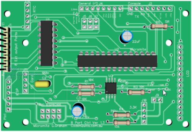

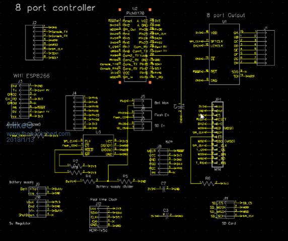

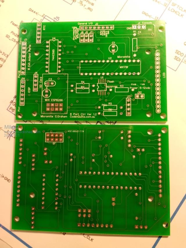

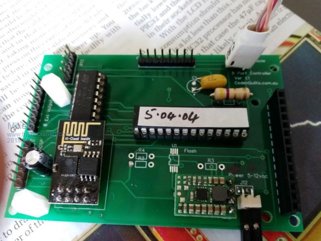

PCBs arrived , built one and tested OK.
Made an error, annoying! , chose the incorrect pattern for the Flash, too small so redid the gerbers , made a couple of position changes and added some more functions.
Added SD Card support from the LCD assy
Added Battery/supply voltage divider to monitor voltage, useful if Solar powered.
Added Link selection for above functions plus the Flash, so can be isolated when not used.
New Layout and new gerbers
Edited by MikeO on 10 January 2018 at 6:02pm

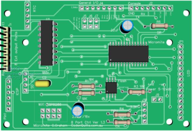

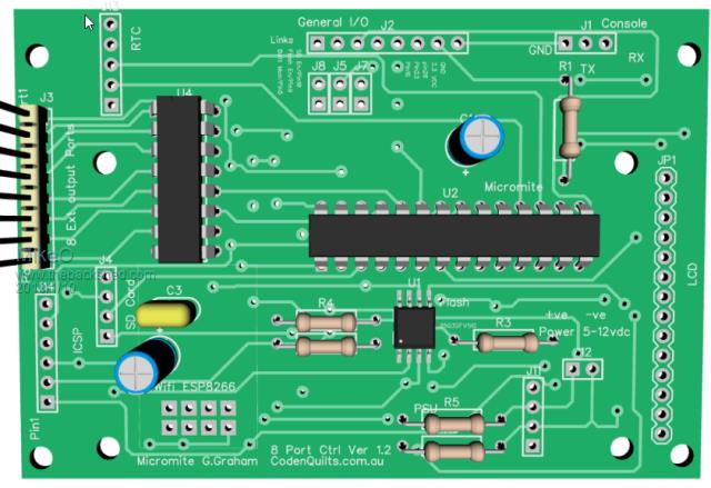

Posted: 13 January 2018 at 7:40pm | IP Logged Quote MikeO
A further update due to discovering a couple of trace errors anyway a further opportunity for an extra.
Console connector (was J1) increased from 3 to 8 pins, used to bring out the SPI and the I2C bus for expansion, now labeled J2.
Made a SOIC version as well as DIP for the MX170.
Version is now 1.3
Mike

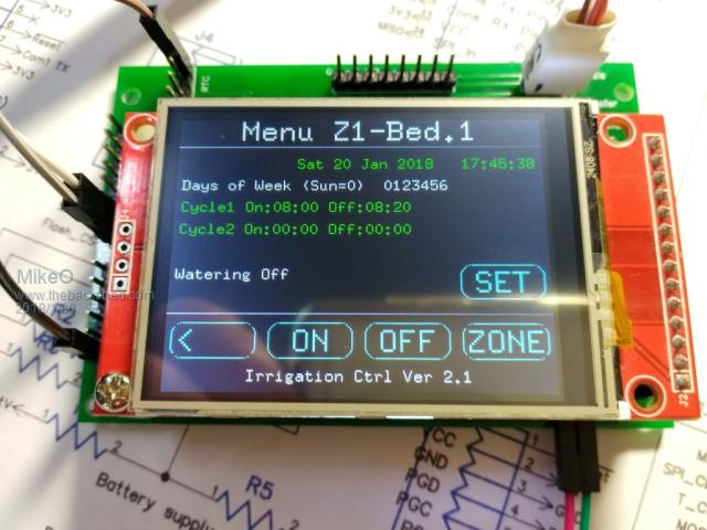

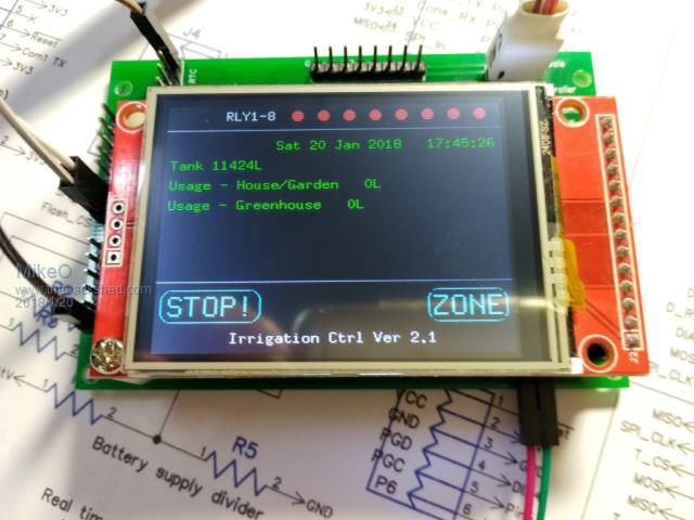

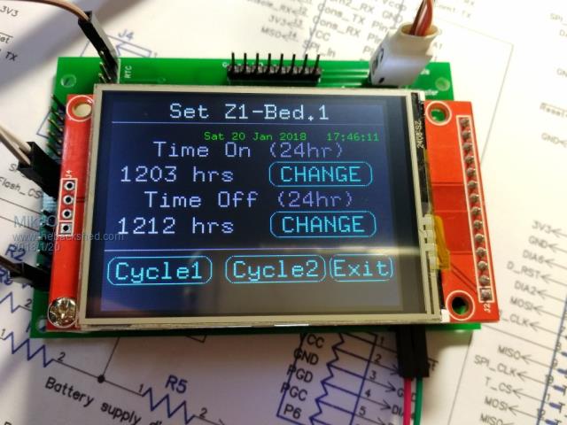

Here is the first completed project for use with the 8 port controller pcb.
I have updated the original Irrigation controller here to use the new board and also made it so it will run optionally in the headless mode (it will detect No Display).
Listing of the main program is below and a complete hex file at the end which include the library and Options setup.
