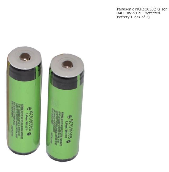

I have protected LI batteries with the protection built in
4 of these

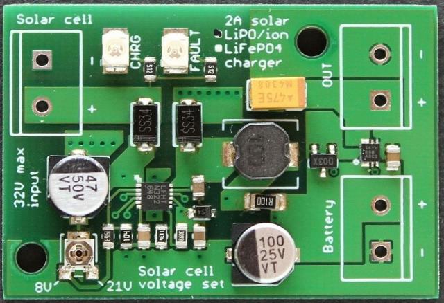

I have a 12V solar charger going into this
The charger part is based on the LT3652 solar charger IC and charges lithium batteries (Li-Po, Li-ion, LiFePO4) at a rate of 1000mA (can be set to 2A max)
Tomorrow when the sun is out I'll measure the current coming from the Solar cells

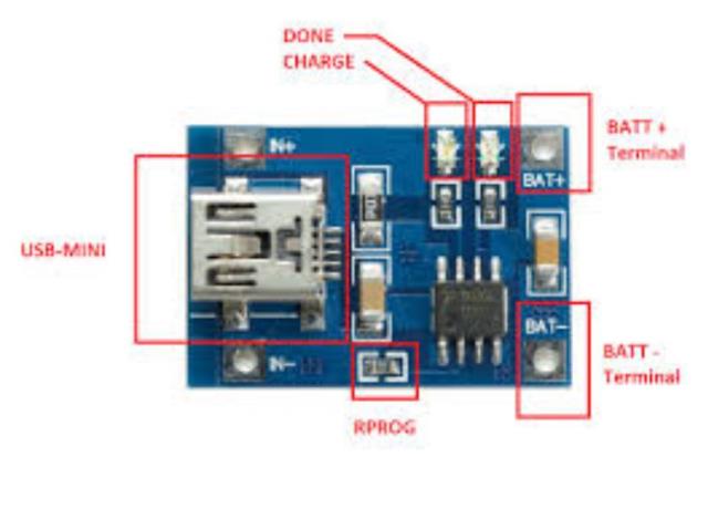

In the summer I was using one of these fev via a 5v regulator to drop the 12V down to 5V
This was working fine during the summer but once autumn came it stopped working, I thought it might be the module so changed it for another and then eventually got the proper solar charging board I'm using now

Your charger has a limit of 1 amp at 4.2 volts
Allowing for losses in the conversion, lets call that 5 watts required.
Your solar panel is 25 watts so even allowing for the London smog, there should be plenty available from your solar panel for a reasonable period of the day.
You need to measure the current coming from the solar panel and the current going into the battery with the load disconnected at (roughly) the same time. Also need the battery terminal voltage.
Measuring the output with the battery disconnected will confuse the controller.
With one amps out of the unit, there should be approximately 300mA coming from the solar panel.
If ned be, discharge the batteries a bit so you should be getting the full one amp charge.
The 14.9V you are seeing will be the 'Maximum Power Point' of the solar panel which is set by the trimpot on the controller. 14.9 sounds about right. The rating plate on the panel will have the correct figure for your panel.
