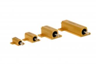

I would use one or more of those "gold" metal clad resistors that can be bolted direct onto your plate.
These can then be switched on or off with a mosfet.
Any one of the switched mode power supply control chips could pwm those mosfets directly. And the error amplifier in the controller connected to a temperature sensor.

I'm now looking at these things on eBay - ceramic heater elements. Perhaps these could be a good solution? 12v operation, cheap, hot only, no cold-sink required. Anyone used or played with these things?

They are a good solution where there is a fan, and you don't want the heating element to burn out if the fan fails. Unless your aluminium plate goes above 80 Celsius they will just act like a normal resistor of the specified power.
If your eggs ever get to 80C, they are not likely to hatch.....!
So I cannot see the point really.
A simple basic resistor would work just as well as a heater as anything else.
Bonding the resistor to the metal plate is the only complication, and those gold resistors solve that problem very simply.

Those gold resistors are expensive . NZ$4 and up each PLUS another $2 for freight for each one! I would need four or five(or more) to get even heat distribution. Using just one(or two) would be pointless, as you would end up with hot-spots where the resistors are, and the rest of the plate gets cold - this is the problem I have now with the resistors clamped to the plate. So I would need to use 6-8(maybe ten) of those gold resistors, and that is starting to get rather expensive compared to other options. You're looking at $40 or so just for the gold resistors, plus another $20 in freight - we're up to sixty bucks just for the resistors so far.
I will have another search on those. Perhaps I was unlucky to strike expensive ones or something, but the other choices just below that listing show similar ratings, and similar prices too!
EDIT: OK, this is interesting. HIGHER power ones are cheaper! I found these when I searched for '50W resistor' - fully expecting them to be almost twice the price of the 30W ones. Weather they are any good is another thing, but perhaps......

If you can scrounge one of those huge heatsinks used on most grid tie inverters, mount that fins up, with a single metal clad resistor bolted underneath.
Eggs on top.... Job done.
