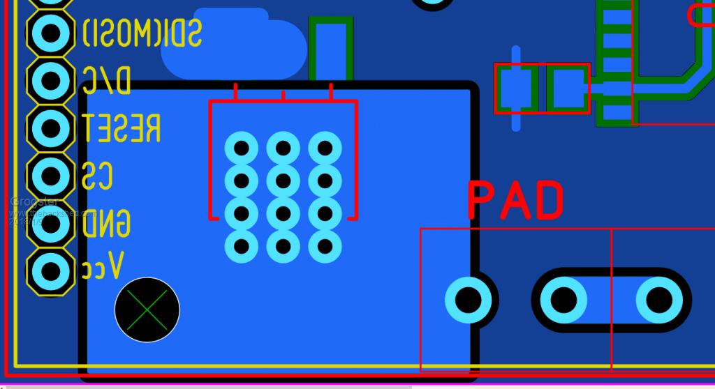

Hi Grogster;
Grogster wrote:
I am planning to use a Fairchild/ON RFD14N05 MOSFET, as I have several of these in stock. 14A S-D current, Vgs(TH) of 2v(so should work well driven directly from a MM 3v3 output), and Rds(ON) of 100 milli-ohms. You can get MOSFETS with better specs then this(specifically the Rds(ON)), but this is what I have, is small, yet can handle the current of the pad no problem. TO252AA SMD package.
P=I2R:
P=4-squared-R
P=4-squared x 0.1
P=1.6 Watts @ 4A load worst-case, so I think this can easily be dissipated within the copper pour with some heat vias to the bottom layer.
Hell, I probably have THAT wrong now!
MOSFET would be a LOW-SIDE switch, with the heating pad between 12v and Drain. Source to Ground. Gate to MM I/O pin.
Do I have that right?
I believe so.
Although it would be prudent to have a 100K gate pulldown and a 1K series to the uMITE pin to protect from charge injection due to the MOSFET Miller capacitance.
I like the RFD14N05. It is one of the standard parts in my junk box.
I measured the RDSon at 64mohm @ 3.3V.
The full on power dissipation would be only about 1 Watt.
This part will have to be insulated from the plate. However, at 1.6W or even 1W, the package would not need a heatsink at all.
Another part, TF2618L in a "Fullpack" insulated package and only 16mohm @ 3.3V.
The full on power dissipation would be only about 0.25 Watts.
And another, IRLI2203N in a "Fullpack" insulated package and only 8mohm @ 3.3V.
The full on power dissipation would be only about 0.125 Watts.
I've a listing of many parts on one of my web pages, see:

@ redrok: I usually just provide a small-ish zone of insulated copper pour on top and bottom layers for heatsinks for these kind of parts.
Thermal vias are filled with solder during assembly, but I doubt I would even need the bottom copper 'heatsink', but if you have room, why not allow for it. I will add a 100k pulldown to the gate, and a 1k series.

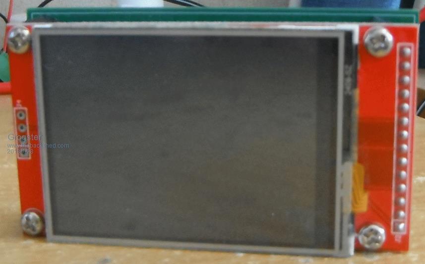

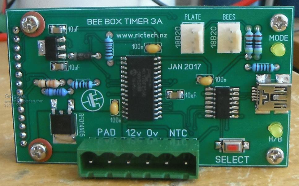

The PCB is designed as a backpack to a 2.8" SPI LCD with touch, so I can add some basic touch controls to the LCD screen. Old design used a red LED display, but the SPI LCD's can be setup however you want - including red 7-segment if I want it.
Pad has NTC, but I have elected to use a couple of 18B20 temperature sensors, as they are much more accurate then a passive NTC would be. I have allowed for connection of the NTC to an ADC pin on the MM2 chip, just in case I elect to use it.

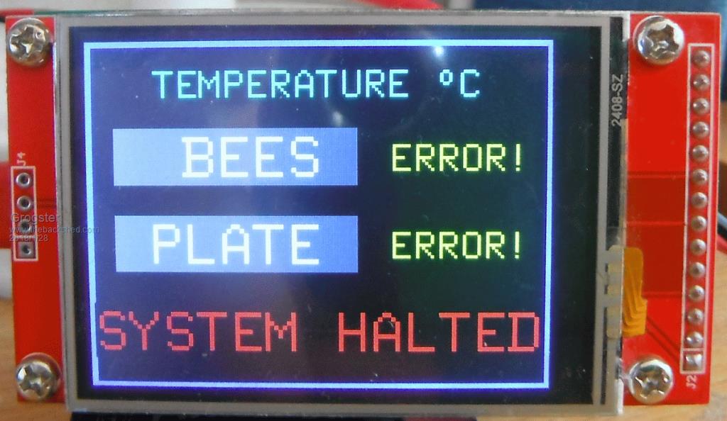

Here are a couple of photos of the assembled unit:
The last image is showing errors for the temperatures, cos I don't have any 18B20 sensors on it just yet, so the code is written to pick up on that and show an error message. The 'SYSTEM HALTED' message in red is actually blinking off and on. I will try to get some sensors on it later and post another image.

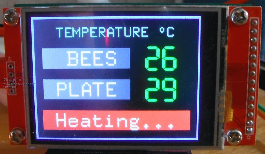

OK, I have hooked up a couple of 18B20 sensors, and this is what it looks like under normal operation:
