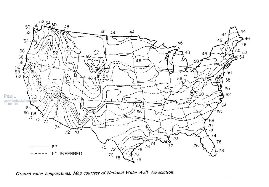

According to some government agency I am located 75 miles north of New York City on the 52F thermocline which means that at a depth of 7 feet the ground temperature varies from 62F in September to 42F in March. That makes it relatively easy to extract heat in the winter and dump heat in the summer.
Paul in NY
