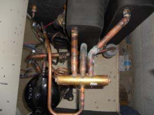

@chronic -- I suppose I could jury rig almost anything, but that's not what I'm trying to do.
I installed this abortion back in 2012 in order to curtail the $10,000 per year cost of fuel oil. It did that admirably well but something, probably too much flux residue left in the system by a really sloppy soldering job by the original assembler, caused it to fail.
Now, 5 years later, I'm interested in even higher efficiency. I'm thinking about larger heat exchangers, variable speed or multiple smaller compressors, and less electric consumption pumping water through needlessly inefficient heat exchangers.
Specifically I'm trying to find out what the efficiency will be for a condenser or evaporator coil immersed in a tank of water which depends on convection to move heat into or out of the coil.
This thing has still been using about 28 MWhr of power a year at a cost of nearly $3400! I should be able to do better than that.
Paul in NY

I doubt flux residue was the problem, more like if the superheat setting was wrong, air conditioning compressors rely on the cool gas coming back from the evaporator for cooling.
To use that amount of electricity this thing must run almost continuously.
You could move to a better climate.
Paul.

@Rob -- right now the temperature here is 8F (-13C). Last week it hit -14F (-25C). My yard slopes upward from my patio by about 23 feet. The cellar floor is 4 feet below the patio. I buried 6000 feet of 3/4" HDPE pipe 7 feet deep in a rectangular grid in a hole 100' x 60' toward the top of the sloped yard. 2" HDPE pipe feeds this rectangular grid of pipes. The pump that pushes water through this heat exchanger at the rate of about 25 gallons per minute is 1/3 HP or about 250 W. A 5F temperature rise at 25 gallons per minute (200 pounds per minute, 12,000 pounds per hour) produces 60,000 BTU/hour which is equivalent to 17.5 KWh per hour. The Freon compressor and pumps consume about 5.2 Kw to produce this 17.5 Kw of heat.
The header tank would probably have to be elevated above the top of the yard exchanger at the top of the slope and would probably freeze solid. The ground freezes to a depth of about 2 feet so the exchanger grid is well below the frozen zone. The exchanger captures low density geothermal heat drifting upward through the crust of the earth from the molten iron core of the earth 100 miles below. The low density of the heat dictates the large surface area of the exchanger but the amount of heat available is enormous.
We used to use a lot of windmills to pump water here. Back in the day of steam railroad locomotives every 50 miles or so across the deserts out west there would be a windmill with a shaft driven pump deep in a well pumping water into a holding tank which would drop water into a locomotive by gravity.

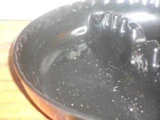

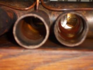

@Paul -- The idiots who assembled this heat pump were slobs. Back in 2013 I had to replace the freon reversing valve which had jammed. Look at this wonderful soldering job they did with the overheated copper turned purple and the excessive flux.
Look inside of the old reversing valve, that white stuff looks like crystallized flux to me.
I shook this white crystalline stuff out of the old reversing valve into an ashtray.
Do you still doubt that flux residue was the problem?
