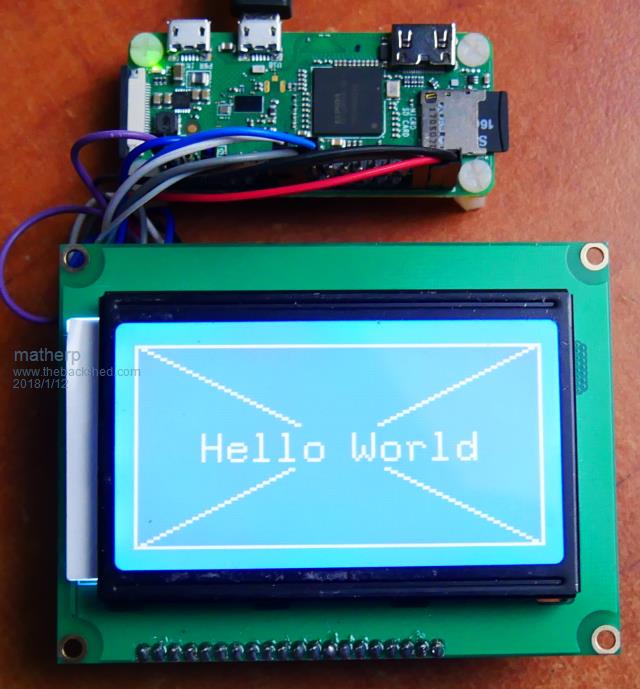

Please find attached V5.04.16
for Stretch
2018-01-12_224620_mmbasicstretch.zip
and for Jessie
2018-01-12_224632_mmbasicjessie.zip
Manual
2018-01-13_192334_Pi-cromite_Manual.pdf
This fixes a bug in the PEEK command and also implements the USER display driver capability of Geoff's version 5.4.09. In addition it includes a new font #7 which is a small 6x8 font ideal for smaller displays. NB the Pi-cromite does not support loadable fonts.
This is a huge advantage on the Pi-cromite where we can't have CFunctions. MMBasic is very fast on the Pi-cromite and drivers in Basic perform well
The picture shows an ST7920 based 128x64 display (QC12864B) being driven by a SPI user driver on a Pi Zero-W. The code is attached below and will also work unchanged on any of the Micromites (other than adjusting the pin numbers)
userdisplayinit
Line 0,0,MM.HRes-1,MM.VRes-1
Line MM.HRes-1,0,0,MM.VRes-1
Box 0,0,MM.HRes,MM.VRes
Text MM.HRes/2,MM.VRes/2,"Hello World",CM
End

In your sample code, you have the following:
<skip>
It appears the bottom right corner of the screen is in different places for the Line and Box commands. Why is that?
Back to Top View vegipete's Profile Search for other posts by vegipete
Joined: 11 December 2012
Online Status: Offline
Posts: 2577
Posted: 02 February 2018 at 8:09pm | IP Logged Quote matherp
Check the MM+ manual
line x1,y1,x2,y2
box x,y,w,h
Quote:
The manual says that there are two serial ports COM1 and COM2. COM2 on the 7-Tx and 11-Rx pins. Can I reassign COM2Rx to a different PIN? The project needs COM2, and pin 11 is occupied by HAT.
At the moment this is hardwired. I'll look at it in a future release
