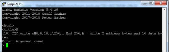

I'm trying to write to a 24LC64 eeprom with Pi-cromite mmbasic on a pi zero w.
I don't clearly see how to specify the address to be written, but in this thread, grogster, et. al., put in the address bytes before the bytes to be written:
Dim A=1 'Address byte
I2C WRITE &B1010000,0,6,A\256,A Mod 256,B,C,D,E 'Write four bytes from address 1
I'm trying to write a 4K+ character file with this code.
' write 24LC64 eeprom
' option i2c 3,5 ' not valid within a program
open "watermon_chart.html.template" for input as 1
dim as string A
dim as integer i = 0, iflag = 0
CONST cFE=chr$(254)
CONST cFF=chr$(255)
i2c open 100,100
do
  A = input$(16,1)
  ? A
  if len(A) <> 16 then
    A = A + cFE + cFE + cFE + cFE + cFE + cFE + cFE + cFE + cFE + cFE + cFE + cFE + cFE + cFE + cFE + cFE
    A = mid$(A,1,16) '  truncate to 16 characters
    iflag = 1
  endif
  i2c write &H50,0,18,i\256,i Mod 256,A ' write 2 address bytes and 16 data bytes
  Pause 10 'make sure EEPROM has time to write(5ms needed)
  i = i + len(A)
  if iflag = 1 then
    exit
  endif
loop
close 1
? i
I'm reading (and writing) 16 bytes at a time, and if the last read is less than 16 bytes, filling in with 0xFE.
The error message on the first write says "Error: Argument count".
(I had to enter "OPTION I2C 3,5" at an MMBASIC ">" prompt to get past an objection that the I2C pins weren't defined--are all pins available with picromite i2c?)
How do I specify an address to be written for the eeprom?
Back to Top View lizby's Profile Search for other posts by lizby

Posted: 12 July 2018 at 5:10pm | IP Logged Copy link to clipboard   Quote matherp
Your syntax is incorrect - check the Micromite manual Appendix B. You can either have a list of single variables or an array/string not both.

Posted: 12 July 2018 at 10:11pm | IP Logged Copy link to clipboard   Quote lizby
Thank you. This worked:
A = chr$(i\256)+chr$(i Mod 256)+A
i2c write &H50,0,18,A ' write 2 address bytes and 16 data bytes
4144 bytes written.
At long last: a convenient way to write bulk data to an 8-pin eeprom.
