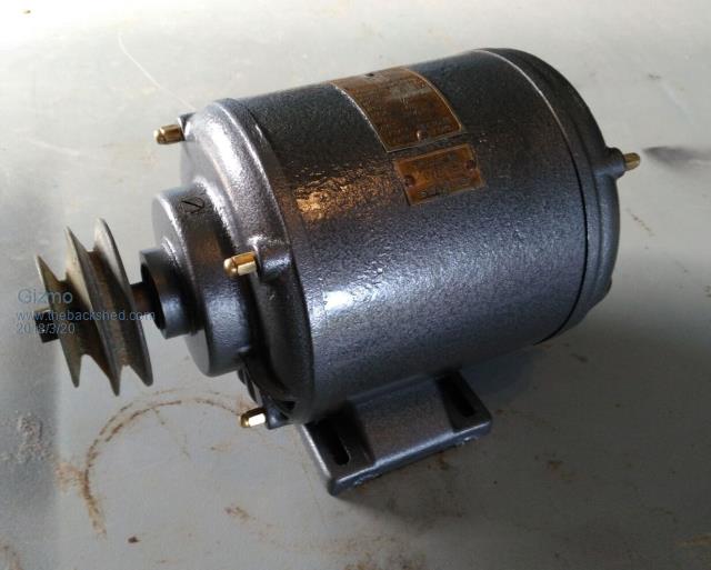

This is the old induction motor.
It's a Crompton Pankinson, Australia made ( back when we made stuff ), 1/2hp 1435rpm motor. This is probably the easiest, most reliable and better looking option for the band saw.
I have 3 DC motors. A 180v 1.25hp 4000rpm, a 130v 2.5hp 6700rpm, and a 220v 3hp 3400rpm.

Check if that motor has a centrifugal start switch or is it capacitor start?
Had one of those motors on the cement mixer and the centrifugal start switch failed at times and would stall the generator, could be a pain.
