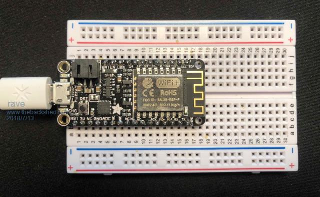

@plover thanks for chiming in!
plover wrote:
I have had this model(s) in my brain for some time, and others too, I agree many or not really "breadboard" friendly, they are not "Legoish" enough.
Agreed. The ones that are breadboard-friendly typically are 512K, for example the Feather ESP8266 from Adafruit, which has 9 GPIO pins, power and serial via USB, 100mA LiPoly charger and still relatively cheap at $17:
Given the trouble with this thing I'm thinking about upgrading to a newer ESP32 with 4MB flash, e.g. https://www.adafruit.com/product/3405 which is a $20 breadboard-friendly feather board or https://www.adafruit.com/product/3269 which is a $15 development board but looks too chunky for breadboard use IMO.
