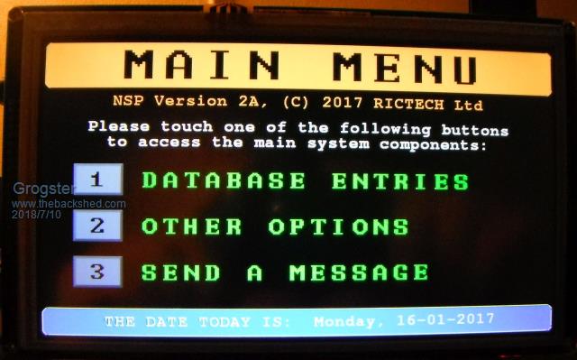

I setup a one-dimensional array to hold the days:
DOW$(0)="Sunday":DOW$(1)="Monday":DOW$(2)="Tuesday":DOW$(3)="Wednesday"
DOW$(4)="Thursday":DOW$(5)="Friday":DOW$(6)="Saturday"
...then a Function to calculate the day reference:
function DayOfWeek(year, month, day)
  a = int((14-month)/12)
  m = month + 12*a - 2
  y = year - a
  DayOfWeek = (day + y + int(y/4)-int(y/100)+int(y/400)+int(31*m/12)) mod 7
end function
...then used a simple SUB to build the date string whenever I needed it:
SUB BUILD_DATE
  YEAR=val(MID$(DATE$,7,4)):MONTH=VAL(MID$(DATE$,4,2)):DAY=val(MID$(DATE$,1,2))
  DOW_DAY$=DOW$(DayOfWeek(YEAR,MONTH,DAY)) + ", " + DATE$
  CtrlVal(MM_DAD)="THE DATE TODAY IS:  "+DOW_DAY$
END SUB
Result:
The formula for DayOfWeek came from someone here on the forums, and I think they got it from the net. I understand it is a reasonably well known formula for calculating the day of the week.
