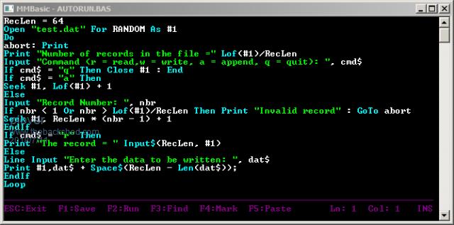

Oh I see further down the page here comes help.
> close 1
> RecLen = 64
> OPEN "test.dat" FOR RANDOM AS #1
Error: No such file or directory
> DO
Error: No matching LOOP
> abort: PRINT
> PRINT "Number of records in the file =" LOF(#1)/RecLen
Number of records in the file = 0
> INPUT "Command (r = read,w = write, a = append, q = quit): ", cmd$
Command (r = read,w = write, a = append, q = quit): IF cmd$ = "q" THEN CLOSE #1
: END
> IF cmd$ = "a" THEN
Error: No matching ENDIF
> SEEK #1, LOF(#1) + 1
> ELSE
> INPUT "Record Number: ", nbr
Record Number: IF nbr < 1 or nbr > LOF(#1)/RecLen THEN PRINT "Invalid record" :
GOTO abort
> SEEK #1, RecLen * (nbr - 1) + 1
Error: Invalid seek position
> ENDIF
> IF cmd$ = "r" THEN
> PRINT "The record = " INPUT$(RecLen, #1)
The record =
> ELSE
> LINE INPUT "Enter the data to be written: ", dat$
Enter the data to be written: PRINT #1,dat$ + SPACE$(RecLen - LEN(dat$));
> ENDIF
> LOOP
Error: LOOP without a matching DO

Most commands CAN be run at the command-prompt in immediate mode, but there are several that CANNOT.
Any multi-line command, such as IF/THEN/ELSE will NOT work at the command prompt, unless the interpreter can evaluate the command in one single line.
The reason you are getting errors, is that when you press ENTER on your IF/THEN experiments, the interpreter IMMEDIATELY attempts to run that line of code. It does not work, as you are missing the rest of the multi-line statements, and the interpreter has nothing to execute after the THEN keyword, so it falls over with the error about no matching ENDIF.
Commands like those ones MUST be run as part of a program code, and they simply can't be run at the command-prompt in immediate mode.
EDIT: Well, technically, you CAN do it by separating out the commands using colons. You are still limited to one line of code, but you can do it along the lines of:
IF X=1 THEN:PRINT "TRUE":ELSE:PRINT "FALSE":ENDIF
That would probably work. Not tested, but it should.
EDIT: Just tried it, yes that does work. You really, REALLY need to be entering in the commands using the built-in editor(type EDIT at the command-prompt), so that you can run the code and experiment around. Typing the commands at the prompt like that is a waste of effort too, as the code you are typing will be totally forgotten once the interpreter has executed that line - so you are typing all that code, to have MMBASIC NOT remember it.

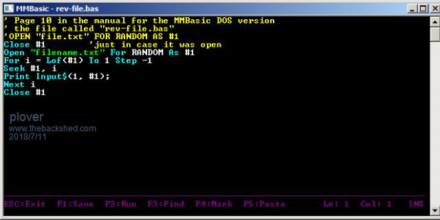

The following code is next in the manual, reading text in file in reverse order
OPEN "file.txt" FOR RANDOM AS #1
FOR i = LOF(#1) TO 1 STEP -1
SEEK #1, i
PRINT INPUT$(1, #1);
NEXT i
CLOSE #1
I can use this to test the file I thought I had made with the Fox and over the fence to the chook house. That exercise ended up with me wondering if there was anything in the file. Named the code file "rev-file.bas" and my code:
' Page 10 in the manual for the MMBasic DOS version
' the file called "rev-file.bas"
'OPEN "file.txt" FOR RANDOM AS #1
'Close #1        'just in case it was open
Open "filename.txt" For RANDOM As #1
For i = Lof(#1) To 1 Step -1
Seek #1, i
Print Input$(1, #1);
Next i
Close #1
To get the code into the MMBasic
To run the program, F2
[4] Close #1        'just in case it was open
Error: File number is not open
Oh, but the filenumber could have been open? How would I know if it is open or not, I tried to outfox the "already open" error. Hmm.
EDIT an make the CLOSE #1 line a comment then use F2 key, that is quick and easy

I have had that open/close issue myself. IE: How do you know it is open or closed at a certain point. The simplest solution that others on the forums suggested to me at the time, was a flag. I used a variable such as FOF(file open flag), and just tested that before doing any closing of the port.
If FOF then
  Close #1
  FOF=0 'Clear flag
Endif
Open "FILENAME.TXT" for RANDOM as #1
FOF=1 'Set flag for next time
This way, as soon as you try to open or close the file, it will first check to find out if the file is already open. If it is, it will close the file first, then re-open it. That kind of thing seems to get around the error that can pop-up when you try to close a file that is not open, or open one that is already opened.
Or you can use ON ERROR SKIP
On Error Skip
Close #1
Back to Top View Geoffg's Profile Search for other posts by Geoffg Visit Geoffg's Homepage
