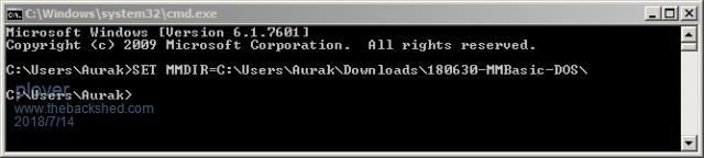

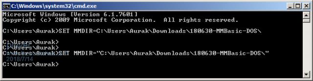

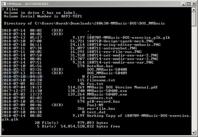

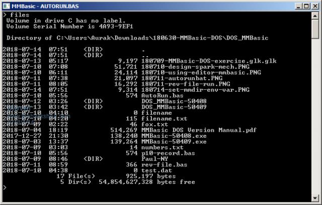

I have moved back to about p.4 in the manual, looking at environment variables, interesting because I am outdone from the start, bit of the manual, split it up abit in my exercise book, the quote from my boo:
Quote:
Environment Variables
Windows environment variables can be used to change some characteristics of MMBasic.
MMDIR can be set to the default directory that MMBasic is to start running in. For example:
SET MMDIR=C:\Temp
will start MMBasic running in the directory C:\Temp. Without this the starting directory will be specified by
the operating system and will vary depending on how MMBasic is started. The directory path must be quoted
if it includes spaces. eg: SET MMDIR="C:\Program Files"
Following path line is where I have my running mmbasic.exe located and files as created etc. Presently this is where mmbasix.exe will run in that location.
SET MMDIR=C:\Users\Aurak\Downloads\180630-MMBasic-DOS\DOS_MMBasic\
So the test, I am going to try and get MMBasic to run in the parent directory, or one level back up the chain. As I understand done by setting env variable:
Done, then I check in the MMBasic terminal window with the "files" statement:
The files showing tells me that is the original location I started in tonight, but I expected to see the file in the parent directory??
I think I did restart, MMBasic from original location again, after I had caried out the SET MMDIR=... but at the same time I happened to read agin that the path should be quoated,@#$%, i have to repeat quotes
SET MMDIR="C:\Users\Aurak\Downloads\180630-MMBasic-DOS\"
Actually tried to put red colours around the " mark, that is no go.
SET path including the quotes. Then the make sure I had closed the MMBasic terminal window I then started it up again. Do the "files" test:
What, the same result??
Well making great progress here going backwards it seems. This is the way to learn I know but one does get a weeny bit tempted skip these basic things perhaps.
As this is run under windows 764 I am qurious where can I check the ENV list settings, in Linux with a bit of luck I can run a long list and actually see what the values are that are assigned.
Has MMDIR been assigned a value? I was hoping that running the "files" in the MMBasic terminal would have shown the parent directory (notice the "files" run result does show a path line.
Somebody drag me out the quicksand before it is too late.
Edited by plover on 14 July 2018 at 11:53pm

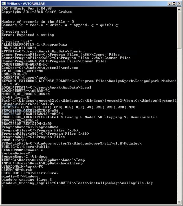

Posted: 15 July 2018 at 10:41am | IP Logged Quote flip
Hi plover,
Out of interest are you setting the MMDIR globally?
One way to check from within MM environment typing 2 commands in bold as follows:
DOS MMBasic Ver 5.04.09
Copyright 2011-2018 Geoff Graham
system "set"
ALLUSERSPROFILE=C:\ProgramData
APPDATA=C:\Users\phil\AppData\Roaming
mmdir=C:\users\phil"
windir=C:\WINDOWS
files
 Volume in drive C is Windows
 Volume Serial Number is 764F-B060
 Directory of C:\Users\phil
From above you can see even though quotes not required (and are mangled by Windows) the behaviour is OK
If you can't see MMDIR then need to set it in same session as you run MMBASIC, OR set it using Admin settings.
Start...Right-Click on My Computer...Properties...Advanced System Settings...Environment Variables..and add it there.
This is probably the best way if you want it permanently set to the same folder. I don't use this personally as I find it too restrictive, but that's just me.
Aside from this, I can see you have AUTORUN.BAS in the directory. it may be that there are some commands in here that are changing your current directory which might be overriding any environment variable.(I am not 100% sure on this as it may dependent how you are starting MMBASIC...but if ENV setting MMDIR wasn't your problem, you could try temporarily renaming AUTORUN.BAS to something else and try it)
Phil

Posted: 15 July 2018 at 12:24pm | IP Logged Quote plover
flip
Wooww, better than I hoped for, the list of env variables.
I am going to attach terminal picture, but I see my thinking about how to verify if MMDIR was set, was good idea. From the list it is not set.
My thought was setting the env in a Windows terminal that might make it Global, obviously that has failed and as I accidentally also set it in root/admin terminal this did not do the trick either (nothing showing).
Your pathway to set the env variable, seems like hard work and it does not appeal to me as I will have forgotten in 3 days how I got there but might remember it was described here. Assume I will find out later if and what may be needed.
Add to this I don't know if I need to use it, not clear to me. I am just at the moment battling my way through the manual hoping something will stick in my head.
So locally you SET in MMBasic, and globally you take the tourist path via Windows. Then to check back into MMBasic and run the "system "SET"" and files.
