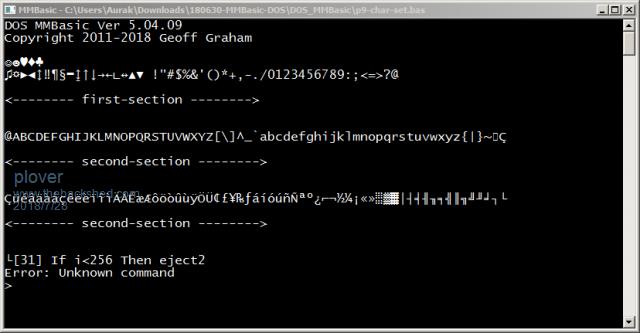

I don't think MMBASIC does that. The channel is left open till the program explicitly closes it. Perhaps that is something worthy of change. Geoff?
