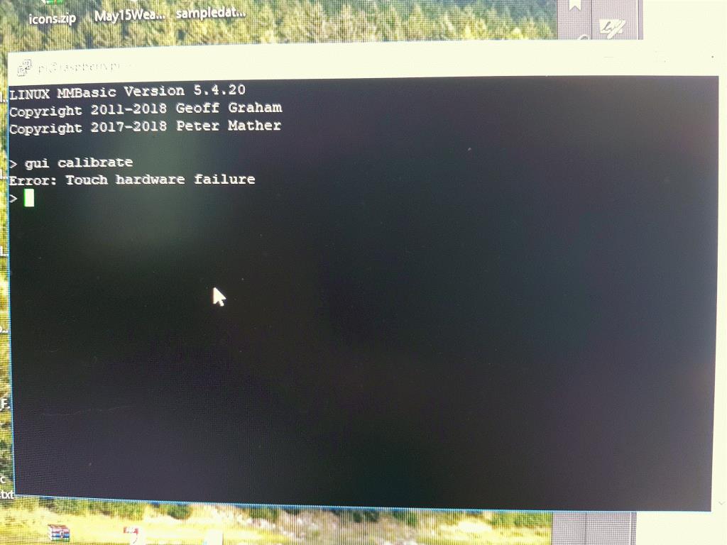

I "think" I've found a bug with the Picromite, it "may" be an error with my soldering but I don't think so
When I attach an SSD1963 display (7 inch) it works ok other than the touch will not calibrate
I thought I'd messed the display up when I tried to move the jumper for the backlight so I bought 2 new ones and both of them are doing the same thing.
I was about give up and get another display when I suddenly had the idea to try calibrating it with my Explore 100 board and it calibrates perfectly with no errors.
This is the error - it appears after touching the 2nd touch point in the calibrate routine

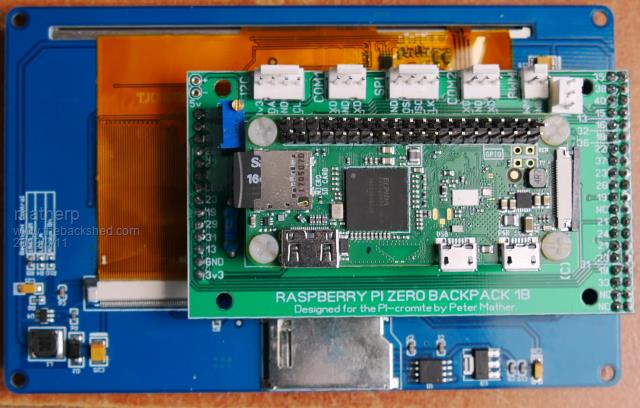

Just tested 5.4.20 on a Pi-Zero and it works fine. I'm using Grogster's backpack to connect the display:
Option lcdpanel SSD1963_5,l,,36
Option touch 26,24
Will include the new controls when Geoff releases the source at the end of the beta period
Check SPI wiring:
T-DIN - 19
T-DOUT - 21
T-CLK - 23
Edited by matherp on 09 August 2018 at 9:54pm

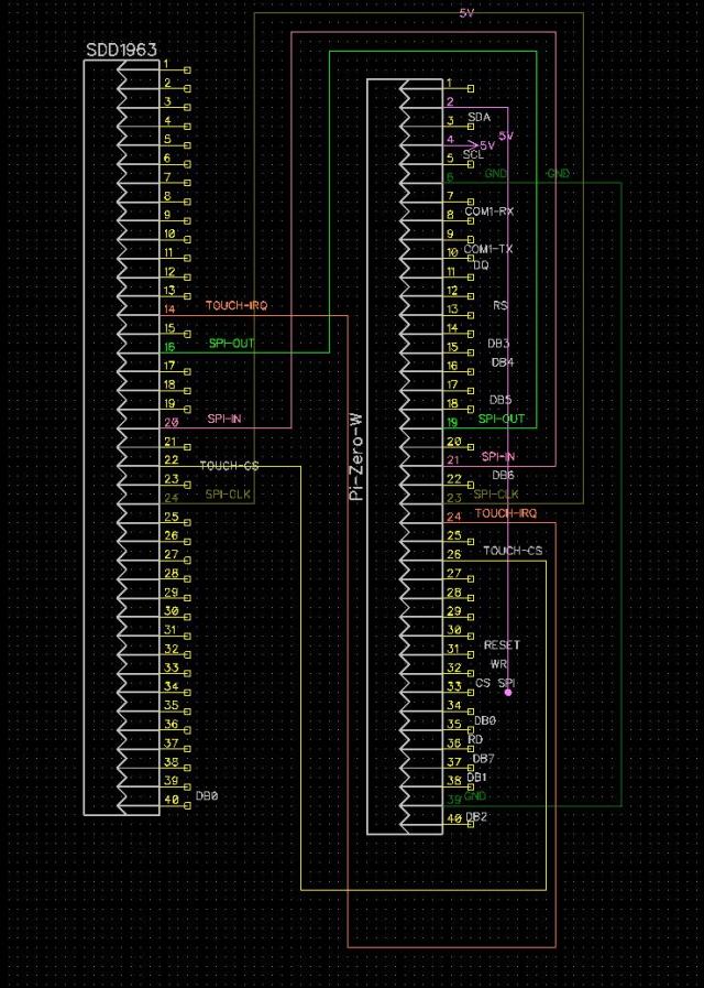

I just redownloaded 5.4.20 in case I was using an older version and reinstalled it
Deleted the Options file
and when I go to calibrate the touch I still get the same error
This is the relevant part of the circuit and I'm pretty sure it's correct
Back to Top View lew247's Profile Search for other posts by lew247
Joined: 11 December 2012
Online Status: Offline
Posts: 2634
Posted: 10 August 2018 at 11:14pm | IP Logged Quote matherp
16 is T_DO which should be connected to SPI_IN
20 is T_DIN which should be connected to SPI_OUT
Back to Top View matherp's Profile Search for other posts by matherp

Posted: 11 August 2018 at 12:49am | IP Logged Quote lew247
According to the manual
21 DIGITAL_IN DIGITAL_OUT SPI-IN
19 DIGITAL_IN DIGITAL_OUT SPI-OUT
On the SSD1963
pin 16 T_DO is connected to pin 19 on the Picromite
pin 20 T_DIN is connected to pin 21 on the Picromite
so it should be working
If it was right it would be working
T_DO (pin 16 of the SSD1963 in your diagram) is the output of the touch controller it connects to SPI-IN
T_DIN (pin 20 of the SSD1963 in your diagram) is the input to the touch controller it connects to SPI-OUT
Your diagram above is incorrect - the signals are swapped. Check Grogster's PCB which is correct
