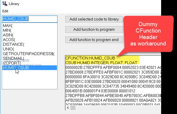

disco4now
Joined: 18 December 2014
Online Status: Offline
Posts: 343
Posted: 16 April 2018 at 7:48am | IP Logged Copy link to clipboard   Quote disco4now
Hi Jim,
A small one if you are doing any update in future.
The library does not index CSUBs that it contains. I think they add in OK, just not listed. My workaround is a dummy CFUNCTION header.
Its handy to have HUMID etc now they are CSUBs.
Gerry
Back to Top View disco4now's Profile Search for other posts by disco4now
Avatar
Joined: 07 August 2011
Posts: 2963
Posted: 16 April 2018 at 9:13am | IP Logged Copy link to clipboard   Quote TassyJim
Gerry
I will have a look at it but it will be a few weeks before I can put out any opdates.
