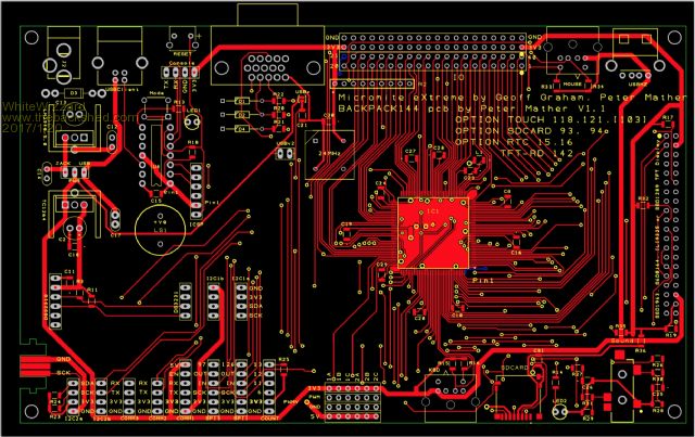

Here is a graphic for the Top layer & Silkscreen,
Working clockwise around the edge of the PCB (from Top Left corner):
- Power input socket
- USB Client (Type B) communication socket (and Power option)
- Reset switch
- VGA output socket
- I/O Connector (Digital/Analogue) + Power connector for external 'stuff'
- PS2 Mouse socket
- USB Host socket (for future use!)
- 40-way TFT connector (SSD1963, S6D0164, ILI9325, SSD1289)
- 3.5mm Stereo jack socket (WAV & tone output - line level)
- HeartBeat LED (think of this as a flashing Power LED - It can be disabled (turned off))
- uSD Card socket
- PS2 Keyboard socket
- PWM connection headers
- COUNT connection headers
- SPI1
- SPI3
- COM 1
- COM 2
- COM 3
- I2C2 (x2 headers)
- Nunchuck edge-connector
- DS3231 Socket
- Power selector jumper (between the two heatsinks/vRegs) to select Power source (Power Jack, or, USB)
Other points to note:
- Towards the upper left corner is the PIC1454/5 USB-to-UART circuit complete with 'Mode' button, and 'Mode LED'
- I2C1 (x2 headers) are to the right of the RTC (and above the two SPI headers)
- On board buzzer (above RTC)
- Heavy duty vRegs complete with mechanical heatsinks
- Console connection (should you need it!) to the left of the VGA socket
- ICSP header to the right of the buzzer / PIC1454/5
Mounting holes are located for direct mounting onto a 7" TFT (tested with SSD)

Posted: 20 January 2017 at 11:08am | IP Logged Quote Zonker
Wow.. Nice layout...
So, the RTC uses the same module as the E-100 board.. I did order 2 of them... I think I see some tracks going to the other side.. Are you using the memory IC part of the RTC module..?
Thanks Gent's..! This is ant awesome design project
MMX..! Sweet..!!
